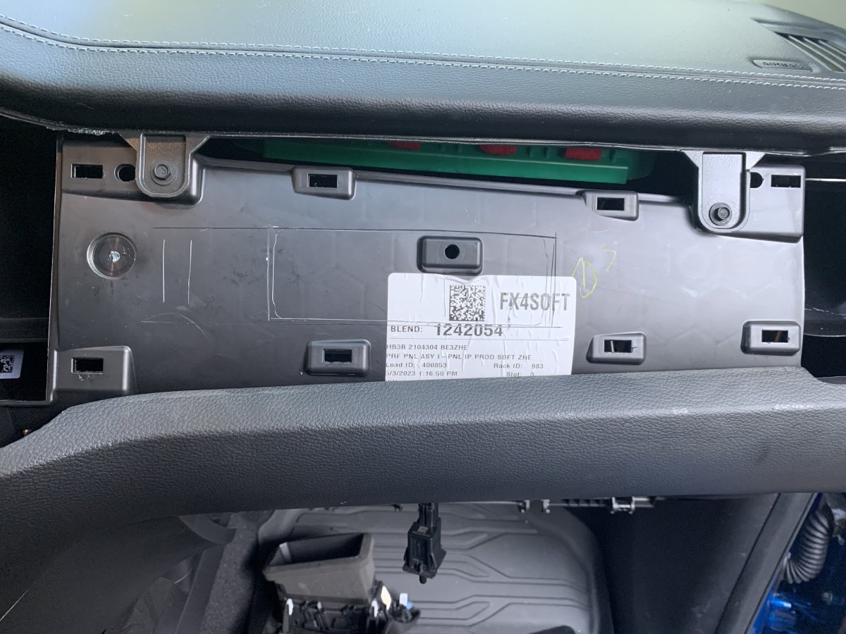

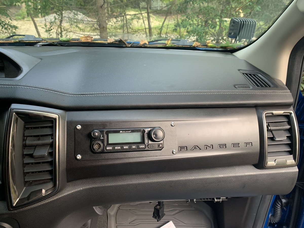

It fits:
Snoranger’s 2023 Ranger Lariat Tremor
I haven’t finished the install, so I won’t go into details. But my idea worked.
Great use of otherwise dead space.
I assume then, that’s not where the airbag is.
Airbag?!?! I don’t sit on the passenger side!!!

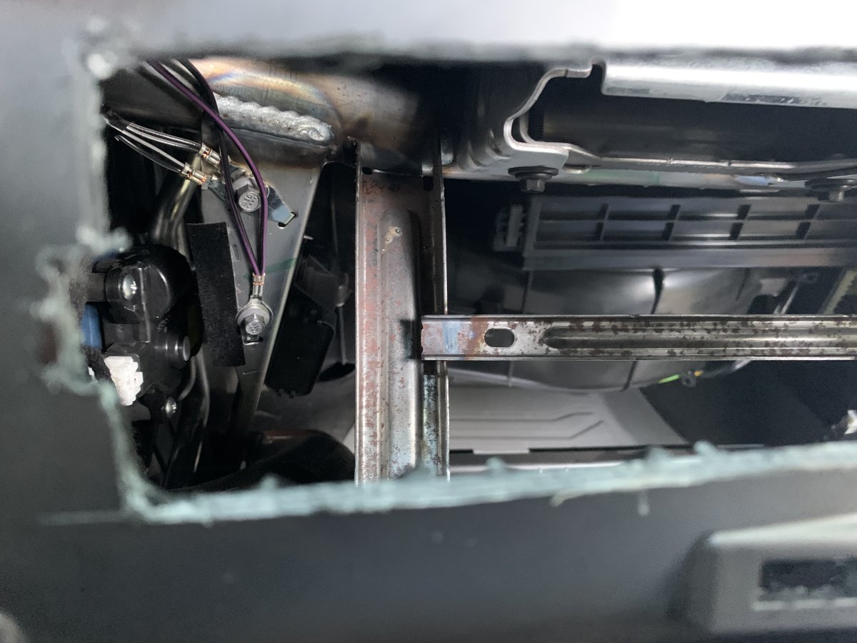

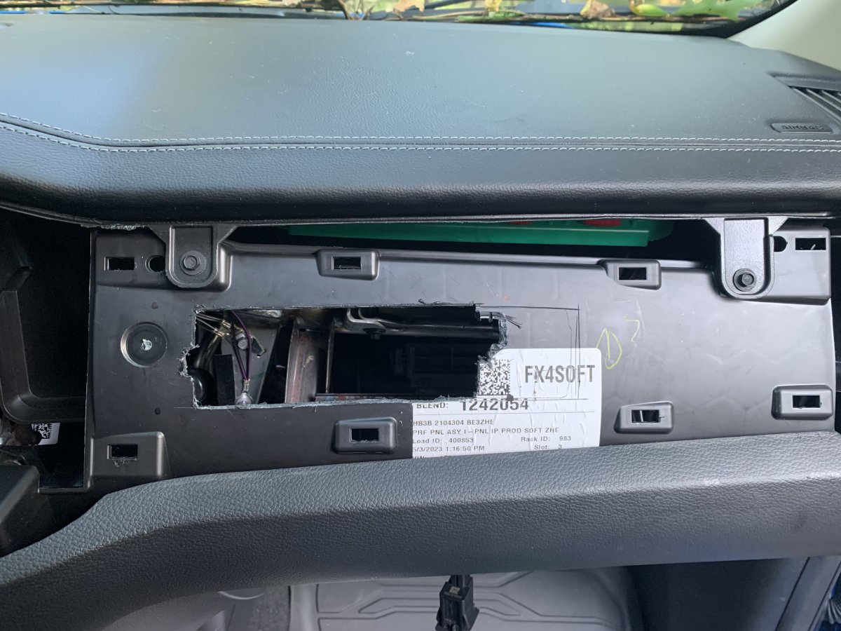

Is it open behind that whole panel?
Not completely. There’s another panel behind that trim piece that had to be cut. Then there’s some brackets about 6” in you could modify and get a LOT of room.

That’s a lot of space in there. I’m surprised they don’t have any little cubbies in the dash they did in the 90s full size trucks.
There’s a huge amount of wasted space. With a slight redesign, they could have doubled the size of the glove compartment. I kinda think they did it on purpose… it’s cheaper to build simple shapes without extra storage compartments.
