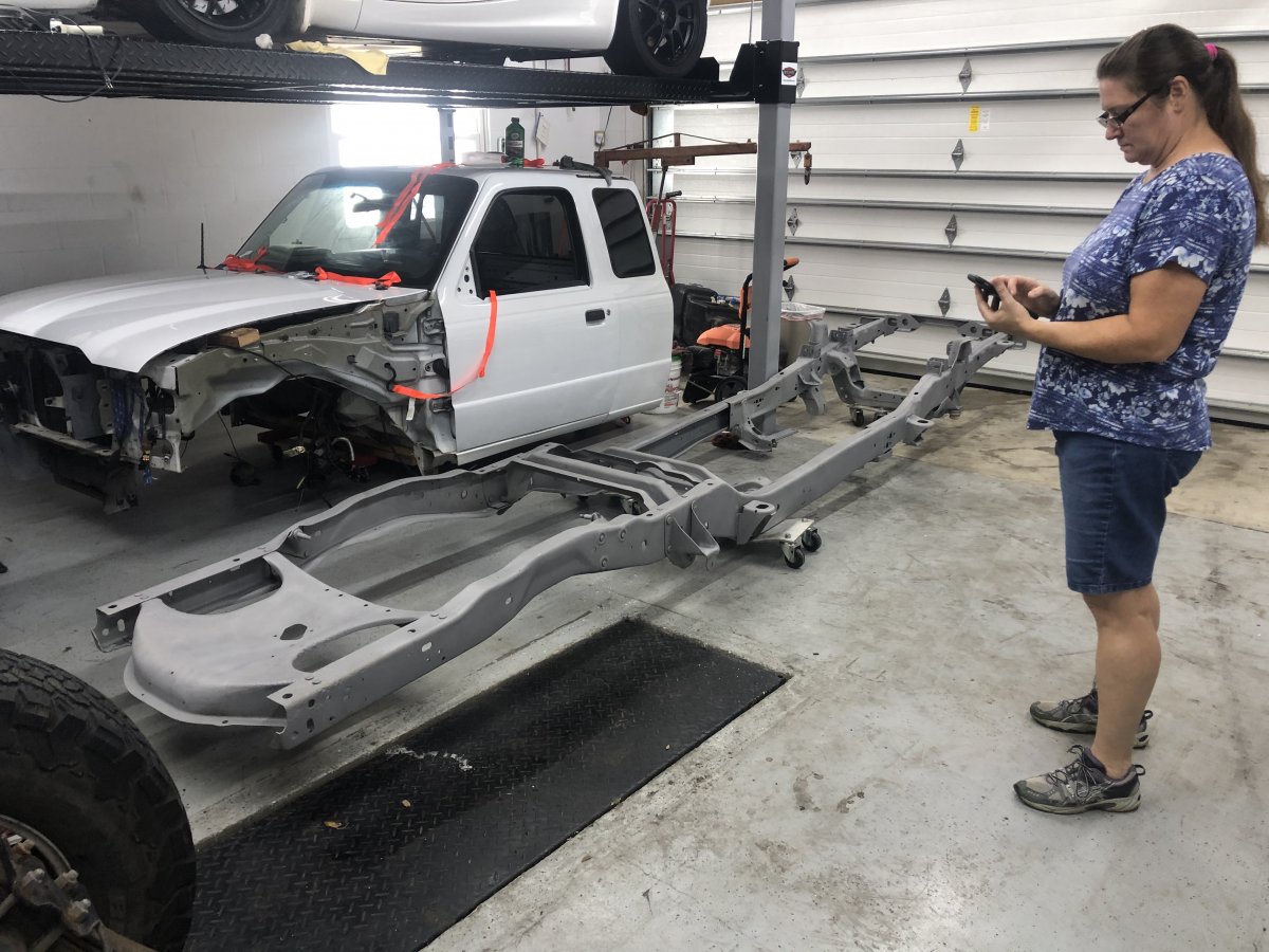

Hi all,
I purchased a 2004 4.0 manual 4x4 with no power options and did a restoration down to bare frame. While in pieces I went to the salvage yard and picked up a wire harness and smart junction box with power options. Apparently the smart junction box has some issues, passenger unlock button works for driver side but not passenger. If someone hear could supply a vin number for this model year and options or the correct smart junction box part number I would appreciate it. 4L5T-14B476-AH came in the 4x4 with no power windows/locks/mirrors. a 4L5Z-15604-EB is what ford says is the replacement. A 4L5Z-15604-FB
Kit - Alarm/Keyless Lock System is still available from ford. Help Happily appreciated!
