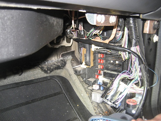

Looks like I'm having issues finding the correct plug/wire for this door trigger. It's supposed to be a green/purple wire, in a 32-pin black plug, pin 6. There are two green/purple wires in the box. One in a gray plug that seems to be a full time ground, and one in a black plug that seems to be a very thin wire, and is nowhere near what should be pin position 6. If anybody's been through this, or has suggestions how I should proceed, please chime in.

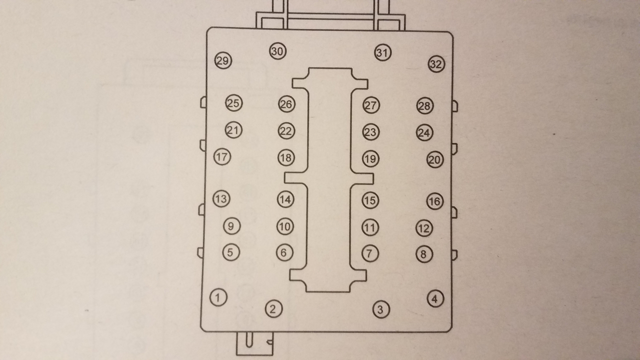

Dunno if you have the pinouts as they are numbered. If not hope this helps.
The door switch circuit should be a ground. When the door is open it should show grounded, when door closed it should be open loop. (I think!) Im not a electrical expert but thats how door jamb switches generally function.
My diagram shows #6 pin door ajar on the black connector, 20 guage wire, green and violet.
