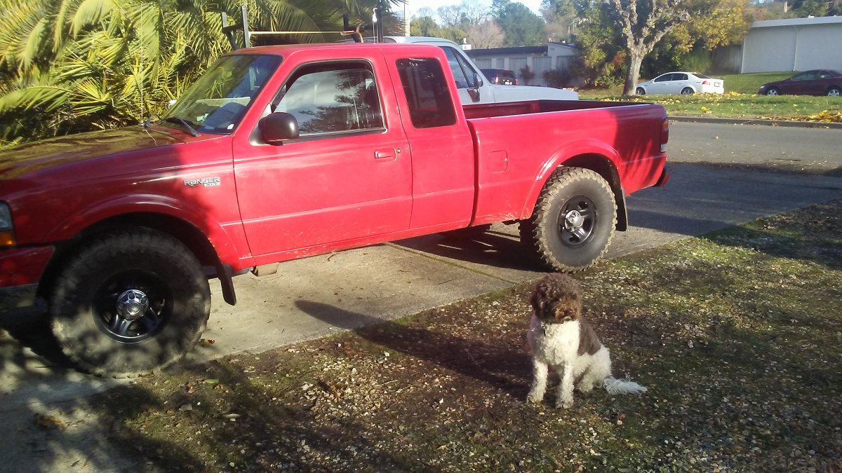

Nice truck, cool dog :D

And its a PERFECT Ranger, RED, and a nice dog as well :)

Thanks guys. Buddy the dog says thanks too.

I've definitely been honeymooning with the Ranger. The paint is surprisingly perfect for it's age, I even waxed it. Here it is clean. At the time I wasn't sure I wanted a manual trans but it has grown on me. Also didn't know it was the last of the OHV 4.0, didn't even know they went to OHC. That's OK too, I don't need any more power than it has, as long as it stays reliable.
