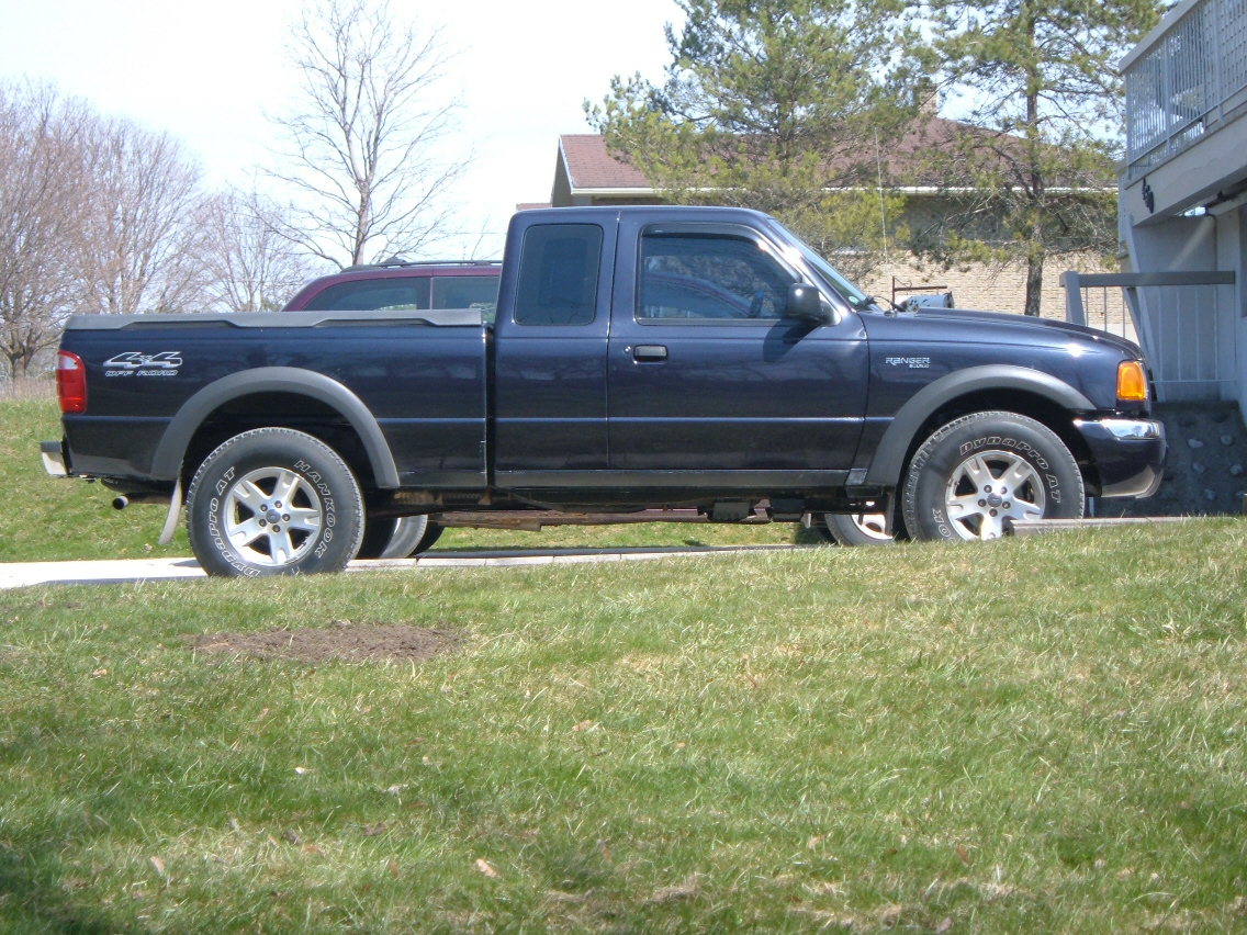

I love my 2002 Ranger :yahoo: I would like to put a 3" body lift on it; will that be enough to put 33s under it? Picture to email.jpg
Yea it will work fine. I had a 1999 with a 3 inch body lift and 33x12.50x16. The only problem was that the front tires rubbed a little.
my 1993 ford ranger that i just got, 3 inch body lift with 31's
Thanks for the info. I have 265x75x16s on it now and the front was rubbing until I gained 1 1/2" by adjusting the torson bars. On the back C.T. had a shacle lift kit for $20 and gained 2-3".
