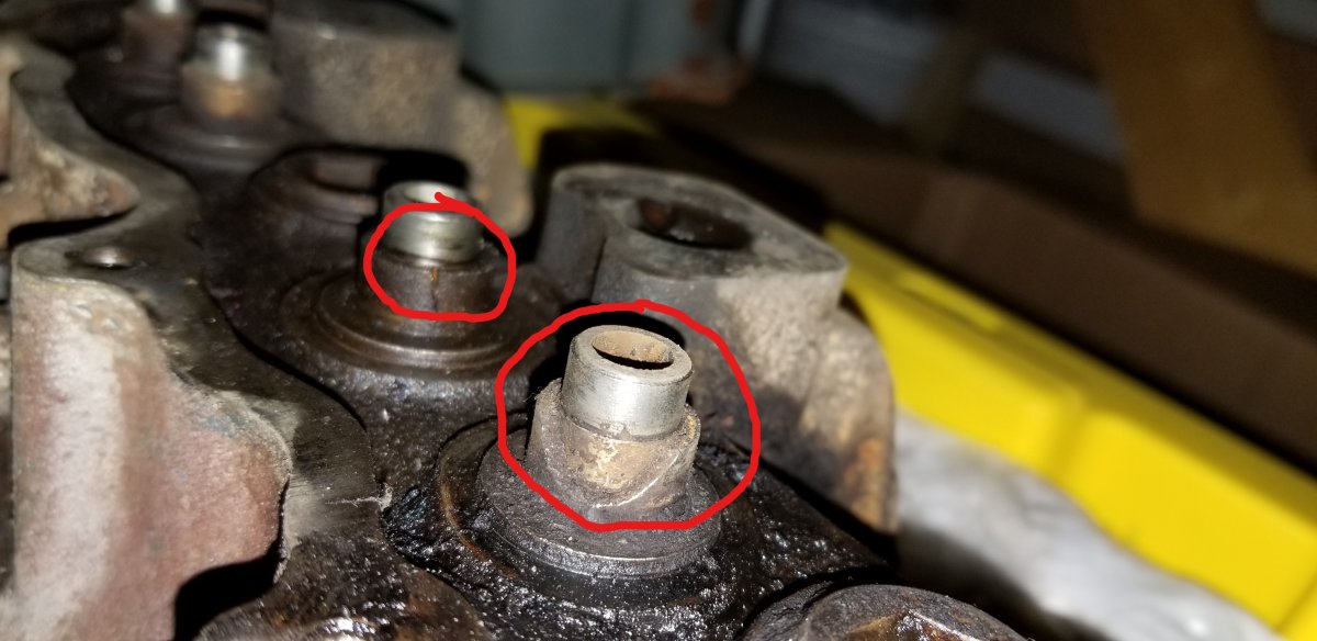

I picked up a set of 89TM cylinder heads at the junkyard last year.
I just got around to tearing them down and inspecting them today.
They were sludged up pretty bad, and when I pulled out the springs and valves I noticed this.
Is this something I can get a machine shop to replace?
I couldn't find anything on Rock Auto or Summit for valve spring seats. Unless they go by a different name.

Those are the valve guide bosses... which I believe are part of the head casting.

Valve guide bosses... part of head casting... and they're broke. I would venture to say those heads have been serviced once and got a couple new valve guides. I've seen others crack like that when installing valve guides. You typically heat the head and freeze the guide and installation goes fairly easy. If the head wasn't warm enough... the interference fit of the guide cracks the boss while driving it home. The boss does two things... help retain the guide... and set the depth for how far to install the guide.
You would be wise to stop by a machine shop and ask someone that deals with these things... and see what they say.
Itll pry cost you more to fix then another set of 89tm heads.
Yea they apear to have a zillion miles on them and have obvious damage that cannot be repaired. They could probably run ok with those chunks of the casting broken off but A. There's probably more damage you haven't found yet and B. Why bother putting money into them, cut your losses and buy another set.
Sounds good. I'll give my machine shop a call Monday and see what they say.
Considering how cheap they are, it would make more sense to get a new set, but the late model 2.9s are getting pretty rare in my area. Most of the ones I tore into at pick n pull had early heads. It took me a decent while just to find these ones.
That's why I suggested taking them into a machine shop... see what they have to say.
On VW heads... I've run heads that had broken bosses. There was sufficient material below the boss to retain the guide. In most cases... I would machine the bosses thin to install dual valve springs... if you serviced the guide after that... the thin boss would crack 99% of the time. It would be left there as depth control.
