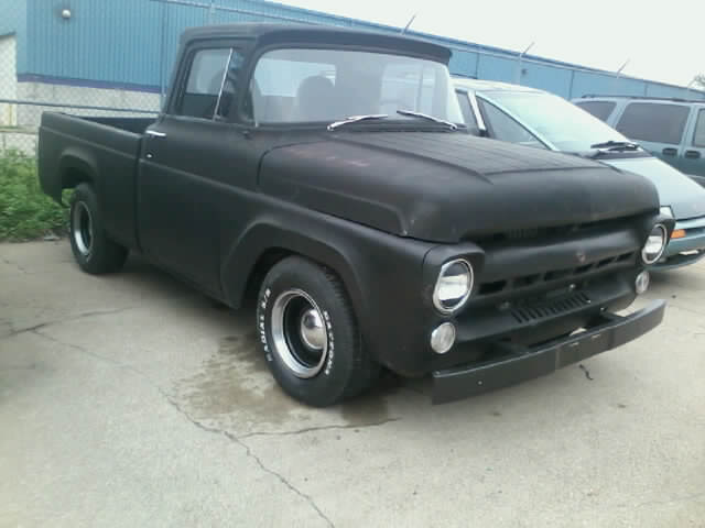

This is my '57 ford F-100 pickup. It was originally my fathers, he traded my mothers snowmobile for it in 1995. it was flat towed home behind an 88' BroncoII with the fenders, hood and other junk in the bed. Today it's got a 351W out of a '78 econoline van and a C6 trans, hoping to switch to a manual if i can find a good deal on one. The front suspension is wooped from years of driving with a few leafs taken out. i've been trying to figure out how to drop it another 2inches in the front while improving ride quality. i'll also be doing some lighting alterations and new seats. currently 2 buckets from a 94 explorer but looking for a split bench type of setup. the interior, or lack of it will be getting some TLC and hopefully a good shot of paint.

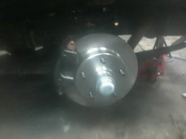

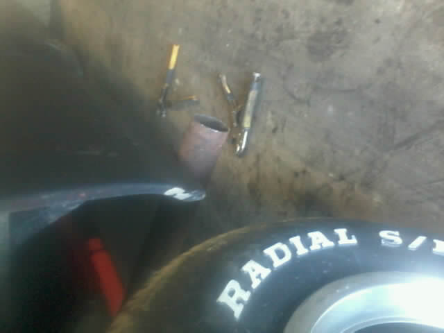

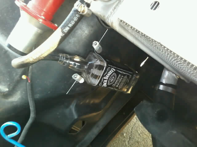

got the brakes on over the weekend, took a bit longer than i thought. wasn't exactly bolt on lol. had to press out the bearing races in the rotors, grind off a part of the calipers and the driver side rotor rubbed a bit so there was more grinding there. i'll try to post some pics here soon. i've got an idea for a new battery box.
heres some crappy pics of some of the things I've done. i'm having trouble getting the pictures off my phone to my email.
