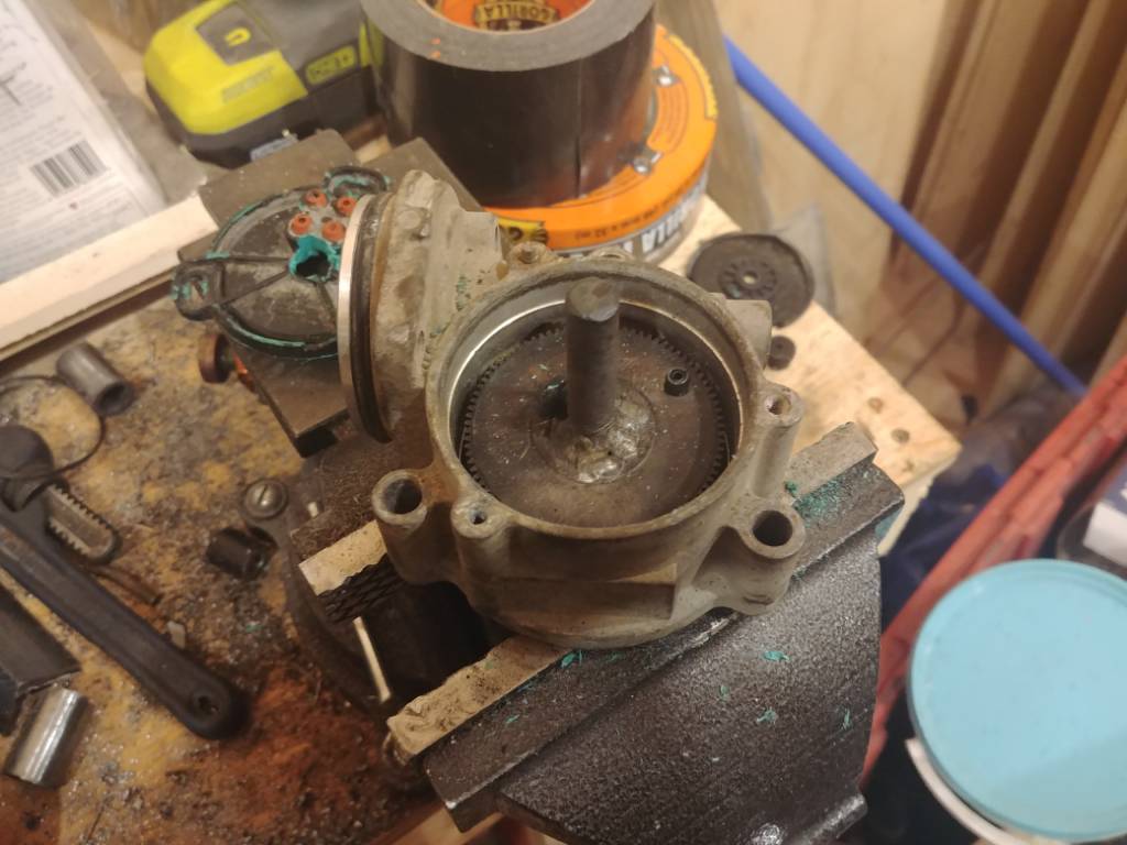

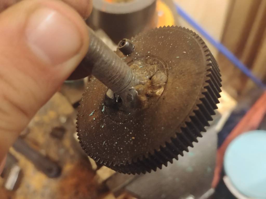

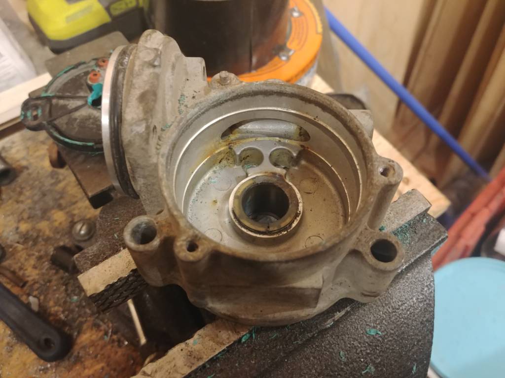

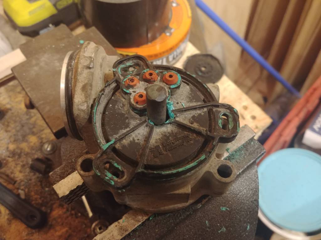

We drilled a set screw hole in the gear hub from a bad shift motor, it will work as a large knob, the teeth on the gear can work as indexing. but that's as far as we got for now, it's sitting on the bench until spring I guess.
I mean I guess I could use one of my shift motors for parts to make my own

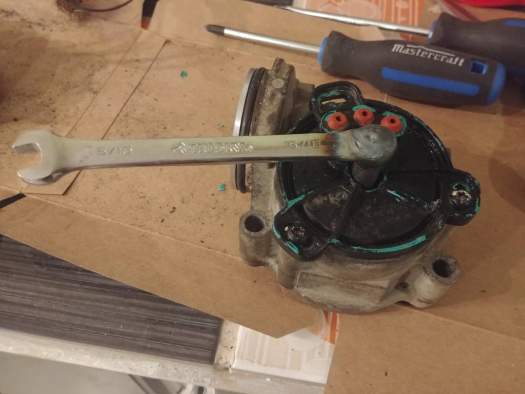

So I rednecked up a manual shifter, still a few things left to finish it up. But its at the stage of functioning lol. Git er done lmao.
500 mile update, working like a charm. Have been through some pretty deep snow and havent had any issues with 4x4 now that I can shift it manually.
