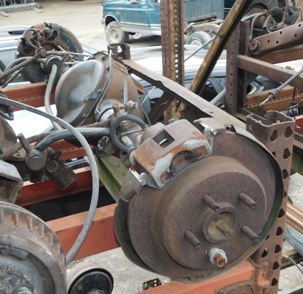

It's a tough decision Found an Explorer rear with my ratio (3.27) near local $350.
Can't find any under $300. Drums, shaft, bearings, shoes on mine will be close if not more.. Yes I know the new old would need pads and rotors etc. But they are a stronger rear.
