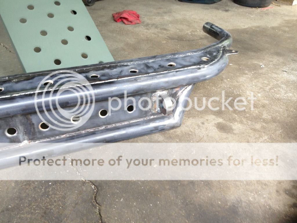

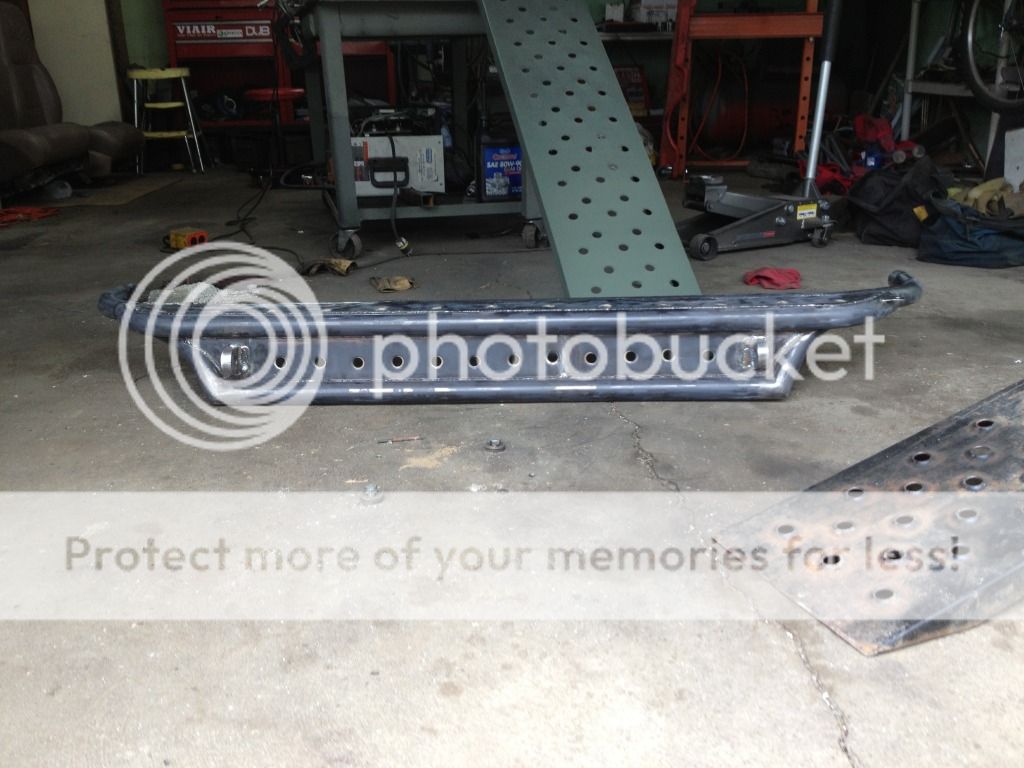

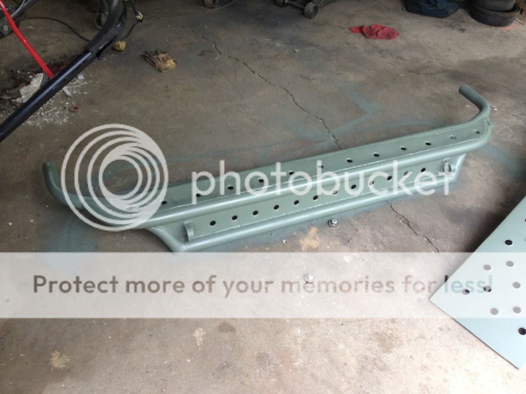

Also worked on the bumper a little more since I didn't have the gasket for the rear.
I mounted a light tab and a pair of tube ends from Barnes. The light tab I used to mount the CB antenna. It looks to be right in harms way, so I am thinking of using a little scrap tube to add a little protection. I really don't have anywhere on the exterior to add it that gets it out of harms way since I don't have a tire carrier and the rear gate opens out.
I didn't fully weld the ends in, but will do that when I mount the D-ring mounts since I have to pull the bumper to do that anyway.
PS. I know my welds are boogery. Still trying to get this welder adjusted right (as if my welds would be any better)

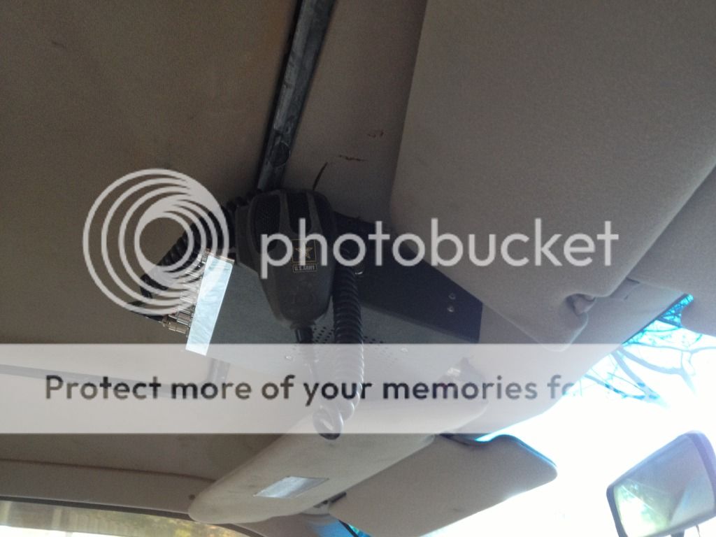

Lately I have been tinkering with Ex fixing all the little issues that were bugging me. 1st was the CB location. When Dan had it, he had an external speaker for the CB that came with Ex. Well, I broke the old CB and the old speaker. It was originally mounted on the floor. When I pulled out all the carpet, I never put the CB back in, as I didn't want it on the floor anymore. Well, this past weekend, I put it where I mounted D's. On the roof.
The Rangers have a brace that runs between the headliner and the outer roof skin. Ex didn't have that. I don't know if it was because of the sunroof, but I knew that this was going to require me to go through the outer skin.
There is also a gap of probably 2-2.5" of air between the headliner and the outer skin. Because of this, I couldn't mount the CB mount directly to the roof without modifying it. I plan to use this CB again in D when I get him back, so I didn't want to modify the mount.
A couple of long screws, a pair of old castle nuts from the factory tie-rod ends, and I had the spacing I needed. I extended the wiring, added a blade style fuse instead of the cylinder-type, and tucked everything behind the factory panels.

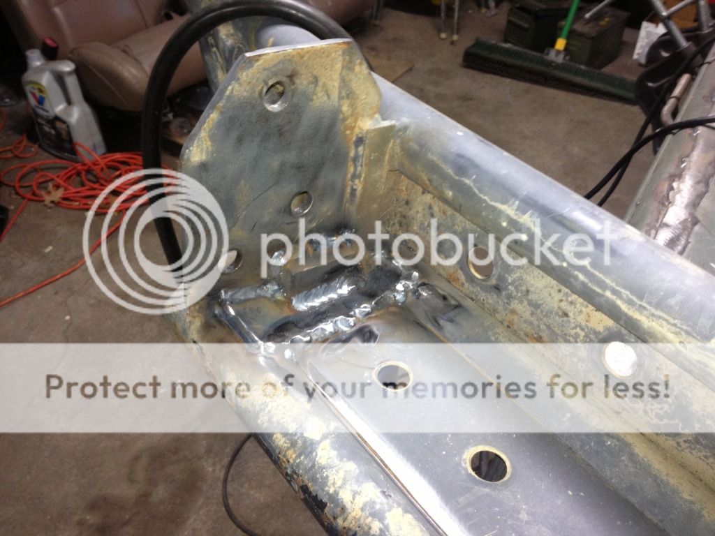

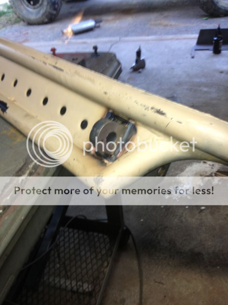

I have also needed to install my D-Ring mounts to the rear bumper I built. The front panel needed to be cut out as they go through the metal and are welded to the bumper mounting brackets. I couldn't get my grinder in there, so I packed it up, and headed to my dad's shop. Using his plasma, I cut out the windows needed, then headed back to my place to mount everything up.
I ran out of welding wire, so I will pick some up today after work then get these finished up.
On the backside, I took another piece of 1/8" plate and "formed" it around the mount, as I don't trust just one side.
Not the best, but I think it should hold. The Dring mounts were from Barnes4x4. I really wish they were a little longer (story of my life), but I bought them, so I was going to install them.

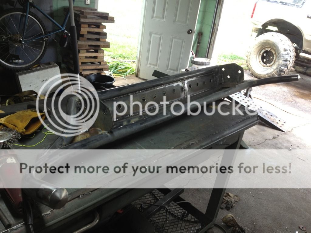

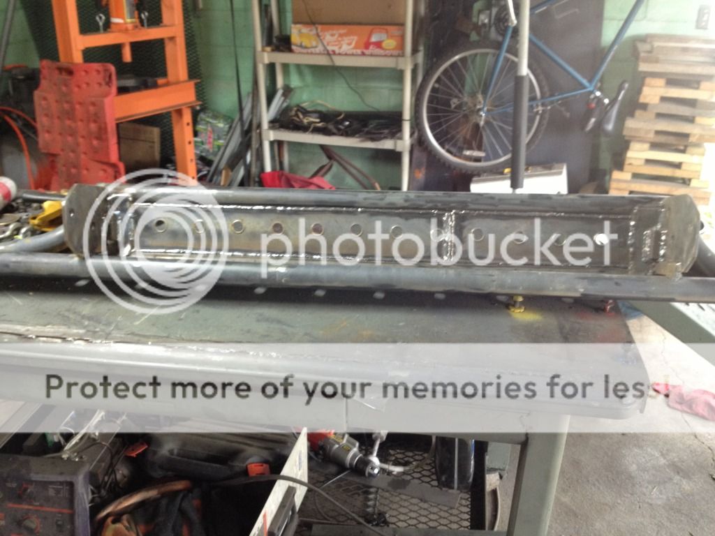

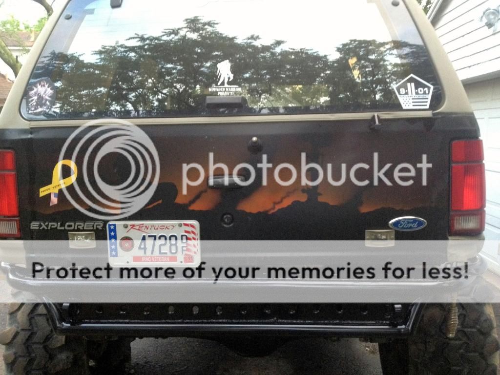

Finished up the back bumper this weekend.
Finish welding everything in on the backside, then cleaned up my welds a bit
You can see where the dimple-died panel is 2 pieces. Also wrapped 1/8" plate around the D-ring mounts. Hopefully they will not rip off
It isn't perfect, but I have about 30 bucks in it, not including welding wire/gas. Hopefully my next one will look a little better. It fits really well, but not the prettiest
I didn't get a picture in paint, as it wasn't dry yet. Went with black to match the front rather than tan
I think it looks good. Should work well thats all it needs to do

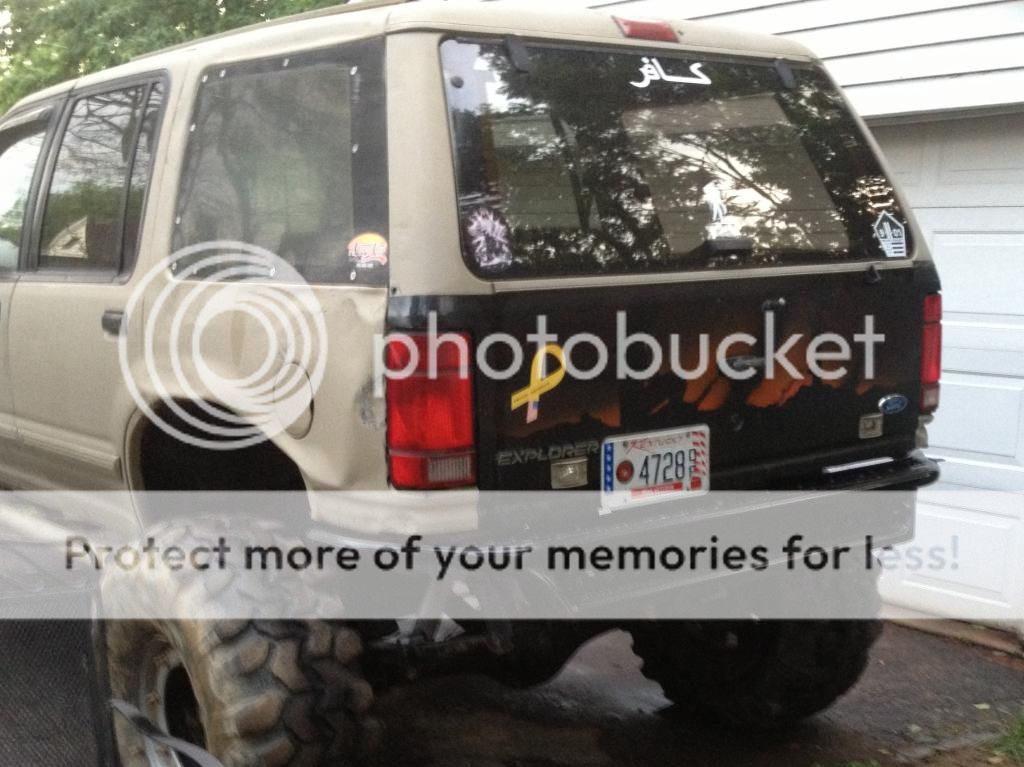

finally bolted the bumper back on. Looks crook-ed, but its just the picture.
