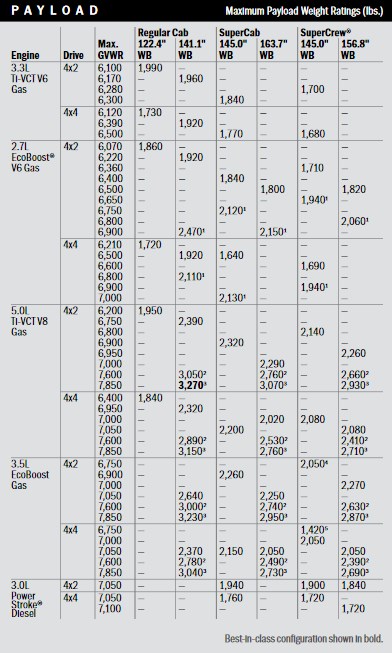

Ive been looking at XL/XLT ext cab 5.0 4wd 8ft beds and seen most float in around 2200lbs. Guessing a regular or extended cab without max payload is close to the crew with?
Here’s the chart for an ‘18 F150.
