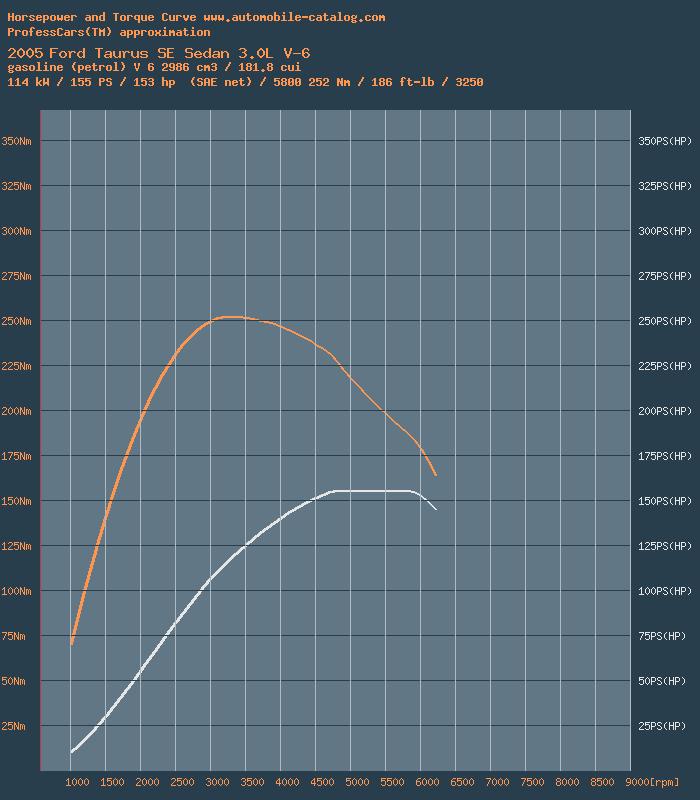

More words have been wasted on trying to define the difference between torque and horsepower on automotive forums than anything else. In fact they are slightly different representations of exactly the same thing - power. This is because when one talks of engine torque, it's not static torque but torque at an rpm, and that's the definition of power. I can convert a plot of torque to one of horsepower (or the other way) with no additional information. It's easier to measure torque on a dyno, so the torque plot is just an intermediate step to getting a horsepower plot, which is what actually matters.
Horsepower is the rate of energy transfer, which is what does work, so that plot shows you directly what the engine can do. Looking at the torque plot is just a harder to interpret version of the same info, which tends to fool people about what the engine can actually do.
The 3.0 has a very normal power curve with a predictable rise, as shown in the white curve (this is a 2004 Taurus version, and they vary a bit by year and manifold design). If the power peak is at a higher rpm than desired for a given road speed, gears will fix that.
