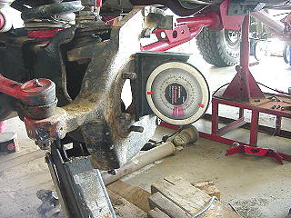

They way I'm doing it is pretty simple. The axle sits on jackstands at near static ride height, using an angle finder you can set the caster of the axle. The truck/chassis should be at near ride height just for simplification. From that point, you can take more accurate measurements if you need to for recalculation, or validation and initial fabrication/tacking things in place.

This is exactly what I did. Set the truck as close I as I could get to static ride height. Had the axle set underneath on jackstands with an angle finder placed on the top flat part of the inner-C. Rotated the axle backwards till I reached 7 degrees, double checked all my measurements and buzzed the wedges in place.

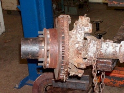

you then check the axle with an angle finder.....like this....
The part I am confused with is where to do the measuring from. If I put a straightedge across the pig's cover mounting surface and put the anglefinder against the straightedge, would this work? Or do you do it out at the knuckle on the spindle studs like this picture from the tech library?
The method shown in the above pic seems like it could work, so long as the studs you set the piece of flat stock on were EXACTALY at a 90 degree angle as opposed to the steering axis, (a.k.a. the centerlines of the balljoints on the axle.....).....but is this the correct method for doing this with the axle I have is the question?

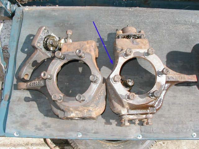

D60 Kingpin knuckles (disregard the arrow):
I would use the mating surface of the kingpin cap, or the steering arm as your "datum". It is angled inward (See below), but should not affect your measurement
Your differential cover sealing face is really irrelevant in this. The caster angle is much more important than your u-joint angle. In all reality, it's not likely that your ujoint angle would be off by much, your caster is the main culprit behind death wobble. (with the exception of worn out kingpins or bushings)

The only pic of mine I have handy. The angle finder is just behind the balljoint on the inner-c. Obviously it's not at static ride height in this photo, just for reference.

And by the way, that pic makes this a lot easier to understand.....
Anyone know off the top of their head if this method shown in the picture works for a Dana 60 as well?
