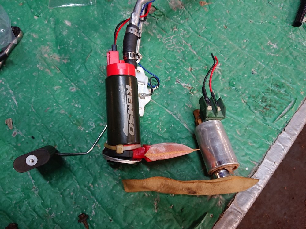

So, there are options for this.
My 88 was converted to a single in tank pump only. Granted, my 2.9 is highly modified. However, a Kemso 340 LPH pump (eBay) does fit in the plumbing for your in tank pump.
Installing the bigger pump has pros and cons. They are relatively cheap ($35 IIRC), will supply more fuel than a naturally aspirated 2.9 will ever need, and removes a second failure point from your vehicle (two pumps reduced to one). The drawbacks are that they are somewhat loud (I hear mine over my headers/Flowmaster/3"intake, etc), and requires the complete removal of the frame pump. The frame pump is replaced by a standard Ranger fuel filter (direct swap).
The one issue I did have was I was dumb and didn't shield the wiring properly the first time. Make sure to use the plastic conduit the pump comes with to insulate over the hot wire, and to properly terminate wires that used to go to the frame pump.
The other thing that I had to replace was my fuel pressure regulator. My 31 year old fpr died a horrible death from the increased volume and pressure from the new pump.
Since then, though, I've had no fuel supply issues even feeding 24 lb injectors (stock 2.9 injectors are 14 lb)
What about the fuel reservoir? Did you remove it? Without the high pressure pump in front of it I wouldn't think it would be necessary.
Did the 24lb injectors effect your mileage?
Not exactly. Just needed them for the planned supercharger.
Like I said, highly modified 2.9 ?
