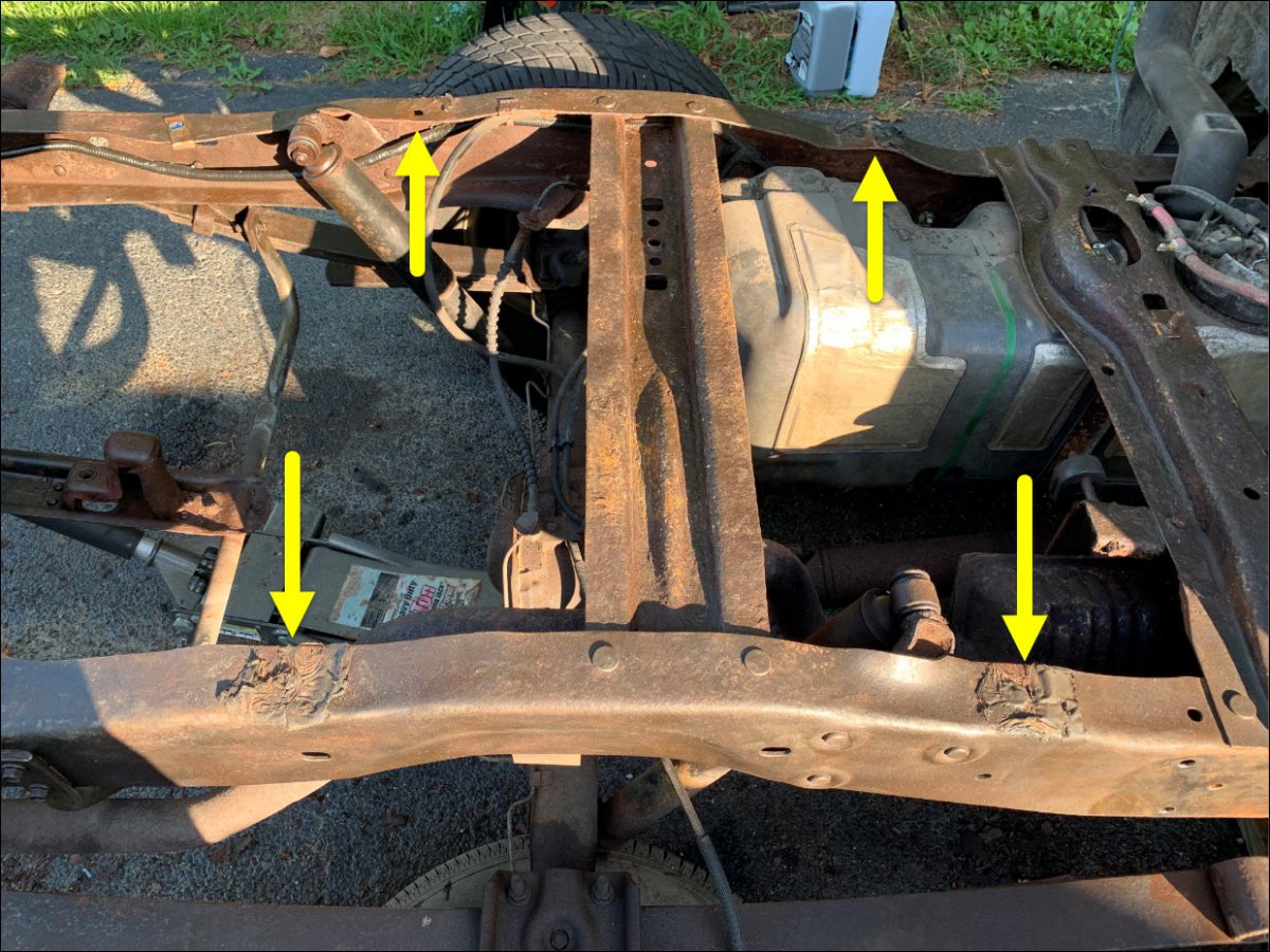

Below are the four locations where the rubber pads are/were. The top left one is the only one that now has a rust hole in it. The rest are just mangled from 23 years of service.

Gogle up "truck bed mounting pads" and many sites/photos come up....
Something like these.....

Thanks @Grumpaw I found something at LMC Trucks, that I think might be work, even though it's definitely not the same as what was there.
They call them "INSULATOR-BED TO FRAME". It's only $10 w/shipping so I'll give it a try.
