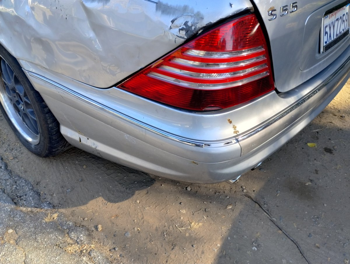

I've got a 2004 AMG S55 Mercedes that has body damage, this may be the new motor/trans for my next Ranger project. 491hp 5 speed auto.
Sounds interesting.
After hearing people's nightmares with maintenance on a Mercedes, I would be hard pressed to put their engine into anything. I work with a few people who (and their families) buy into the mercedes status symbol hype and are dealing with maintenance prices, parts, and limited service locations. I know that last one wouldn't affect you much. Also watched a lot of LegitStreetCars videos dealing with his Mercedes problems.
Sounds interesting.
It's my first ever Mercedes, I bought it for the Fast V8 supercharged motor, I don't really care for the car much, I want to rip it apart and stuff the engine into something useful.
I'm looking for a clean bodied Ranger with a bad motor / trans up to 2003/4.
i use to do lots of bmw racing. people always asked me why i never did mercedes racing. i asked if they ever opened the hood on a mercedes? you want to talk about vacuum lines for miles, thats mercedes. it looked likea bowl of spaghetti under the hood of all the mercedes i ever saw
