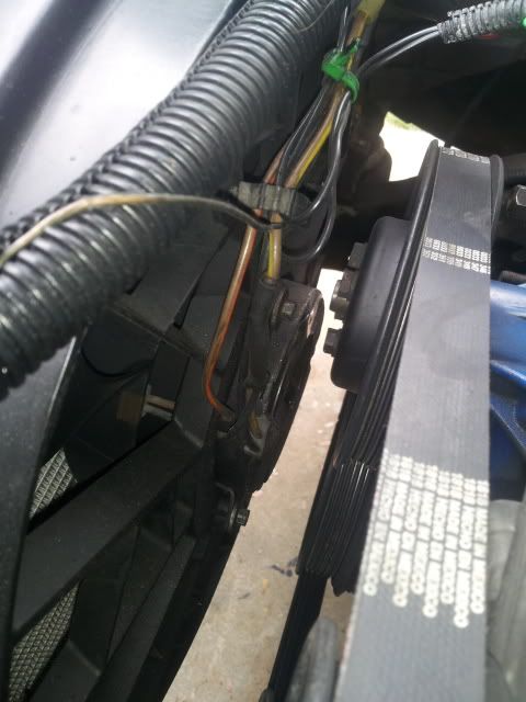

I used a Taurus fan four my 302 swap but I bought it off a guy on here along with the explorer rad. The low setting has kept my 5.0 cool, even last year during the record high temps. My truck mainly drives in town too. But the other day I figured out what wire turns on the high speed setting.
Here's a picture of my fan. The brown with the yellow stripe wire is the high speed for my fan. I'm going to hook it up via toggle switch and relay and then turn it on when my temp gauge (that I need to replace) says it's getting warmer then it should.
FYI - Don't apply voltage to both speeds at the same time.
