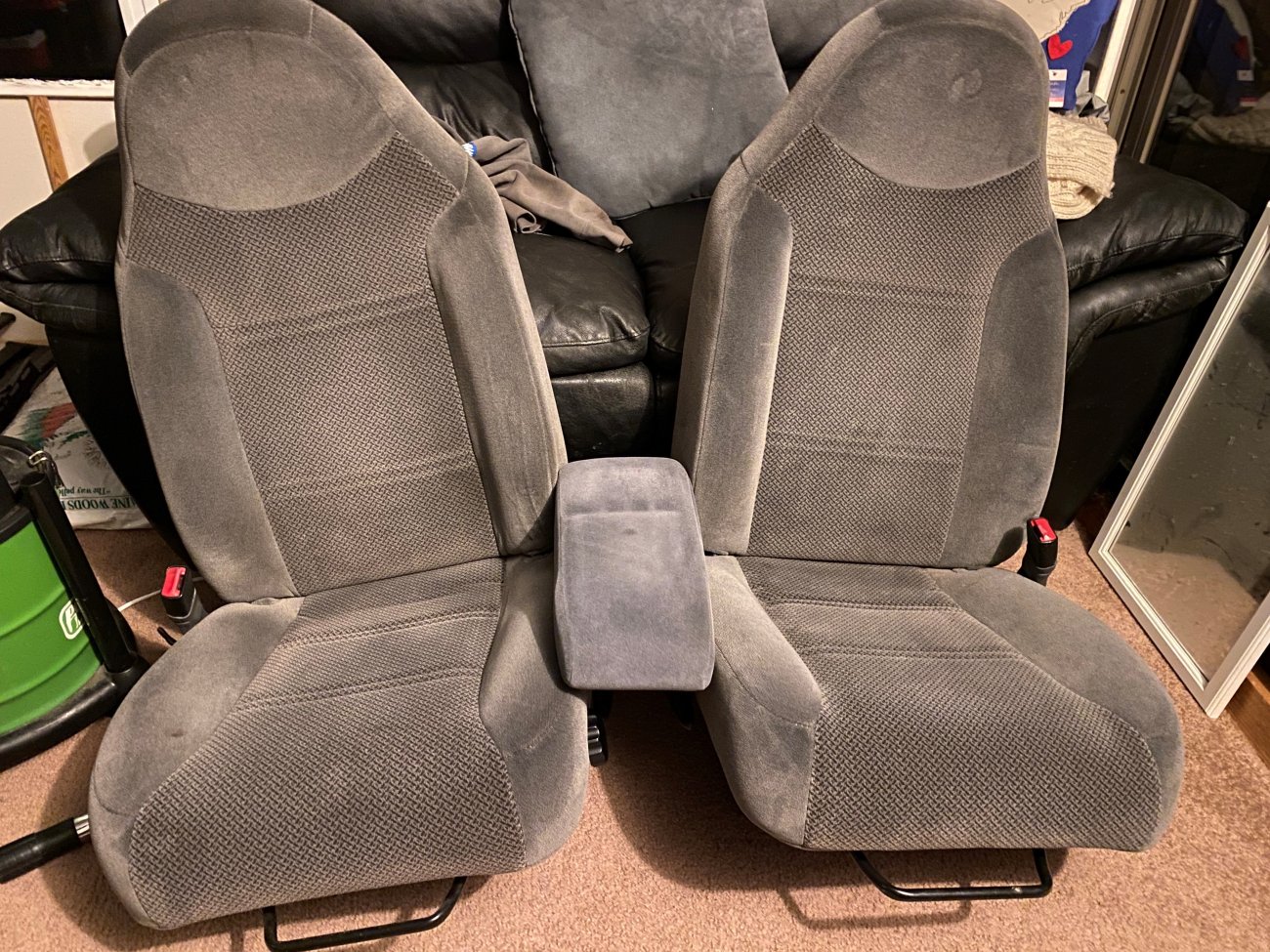

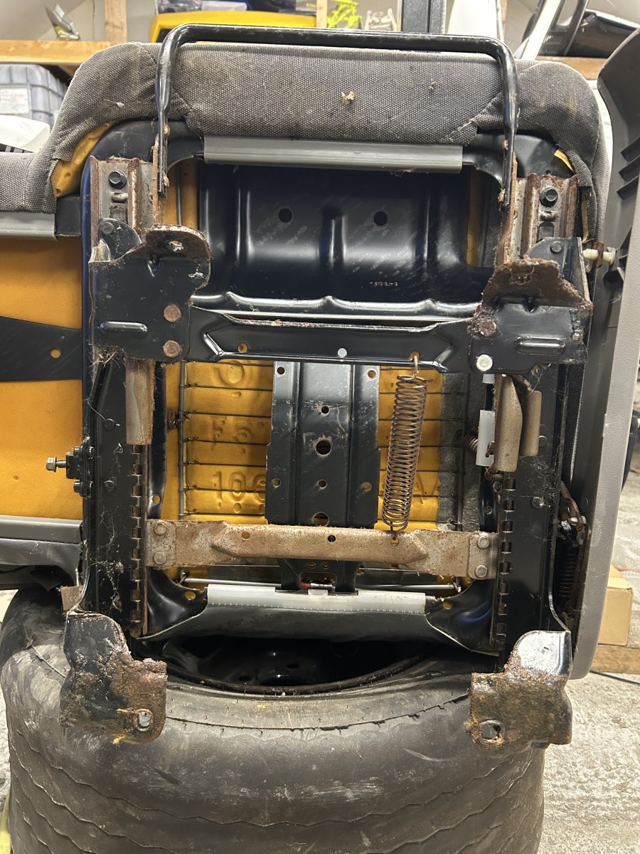

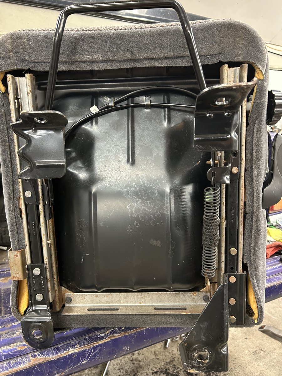

Figured id keep another seat thread going instead of starting new. Im a little confused. My old 60/40 bench seat (96 extended cab) was in terrible condition so i got some bucket seats and center console from what i was told was a 97 ranger. But the mounting positions and seat pans arent even close. It doesnt look like i can rail swap these because the new seats have lumbar adjustment too. And also the seat pan design is completely different. I need some help.
Old seat.

Replacement seat:

I'm going to say that seat pan difference doesn't matter, what is important is the mount locations for the rails being same or similar enough to use/adapt.
They could have been right about them coming out of a 97, but that's only part of the story. Regular bad and extended cab use different rails. I would imagine that some of the differences are regular cab to extended cab.

Did you try setting the new seats in? If you did and they didn't fit, what part didn't fit. It's hard to tell from the photos why they wouldn't work even though the feet are a little different.

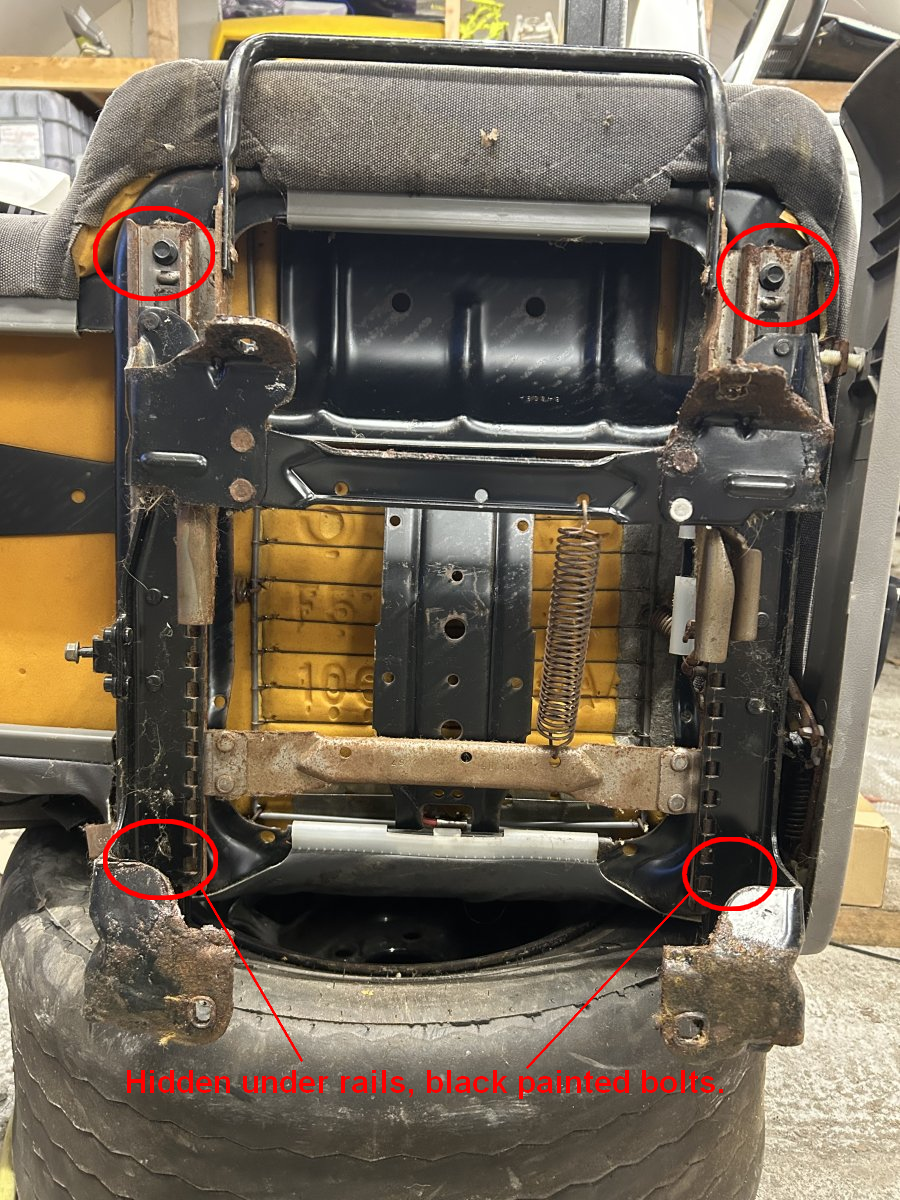

I see the feet as drastically different at the back.... At first I was thinking we were comparing drive new with passenger old (or at least a guess since 2nd gen the one rear foot goes way further back and much taller in the passenger seat)...then I saw the lumbar knob and figured both driver. But I don't know enough about 93-97 and 98+ to comment so I didn't say anything, waited for someone who knew... At this point I would just ask, even if they aren't ranger seats, they still look to be Ford - can't you swap the brackets? (4 bolts per seat have to slide the rails all the way forward to get to back bolts, all the way back to get to front bolts).

Seems like everything "bucket-ish" Ford from the 80's and 90's is all on a ~14.5" square and so by swapping rails you can use just about almost any Ford seat.
Those are the same as Explorer seats . I posted pictures long ago when I put them in a BR11. Bolt the rear in and make adapters to mount to the floor . MiG welder makes it fairly easy . I used the 2 door Explorer seats tracks which go back a lot further , Now my 6 foot 4 inch grandson isn’t in there like a sardine .

Fronts almost work but the inside height is a little different. Rears are even close to the holes or heights.

Rears arent even close to bolting in.

That was my original thought, was to just swap seat frames over. The original seats can unbolt, but the "new" ones dont have bolts. Second, on the "new seat" its doesnt have a flat rail all the way back. It stops half way. I think ill be cutting/welding mounts to make them work.

For the Ford Escape seats I swapped into my Ranger I separated the tracks by grinding off the stops and tabs and sliding the two rails apart. Then put the rail-half with the Ranger feet onto the rail-half still bolted to the Escape seat.
For that swap, the Escape tracks were positioned wider on the seat than the Ranger's so I had to add a little bit more foot onto the outside feet to make them work. But if your rails are the same distance apart it should be a straight swap.
What I finally figured out is that the black track with the feet can be separated from the silver track with just a little work. There's one stop riveted in on the silver track side, and then the black tracks have two little tabs at the front. Grind down the tabs and grind off the top of that riveted stop and punch it through with a hammer, and you can remove the black track through the back of the silver track. Maybe I'm just dense but up until this point I was originally trying to figure out how to cut off the feet and get them on the new seat track.
