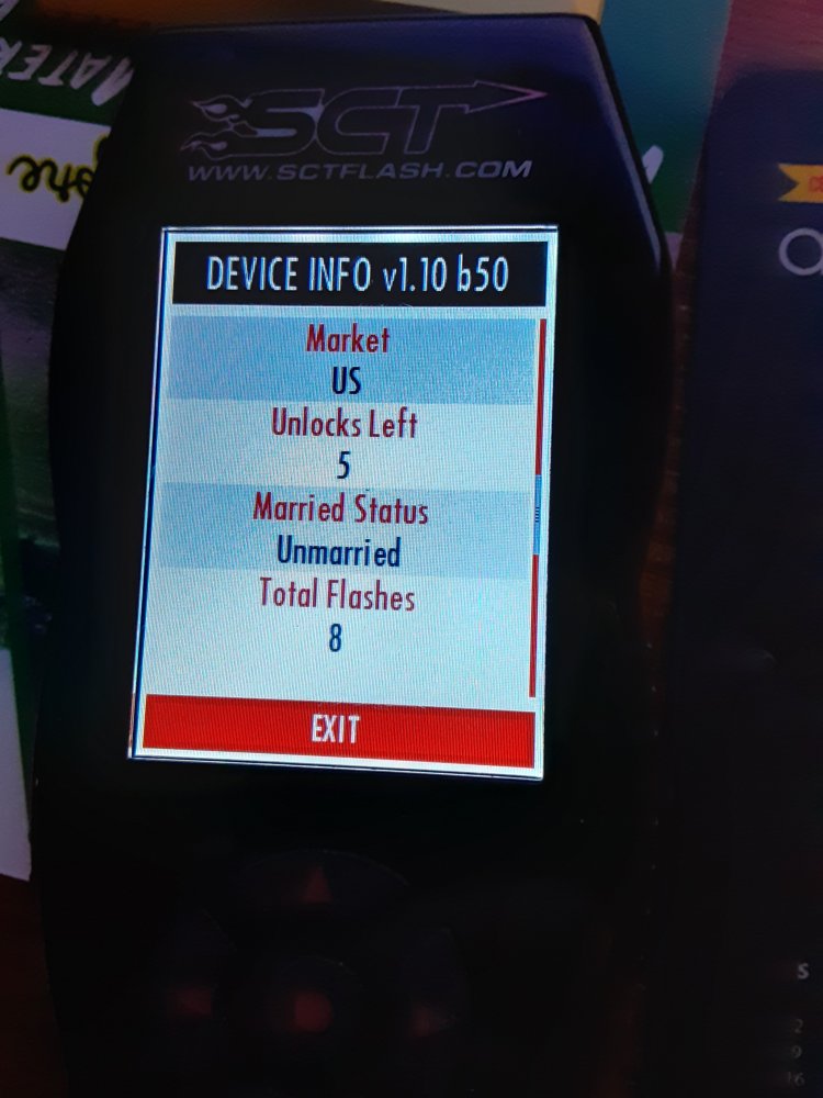

This is what I have on the programmer. Looks pretty clean and unmarried -- whatever that means.
Unmarried means that you can use it to tune any new vehicle that you have a tune for.
Once you use it to tune a vehicle, it becomes married to that vehicle and cannot be used on a different vehicle until it is unmarried from the first.
