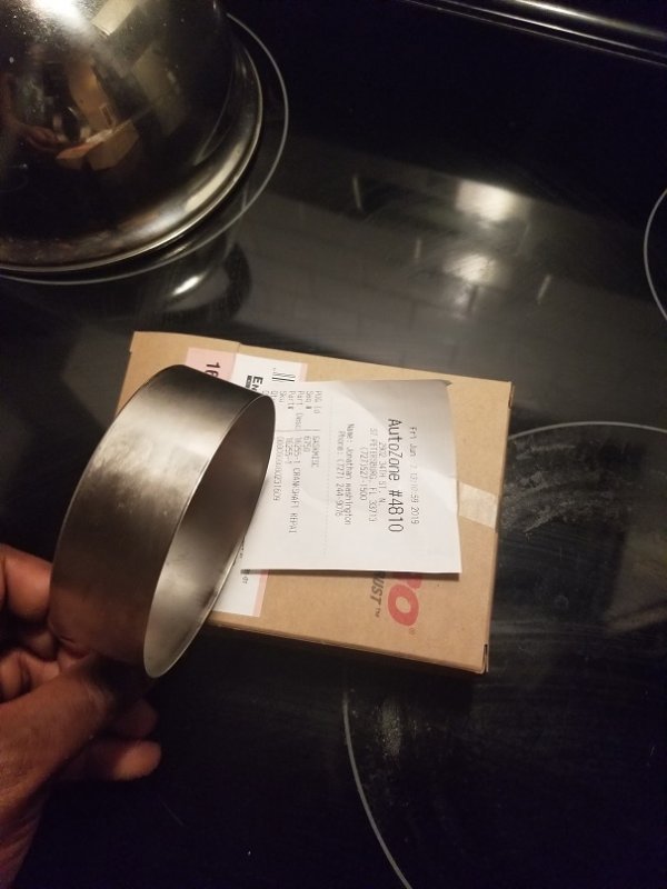

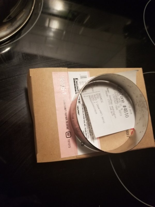

This is a sleeve i got for 11bucks at auto zone seems to be the right size. I was actually going to do that Tom but my nerves are shot I would have been worry about it every single day and whether the seal would tear apart. Since I'm pulling engine for last time (hopefully) and just put a sleeve and call it a day shoving back in and see how she runs.
