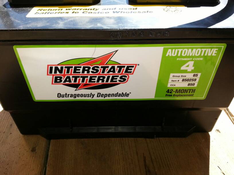

The best (read: best value in) batteries I know of are probably the Kirkland/Interstate batteries at Costco.

The best (read: best value in) batteries I know of are probably the Kirkland/Interstate batteries at Costco..
I am Shane, and I approve of this message. Their warranty is awesome. They have a 42 month, that's right FORTY TWO month warranty. If your battery dies, and you get it replaced, the warranty renews.
