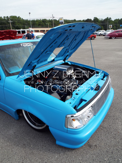

the 350 will fit as good or better then the typical 302 in the 1st gen as far as cooling is concerned, we used v8 jeep radiators a few times. but with bigger power where you will want some nice headers, shit gets tricky. even so good headers for a ford arent the cheapest easiest thing to work with either.
i currently run what is essentially a big block, and have worked on bb swaps to varying degrees and manufacturers.
