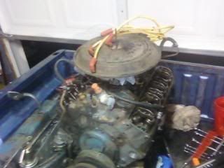

so i set my mock up block in place with my motor mounts bolted in and found out that nothing lined up like i had planned :icon_confused: ..... I tried adjusting the motor mounts as much as i could but no luck. The problem i was running into was when i marked the holes for the motor mounts, they weren't sitting perfectly flat on the crossmember, and now when i bolt everything in they kinda pivot upwards making it too tight for the sbc to slide in. Time to get the welder out....
not the best picture, but here's tne new heartbeat...
