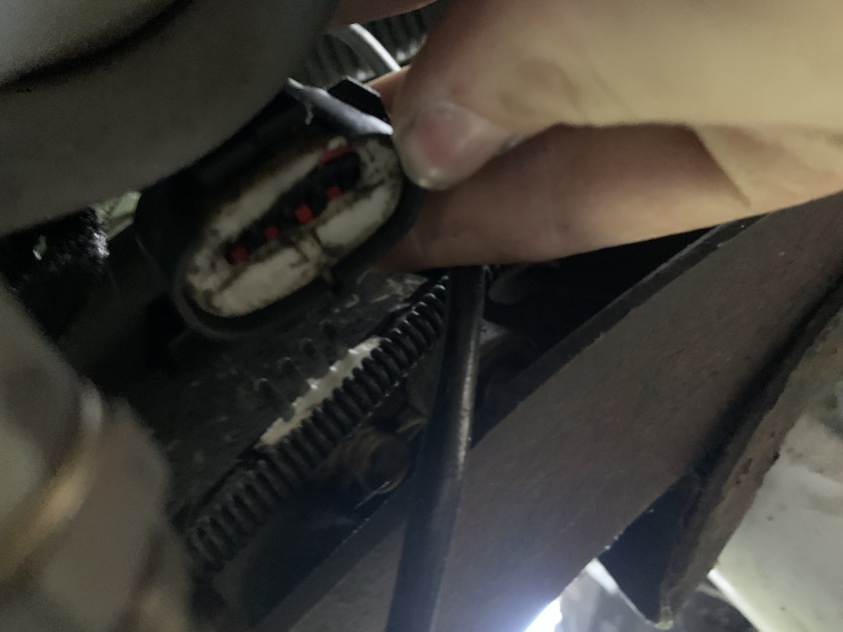

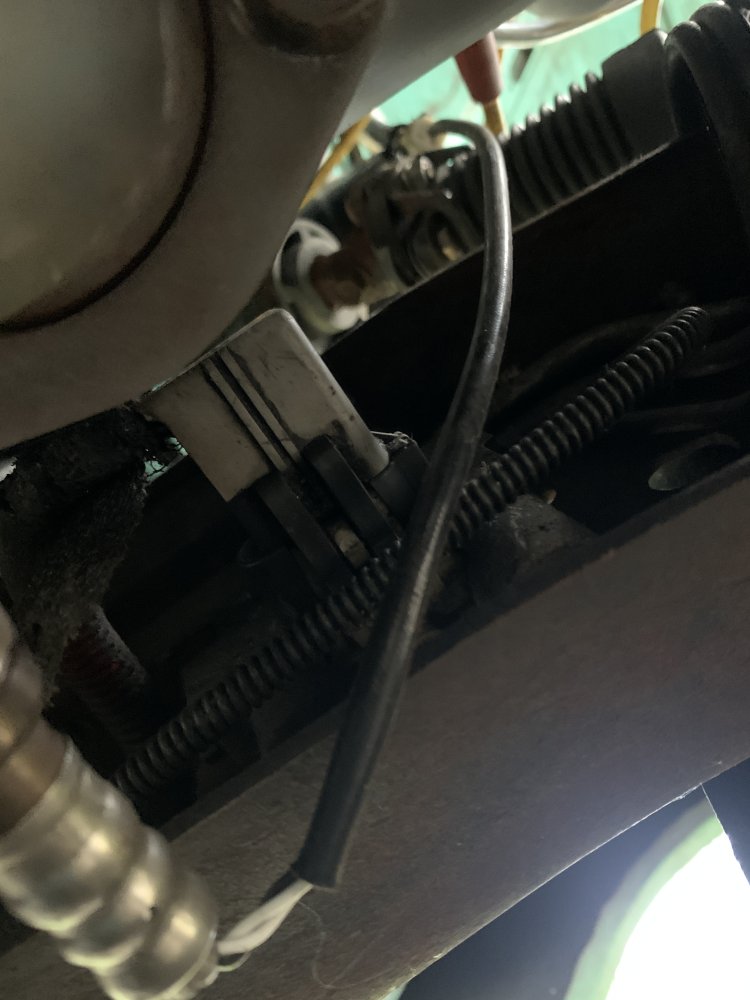

Another problem after the other. When i go to turn my key i hear silence, whereas a month ago it would prime and start. Its a rebuilt 306 5.0 that would cut out at higher rpm's, so i replaced the fuel pump a few days ago and still no priming. Im getting to the point where i think wiring a switch to turn the fuel pump would be better, but im not ready to give up lol. The relay is relatively new, the inertia switch is good, and fuze didn't blow either. Sounds to me like i have a grounding problem but my grounds are sanded and tight. Am i missing one possibly? My connector at the frame rail is pretty beat up as well, ill attach a picture. Megasquirt and a harness is my last resort.

I was hoping you would find this post Ron. Ive combed through a bunch of your replies to other threads. I will try jumping it through the relay. Its a brand new pump so im hoping nothing wrong with it. I did try it turning it on yesterday, heard a faint click 2 ish seconds after turning the key, which usually happens when its working. Thank you for the reply.

Sorry for not replying earlier, i broke my leg. The relay was getting 12v, i jumped the relay and heard the click after 2 seconds, but no pump sound

followed the steps. Tan/Blk is always 12v hot. Green is fuel pump wire. The Blue/Or reads 0v both with key on and off. Red wire shows .25 v. There is no power to the inertia switch, but when i jump 12v to fuel pump wire it reads 12v. I jumped the green and tan slots but still no fuel pump. Brand new fuel pump as well.

When i jump the yellow/black to Green/yellow the inertia switch pink wire is hot. Pink/Blk reads hot when it goes into the frame on the drivers side towards the fuel pump. There is a grounding wire (Blk/white) there which is grounded to the fender.
Still hearing a click 2 seconds after the key is turned, but when i jump the wires the fuel pump wont activate.
So there is no 12v or no ground at fuel pump connector, or bad fuel pump
