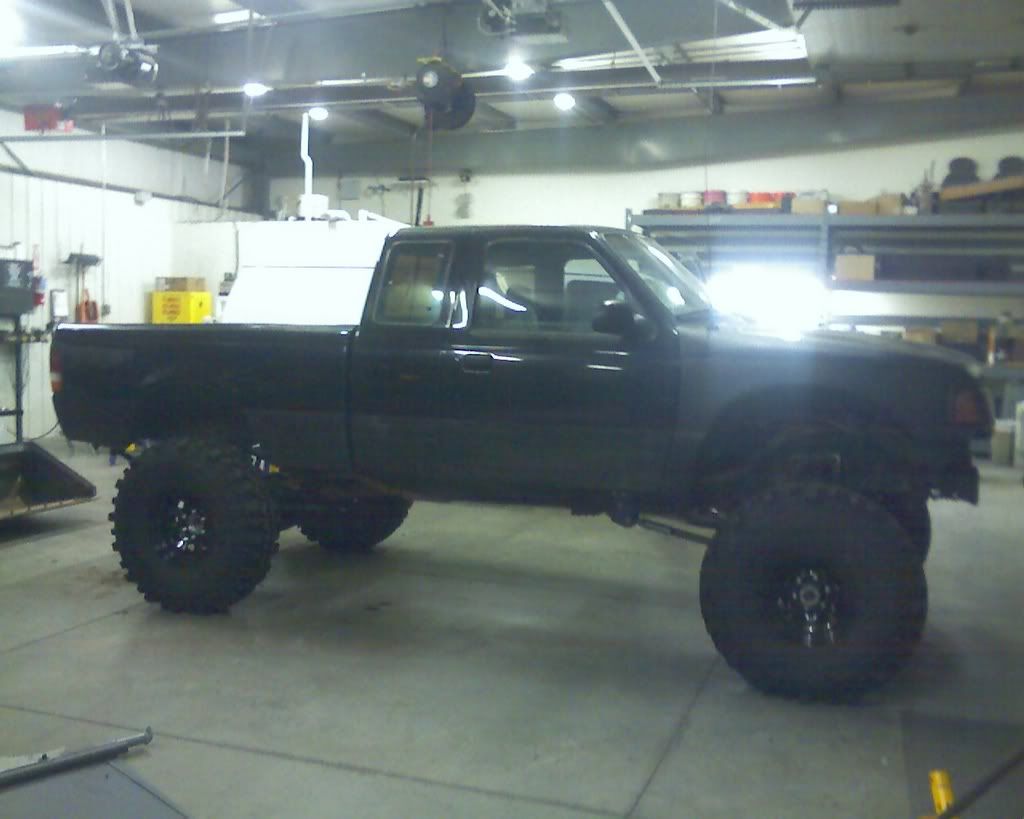

Just got the rear shackles made and installed today, i was stoked to see it sit level, tell me what you think.
The front is a 1979 f-250 HP dana 44, chromoly shafts, 760X u-joints, detroit locker, 5.13's, and warn hubs
The rear is a 1997 explorer 8.8 with super 88 kit, detroit locker, and 5.13's
The suspension is a custom 3-link with rusty's 8.5" coils and custom coil buckets.
Here's a pic of the front with no trac bar and no shackles in the back

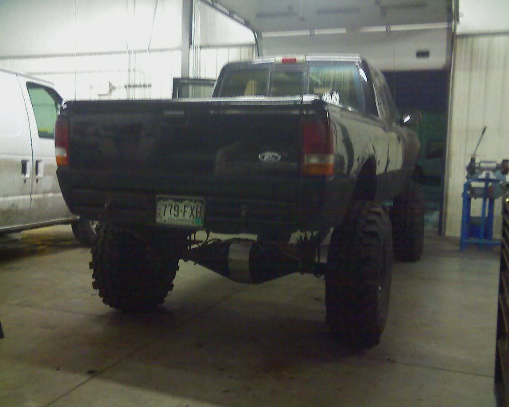

Here's a pic of the rear, homemade truss and diff cover
hey that looks pretty sweet.. any more pics of that rear bumper?? kinda looks IDENTICAL TO the one i built haha
You guys narrow the front ed or leave it full width? Looks good with the glass fenders!!
**** ya thats the way its supposed to look. good work
Looks pretty good, but lose the body lift, it's too tall.
