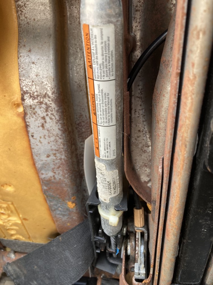

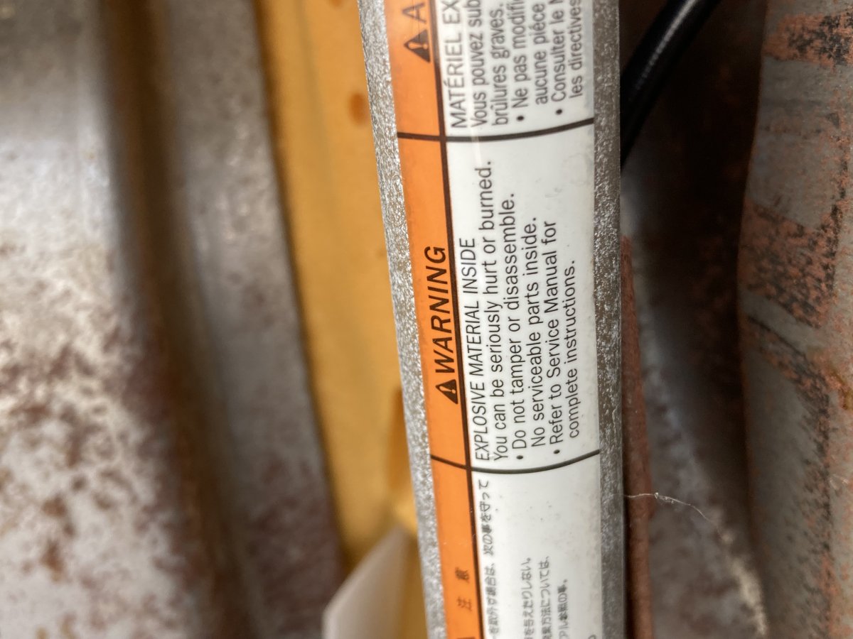

But up under the rail on the driver's seat there's this canister that says "Warning: EXPLOSIVE MATERIAL INSIDE..."
Do I have to worry about this if there's no power to these seats?

The best solution is to put a jumper across those 2 pins on the connector to the airbag - that way there is not even a chance of static electricity buildup causing the bag to blow.
Side impact airbags weren’t available on a Ranger until 2010… those would be seatbelt pre-tensioners. The small explosive pulls the seat belt tighter in the event of an accident.
Thanks for the reply! Good bit of info - yeah, ok... I could see the little explosive thingie attached to a cable that goes to a spring-looking thing near the seat belt tensioner under the seat...

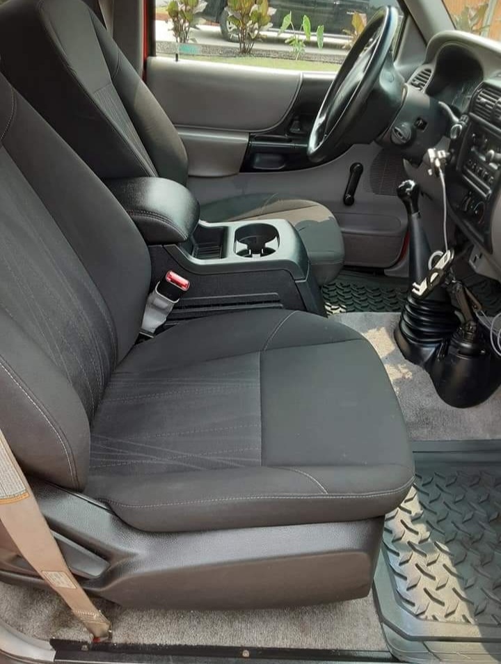

The seats look good.
I installed a set of 2016 Focus seats in my 98. They have the same warning underneath. Mine have no power to them either. No worries in them going off.
We're these difficult to install, and how much modification did you have to do?
Thanks
Thanks

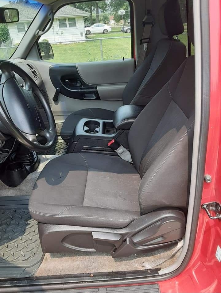

I cut the tracks off of the Ranger and Focus seats and then welded the Ranger tracks back onto the Focus seats. Removing the tracks took the most time. Its an all day job but worth it.
Ok, awesome - thanks! Just the info I was looking for. Gonna get these cleaned up and installed then.
Post some pics when you get them installed.
