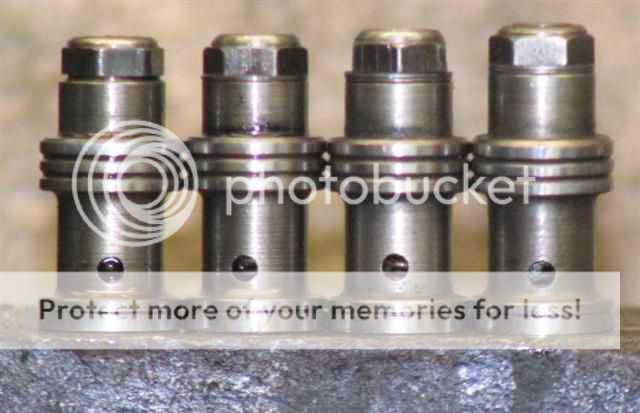

FYI...
The relief spool is .666" which is about .003" under 17mm
Sent from my XT907 using Tapatalk

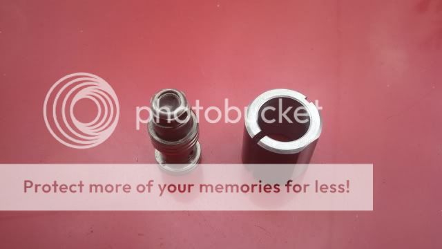

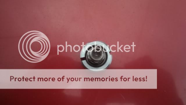

Here is the spool clamp I made. To hold the relief spool in the vise while I break the bolt loose
