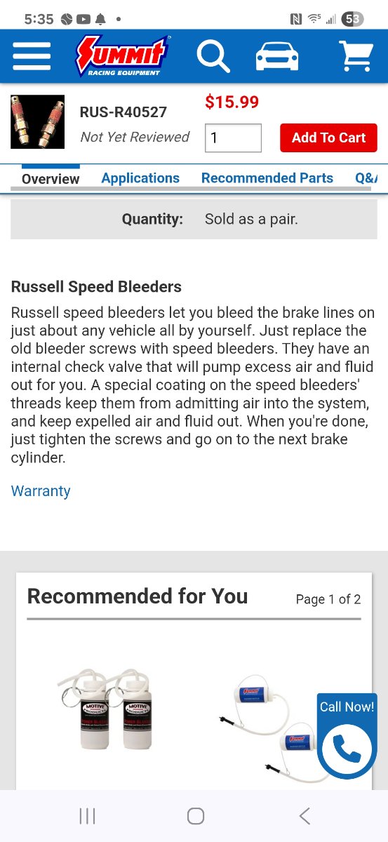

No.If I end up replacing the 27-year-old brake bleeder screws, do I put anything on the threads???
The threads have nothing to do with sealing the system. IMO keeping possible contamination away is more important than thread life. And the threads that are in the component won't corrode anyway.
