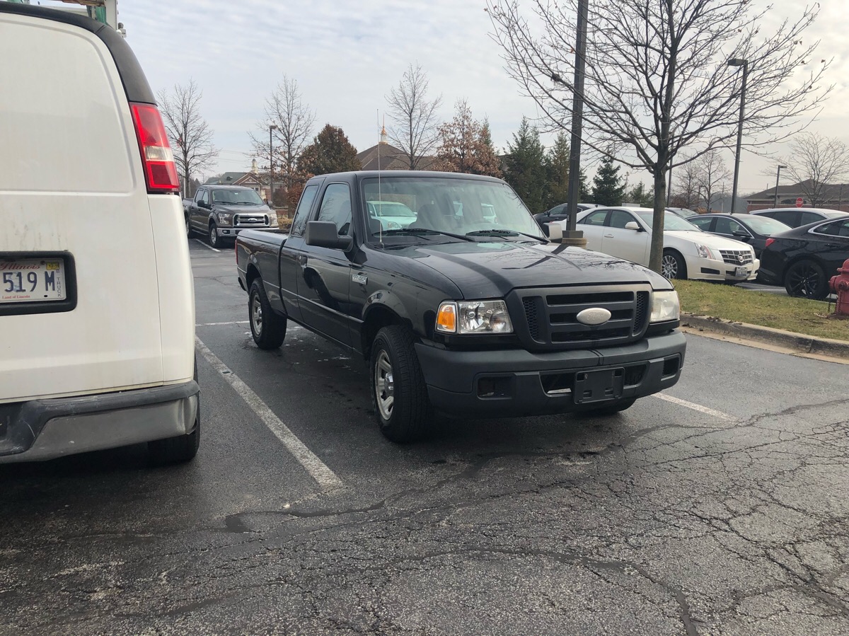

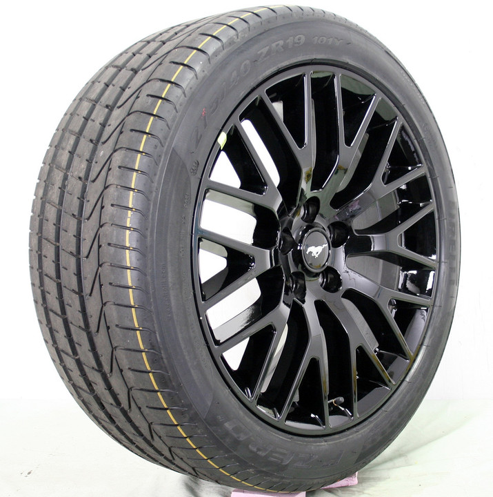

Hi all,
I just picked up a nice ‘06 Ranger. (2wd) I have a set of 2015 Mustang GT track pack (19”) wheels sitting in storage. Just wondering if anyone tried to slap on S550 wheels around here? I won’t be able to get them out of storage for a couple weeks and I was curious if it was even worth the attempt. Here’s a pic of my truck and what the wheels look like..

If its the same bolt pattern and they clear why not. Id wait till after winter tho if you get snow to preserve them till it nice out
Considering the backspacing of the Mustang wheels you will need some wheel spacers to get your wheels to fit without hitting anything and you still may have issues with the overall size of the Mustang 19" wheels hitting when you turn. I just installed some 16" Mustang wheels on my 1998 Ranger XLT and I had to use 1" aluminum wheel spacers in the front and 1 1/4" aluminum wheel spacers in the rear but other than that the wheels fit great. Hope This Helps
The bolt pattern is correct, and with those wheels that is about where the similarities stop.
Thanks guys. No problem, I knew I would need spacers. I need to play with the tire size now.
