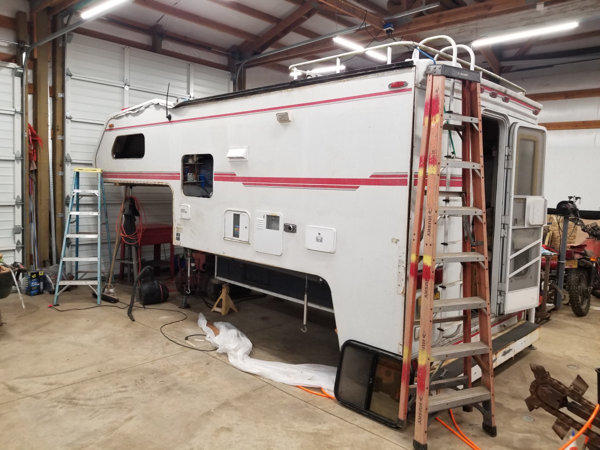

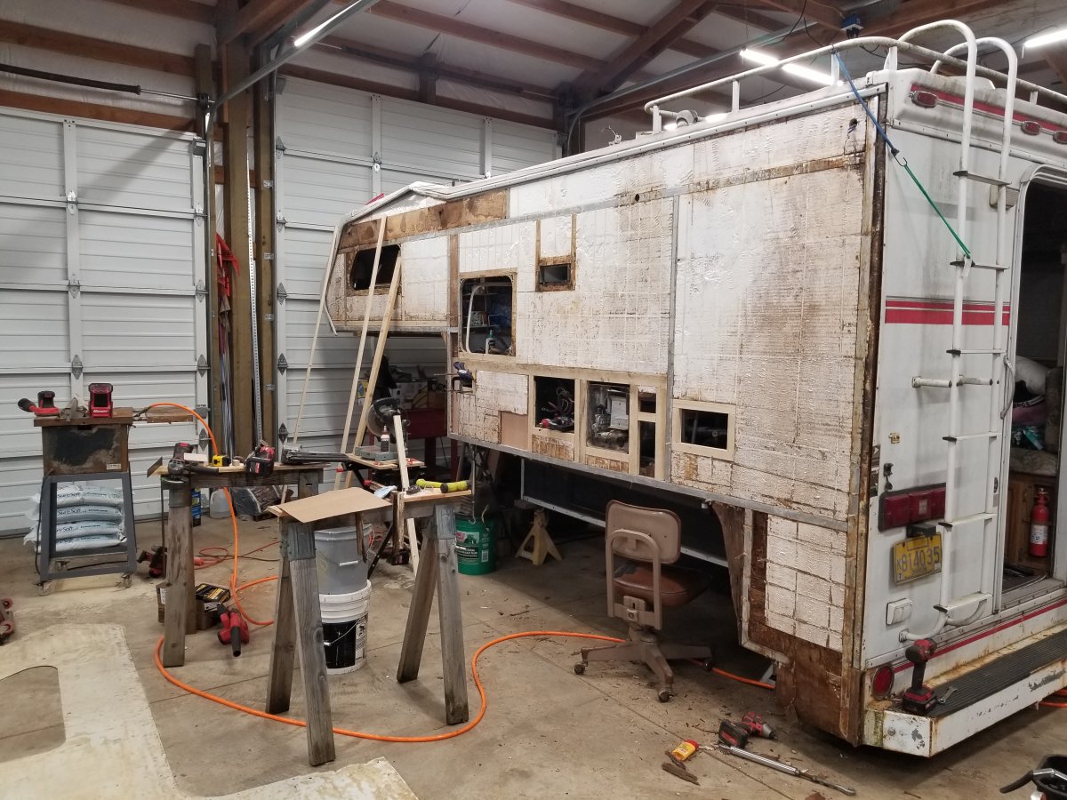

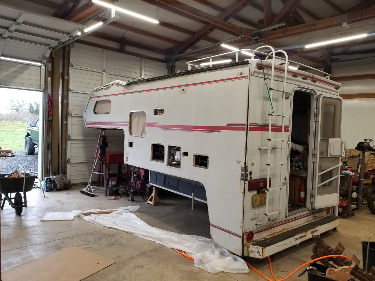

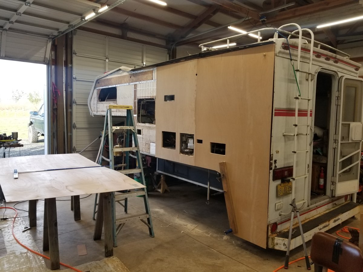

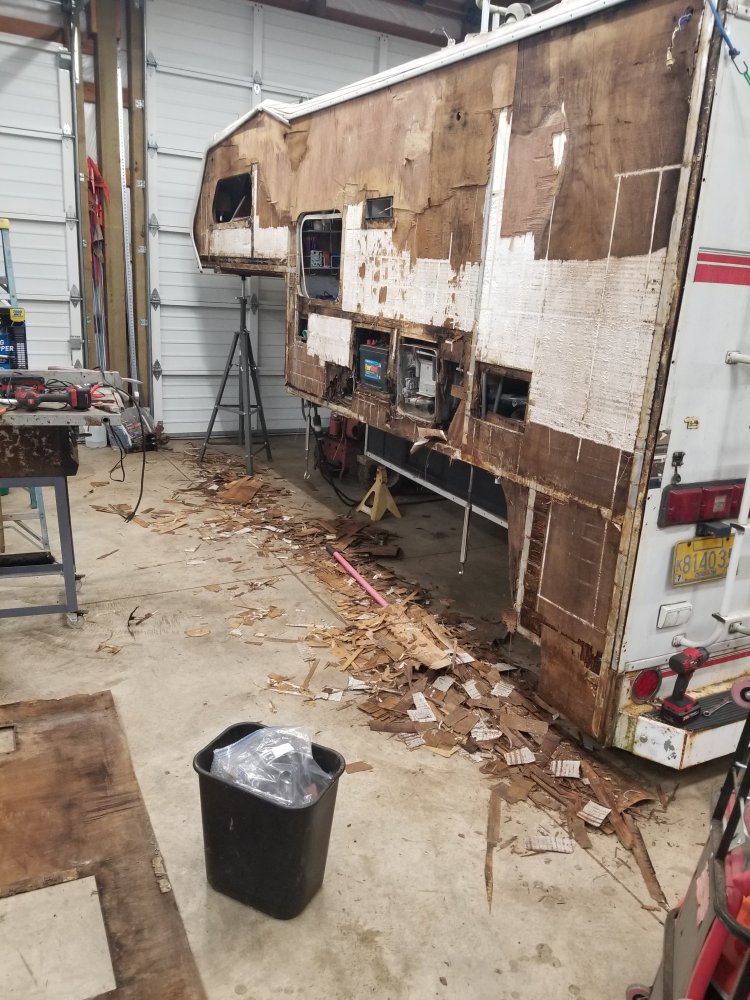

I've posted in the general area on this some but have a couple questions for those that might be more versed in wood work than I am...
I've pulled the side of the thing, lots of rot, the layer of 1/8" ply is DONE so it's now almost all scraped off, I have replacement, still need to do some structure repair around the foam... I don't know how the plywood was glued on before... There's some gap filling to be done now that I've scraped the wood off. I'm contemplating getting some FRP construction adhesive since it's available in a gallon can instead of regular just in caulking tubes, thoughts? I did some looking and I don't think it should attack the foam but not sure...
For the outer skin I ordered some Landau top contact cement that's sprayable with a paint spray gun, supposed to be good stuff... not going to be fun but we'll get there when we get there...
Appreciate any thoughts.
