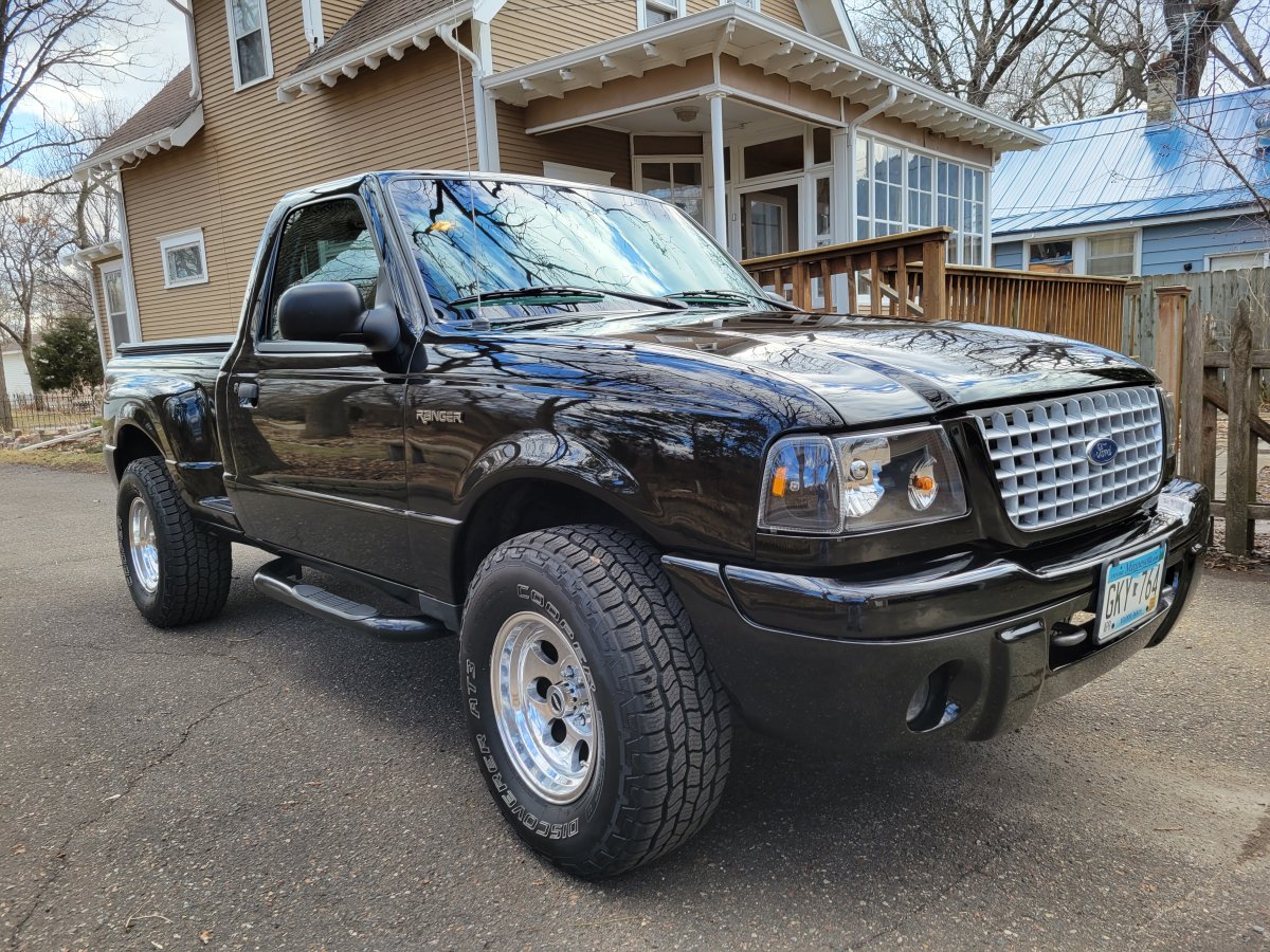

I'm hoping to address frame issues this summer. Mine's still worth keeping but needs some TLC. Some may think I'm crazy for doing this, but then again, it's my truck.
