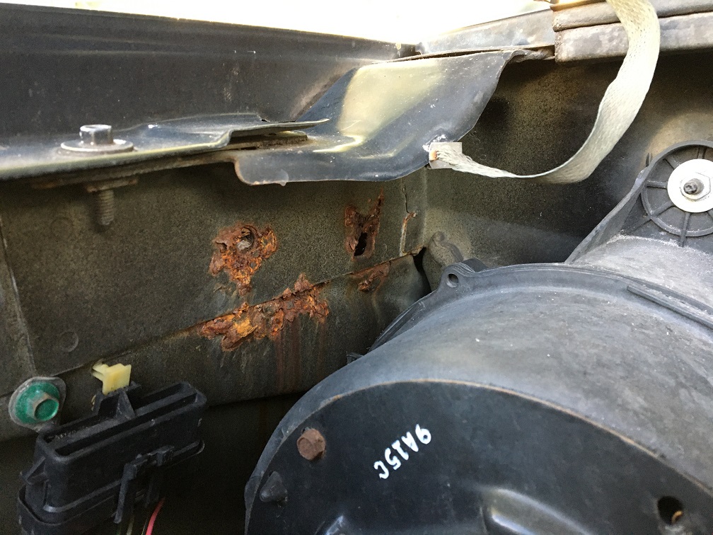

... right rear corner, near the blower motor, wondering if this is a "Florida thing", i.e. humid air condensing due to icy A/C air moving nearby?...
>>> Can I access the backside of this from the wheel wells if I remove the fender skirts? Figured I'd grind/nibble it out, hit the surrounding areas with Dupli-Color Rust Fix ("turns rust to black primer"), and patch with plastic screen + epoxy putty (PC-7 is my fave)... suggestions???
Thanks in advance.

That's better then anything from Michigan.
Will be hacking mine all out this year.
That's not bad. It's the firewall seam....torque box for the hinge mounts and the A pillar base with the windshield that is a pia.
Where might rain be leaking in? Could this be related to beaucoup leaves trapped in the "cowl"?
