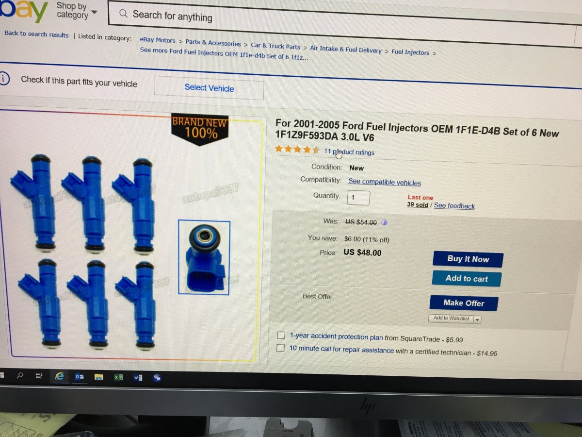

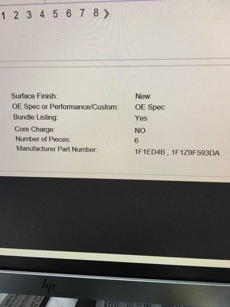

1F1Z9F593DA I think this is a flex injector, which will be my whole problem. I went back and looked over the description and it never says gas/flex anywhere. I'll clean the old set and put them back in.
Yes that is a Flex Fuel injector part number, you would need a flex fuel computer(PCM) to use it
It would cause Rich codes if used with a gas only PCM
