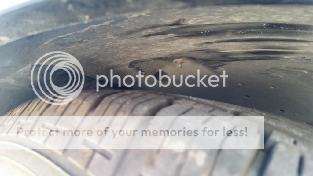

Hey guys, I've been gone a while thanks to school. But now that I'm back, I'm sitting a little bit lower. ~3/4 inches lower to be precise. I'm running DJM drop springs with pancake bump stops in the front and a flip kit on the inner hole and my helper springs loosened a little to get it to sit level. I'm sitting on stock rims wrapped in P235/75/R15 tires all the way around. The issue is that when I take a turn a little quick or hit a sizable bump on the freeway, the front tires rub on the inner fender plastic. How are people getting around rubbing? I like the way the truck looks with the tire size so I'd like to keep that the same if possible.
Also, on a possibly unrelated note, when I give the truck gas it feels like the back end is swinging just slightly towards the driver side to the point of requiring correction with the steering wheel. I don't remember it doing that before I dropped it.
Pics for reference
I don't think you can really get around rubbing with that tire size. you could cut a hole for the tires to clear or relocate everything attached to them and remove them all together. Tires size is usually a compromise, you could go a size lower or 2 and get the same look but after lowering it you don't have much else you can do.. hope this helps.
i was thinking about just moving the inner fender up away from the tire, but i have no idea how it is attached or how i would reattach it at a different distance. the driver side has way too much stuff in the way to get a good look at what that would entail. I've though about taking them off but the engine bay gets dirty enough as it is thanks to lovely Louisiana's constant construction. And these tires are brand new unfortunately, but I get what you're saying about going down a size or 2
You can remove the plastic liners, but you'd only gain the thickness of the liner in clearance because the metal inner fender is just on the other side of the plastic liner.
The only way you're going to stop the rubbing is to lift it up a bit, get smaller tires, or start cutting out the inner fenders. The bagged guys like to cut out the stock inner fenders completely and replace them with trailer fenders in a place where they won't rub. That's a lot more time, money, and work than just getting smaller tires though.
Didn't realize there was metal on the other side of that. Eesh, yeah i see what you mean there. So what the general consensus seems to be is that I need to steal the AM wheel combo off of my friend's mustang so I don't need to do metal work. Now to distract him long enough to swap them out...
