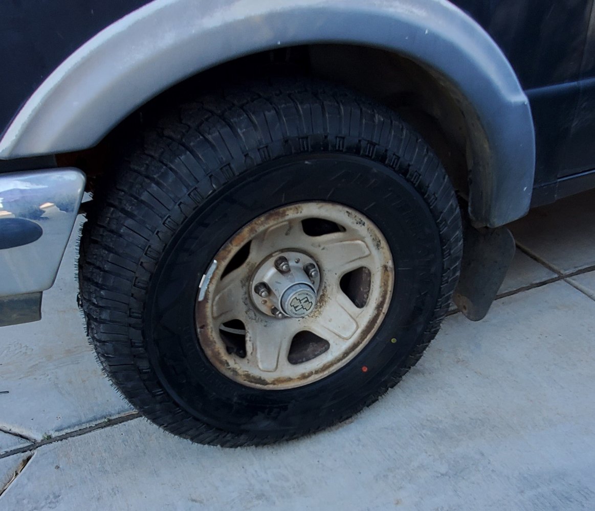

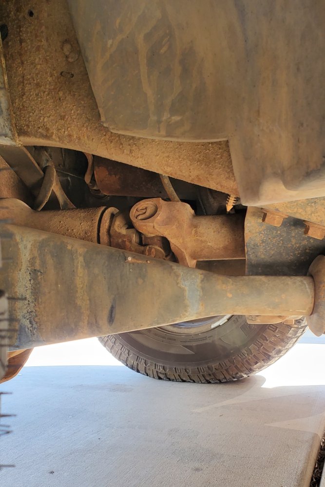

On my 94 Ext cab 4x4, stock suspension, I barely get a rub with Corsa 31x10.50 only on the drivers side on hard left turns. It might just be the nubs from on the new tire but you can see the small rub spot. Any worries or drive it like I stole it?
