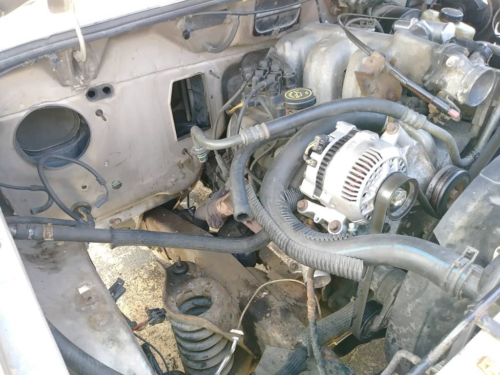

It finally stopped raining. So things are looking up and "hey might be able to get this thing back together today!" I was thinking.
What whoa,?!
"D, look at that, 2 lines connect to that brake hose, you can't see the one because it goes in the back where the clip holds that little block in place the frame".

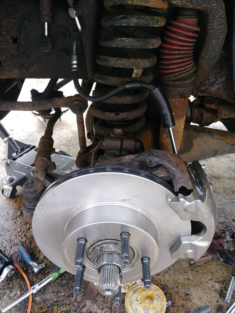

Front brakes, rotors are on, new front brake hoses, seat of the pants wheel alignment done, looks like Ieft side camber needs a bit more +
The beast seems to stop on a dime in the driveway, I don't know why I'm afraid to take it for a drive.

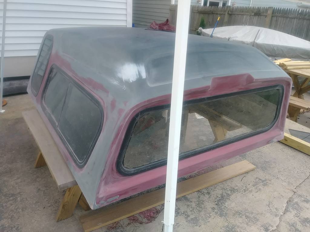

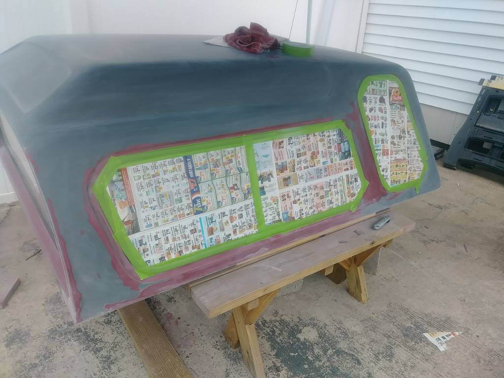

I have a fiberglass cap that I'm slowly working on but I'm very limited in my ability and progress because I don't have a garage but I'm halfway into it!

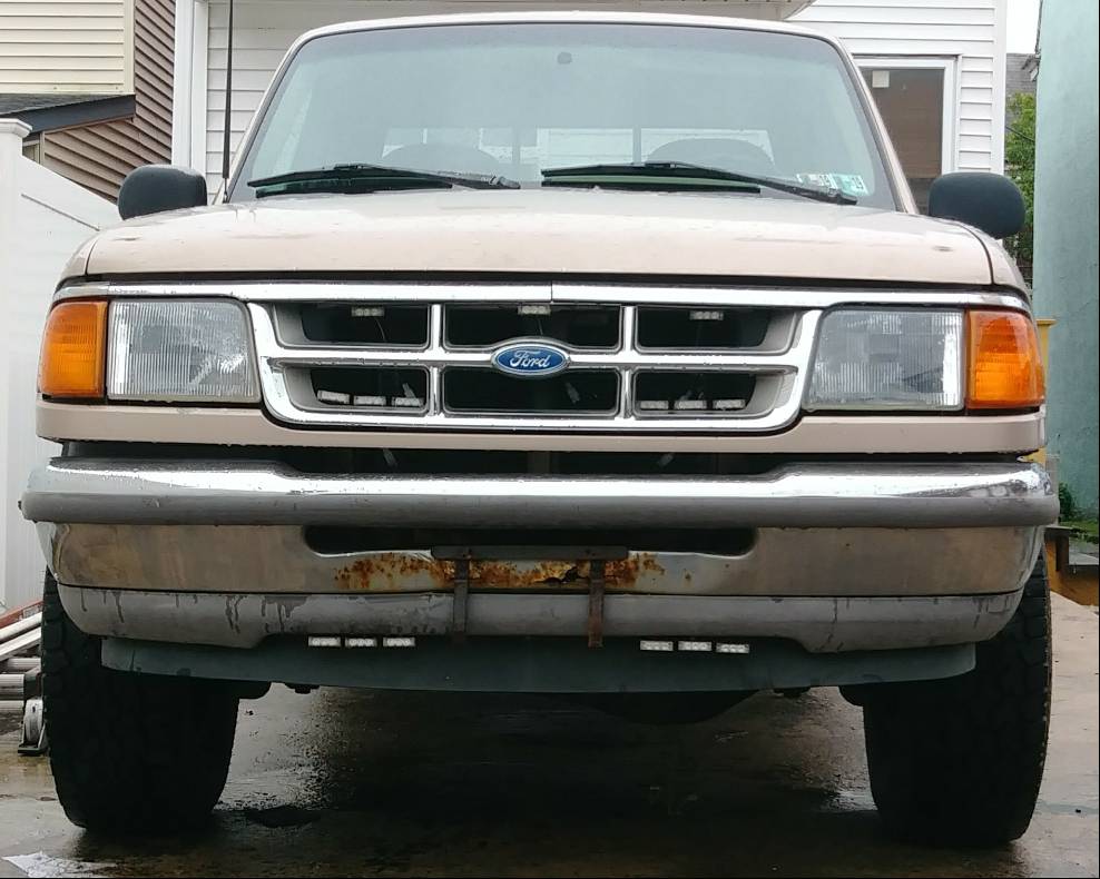

Been awhile since I've updated this thread. Still lots to do on the "beast" The "shake was the nearly new 31s that came with the truck. I spent nearly a year trying to find the shake finally took into the shop for a "clinking chirp" in the one pice driveshaft we put in during the fall. I was pretty sure the truck needed rear work or another rear. It was the freaking tires! talking like 1/2" out of round or flat spots. the chirp was dry but new universal joints! (new one on me)
I finally had the rear spring shackle mounts rotated. the shackles are now on the bottom of the mounts,not on top which not only lowered the truck, it also limited the travel of the main leaf.
before and after pics.
Next issue front spring height!

I always wondered what “flipping the shackle” would do. Full size trucks did run them above the bracket that’s attached to the frame. Fords seems to be the worst on those rusting and breaking. Cheap steel or bad design? Not sure. When I replaced mine on the ‘93 4x I used to have, I sprayed the new brackets down with aerosol bedliner spray.
I'd isay you don't have to be a suspension expert to know it's wrong to have the shackle upside down on a Ford ranger I mean if it was done to lower the truck why didn't they just take the lift blocks off the axle!
i did that once with my '93. didnt like it that way so put them back in. later on i had a bent frame issue and to get the rear end to be level i had a lift block on the left side and no lift block on the right side.
