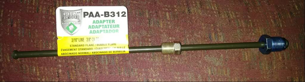

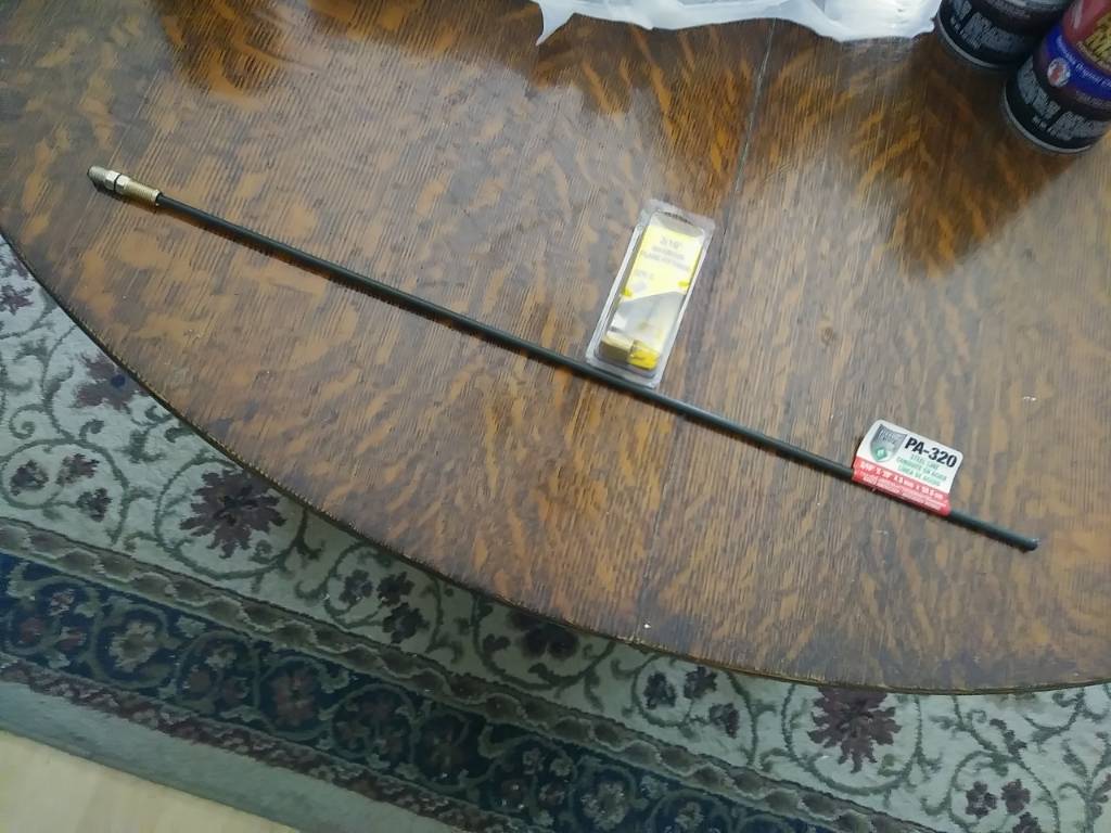

This is more informational than an update on the truck. The current item on my list is bypassing the rabs with a new brake line to the master cylinder
Master Cylinder Port Sizes:Primary M10x1.0 , Secondary M12x1.0

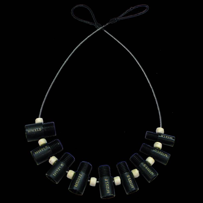

This http://www.agscompany.com/product/brake-line-fitting-sizing-gauge-metric/
which I do not have seems to be necessary for anyone that's going to spend more than a few hours working on mixed metric and USA brake line fittings.
The master cylinder and the rabs unit use the metric inverted flare connections if any of this is wrong please correct me!

Far as I go today till some help shows up later in the week, but I look at this as a minor success!

Last time I worked on brake lines, one of those sizing tools (not for sale) was hanging on the rack with the brake lines and fittings at my local parts store. I was able to use it to find what size I needed. They also had a female sizing tool there that I could thread my old flare nuts into to determine the size. But it seems like you know the sizes. M10.0x1 and M12.0x1 what question are you still trying to answer?

I pretty much settled all the questions about the fittings Eric. I just wanted to post the information for others that will have to deal with it sometime in the future we're past or present LOL

I like that brake line gauge. Next payday I'm getting one.
The tool pictured includes the female ends. They are in the bottom part that is smooth and has the thread size stamped in it.
