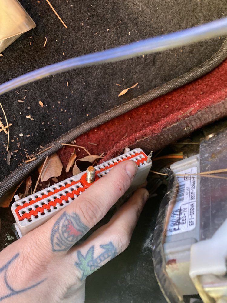

Big update I took my ecm off and there’s a broken connector stuck in the big loom you unbolt

So I had a spare ecu from an 88 ranger with manual transmission put it in and made no difference still turned on then turn off after maybe 20 seconds. Pretty stumped tbh basically every sensor is new, new plugs and wires, cap and rotor all new pumps, regulator is fine, 35 psi of fuel pressure the entire time, timing set perfectly at 10 degrees with spout disconnected. Gotta love it lol
I believe thats a ground pin. Could definantly cause weird issues
