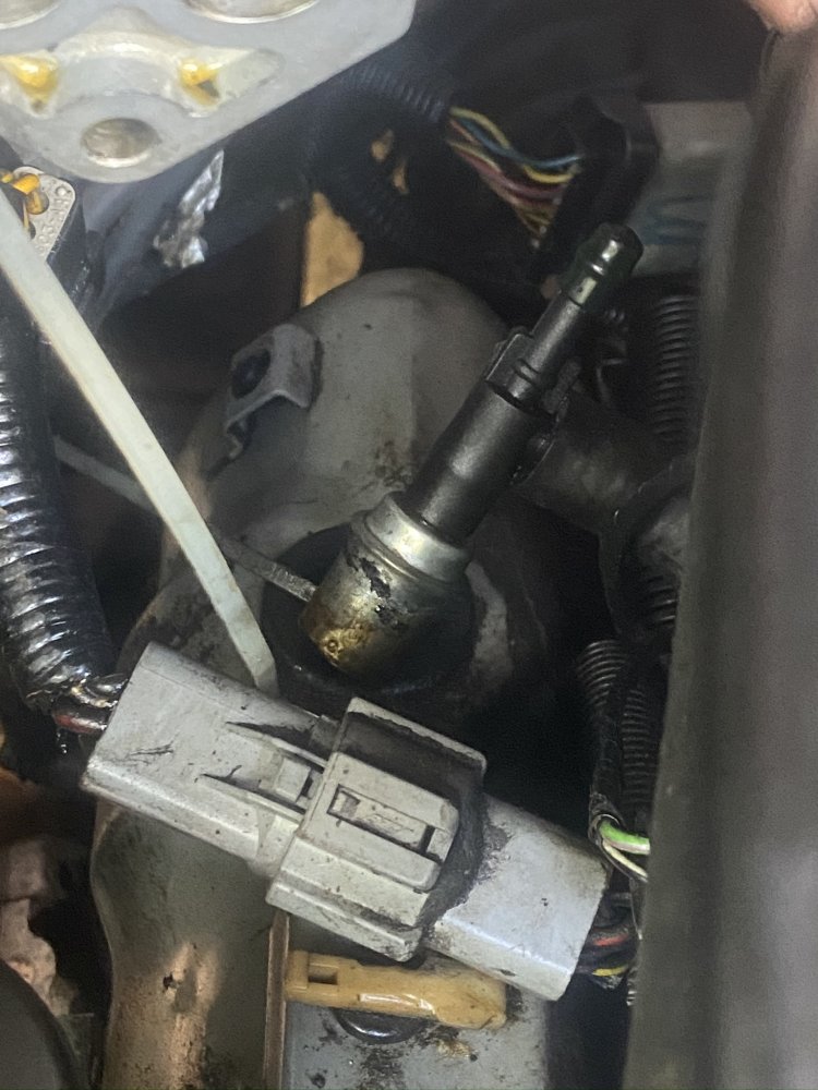

I'm going to replace the injectors and plug leads so see if that eliminates the ticking. They look like they need to be replaced anyway.
There's fuel pooling in the lip of the valve cover, but the pressure regulator is not wet, not is anything in the area.
Ticking could very well be the injectors

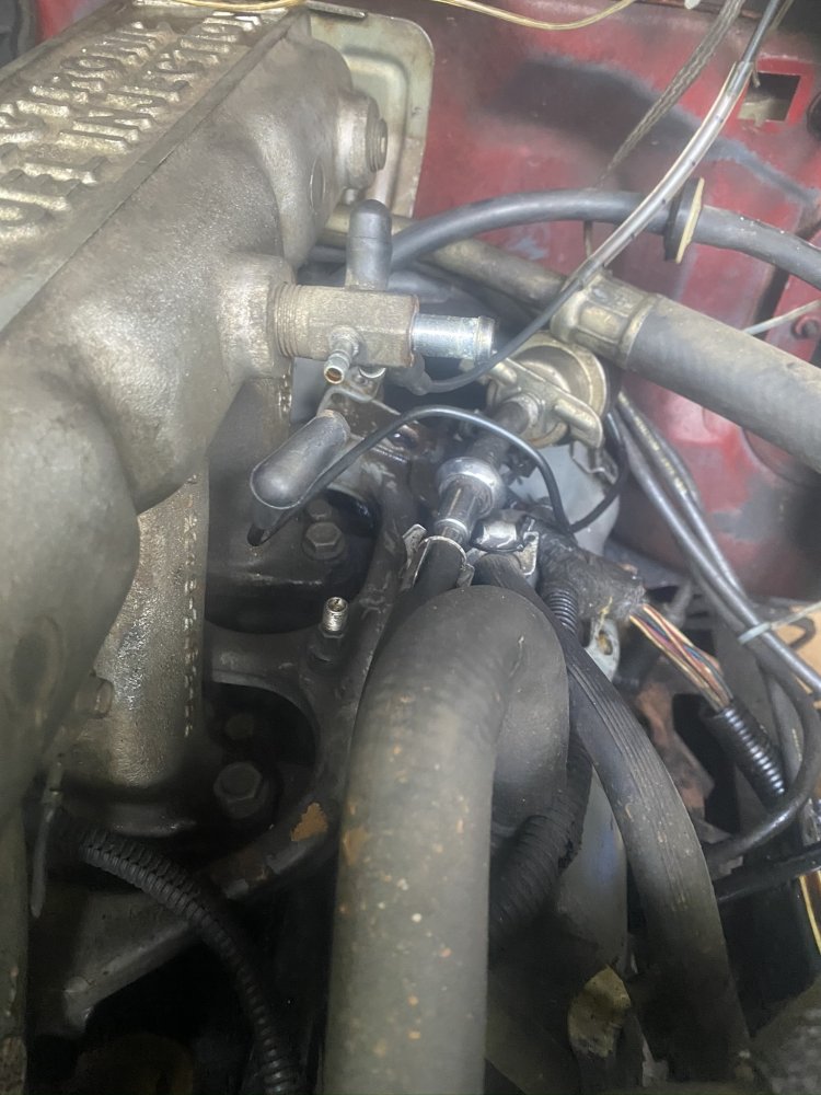

After looking around the engine bay again, what I think is the vacuum line going from the lower air intake to the main air intake was unplugged and the hose was perforated. The attach point at the main intake was plugged with a screw. I hooked them up and as a quick fix, I electrical taped the line as a sealant. Why not?

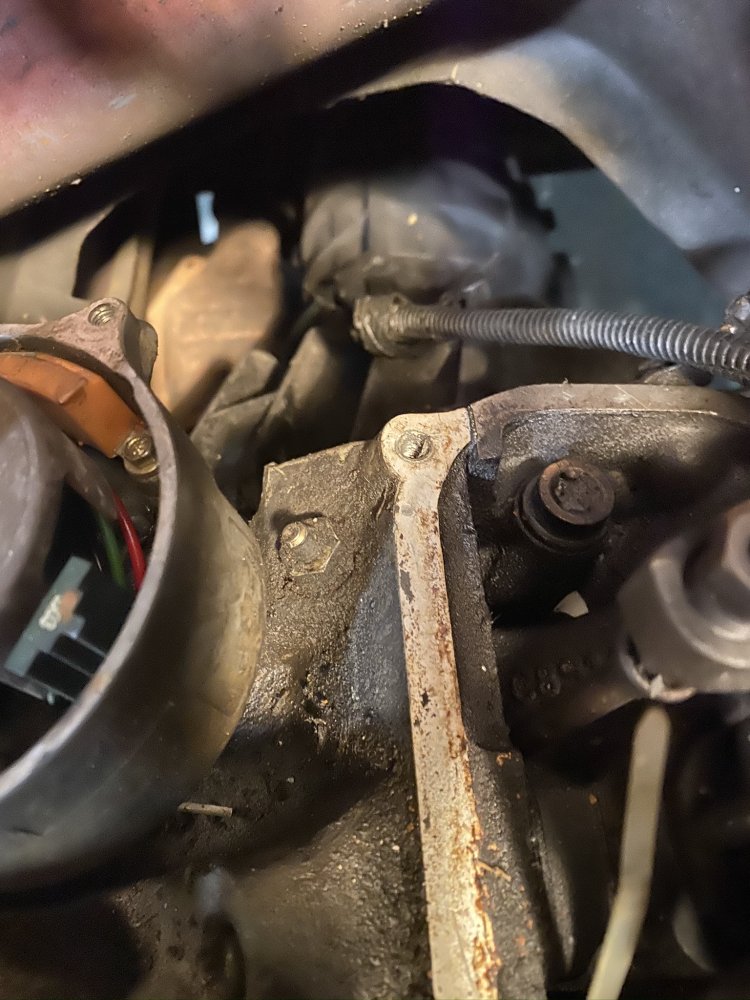

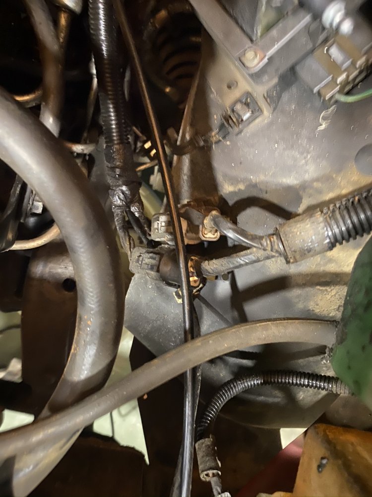

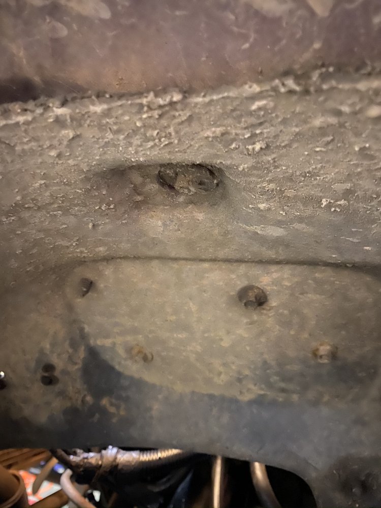

Just checked underneath. Whoever owned the car before completely CUT the lower intake hose to the engine. My guess was an uneducated attempt to bypass it for the aftermarket intake. At least that explains the uncontrollably high idle.
What was left of the intake neck was facing down and filled with dirt. I’m gonna guess I’ve got a crank case full of rocks...
what are the odds i need a new engine?

Due to the newly found hole on the underside of my engine, I've decided to pull the engine in parts with the intent of rebuilding, and create an amateur collection of write ups of the processes.

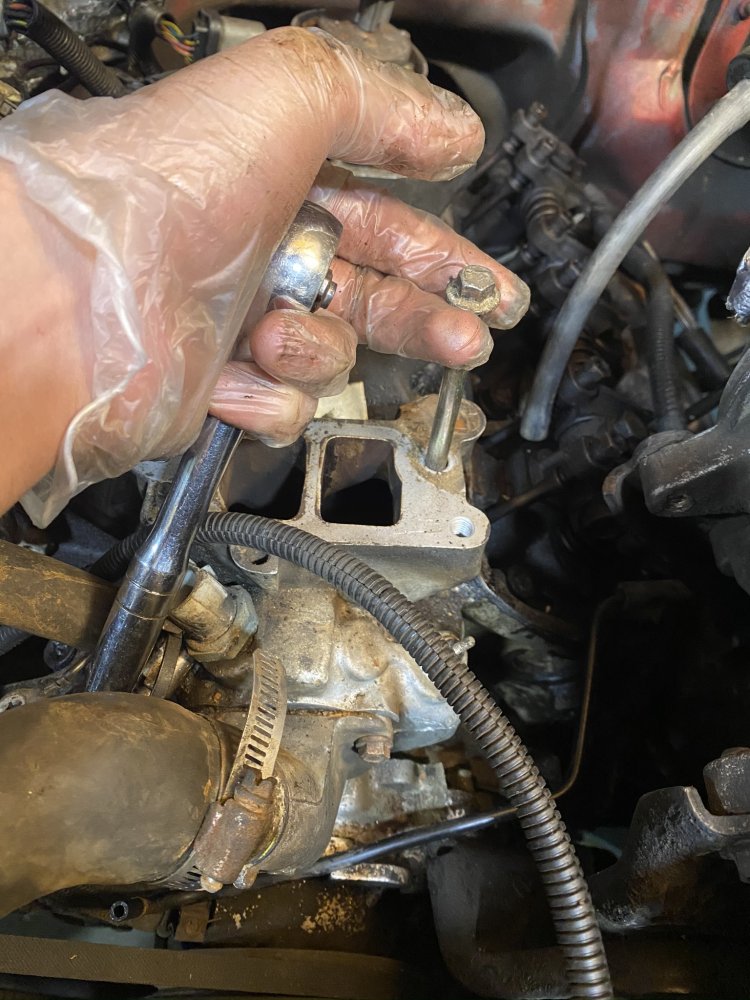

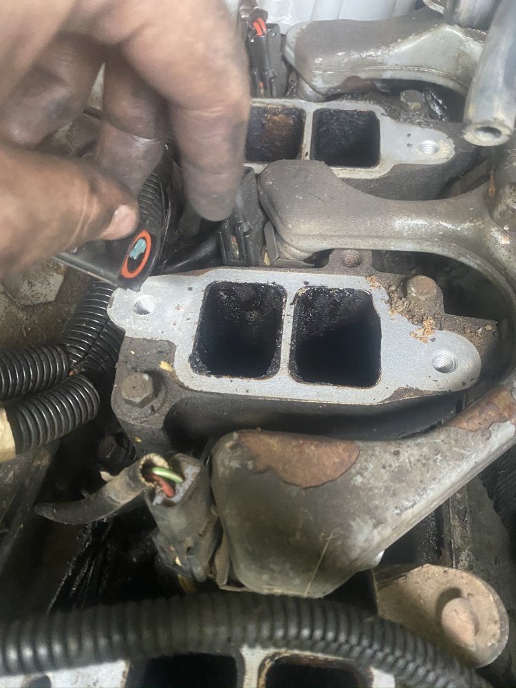

Today: Upper intake manifold
All you should need are 8, 10, 11 mm sockets, and a 6" extension.

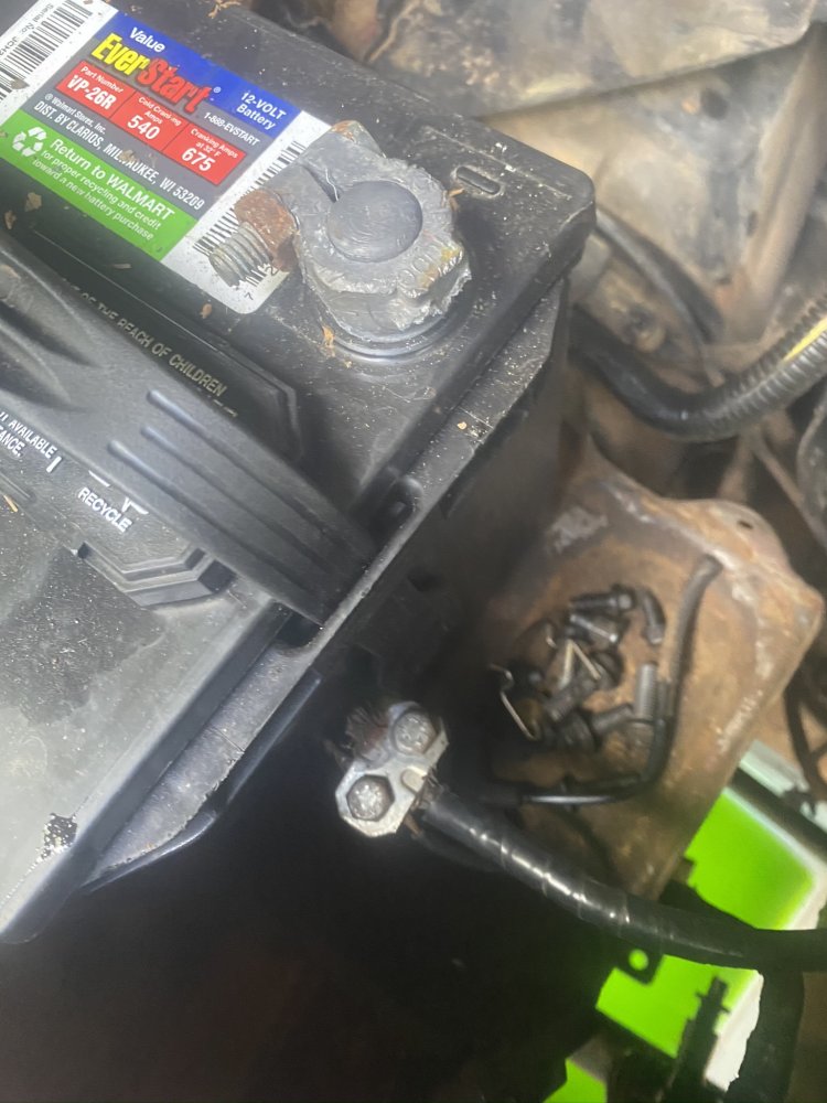

For those having a bad day, here's a laugh. While removing the negative battery cable, I gave it a jiggle a tad too aggressive and boom. One more part to replace. To be fair, it was not in good condition to start... Also, don't forget to bleed your schrader valve. It does well to also drain your coolant but mine leaked out a cracked hose so lucky me! One less thing to do.

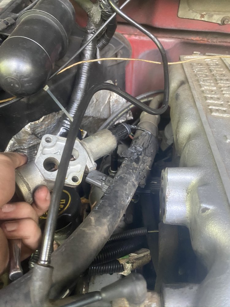

2 bolts will disconnect your idle control valve. I laid it to the side but if you're doing a teardown, it would be prudent to get some colored tape and start labeling the connectors off the bat.

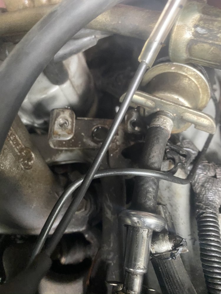

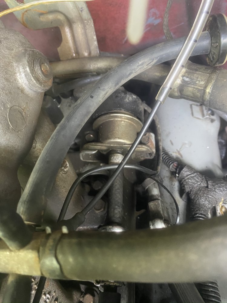

Two more bolts will get the fuel pressure regulator off the fuel rail. You'll have to peel the unit away from the engine to get the rubberized bottom portion out of its mounting point.

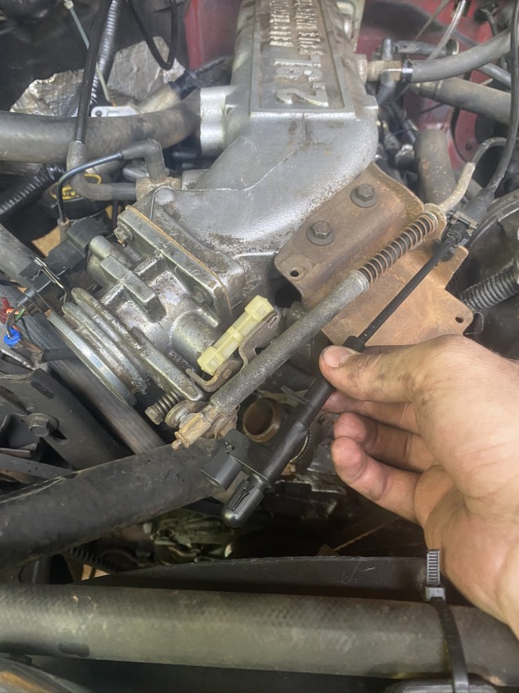

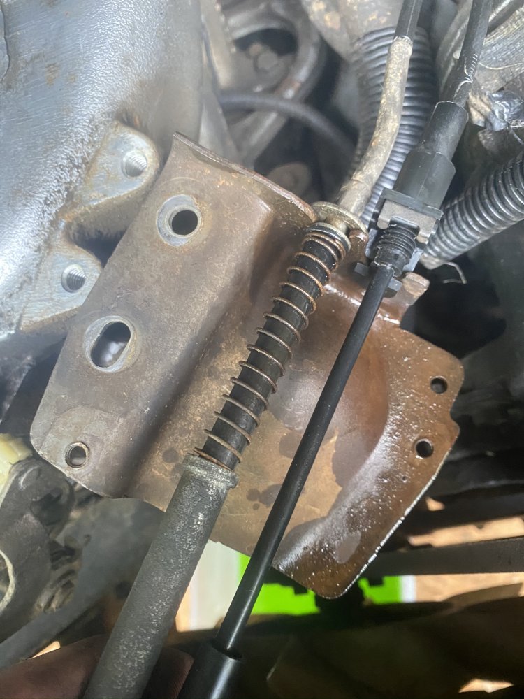

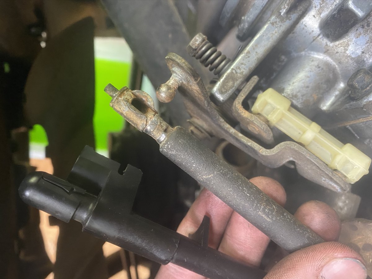

To remove the accelerator cable, first take the snow guard off. Mine was missing but I cant imagine it's very hard.
Take the metal pipe connected to the throttle body and pull it directly away from the plate while lifting either face of the pressure clamp.
If it's old, it'll take some convincing. You dont need to remove the plastic pipe, I just playing around with what I was seeing.
Removing the mounting plate is just 2 bolts. Keep both cables attached to the plate for simplicity.

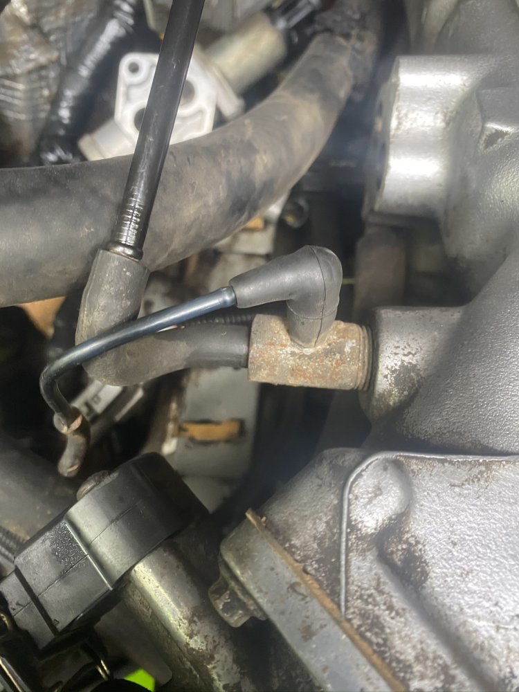

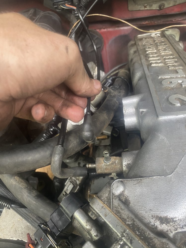

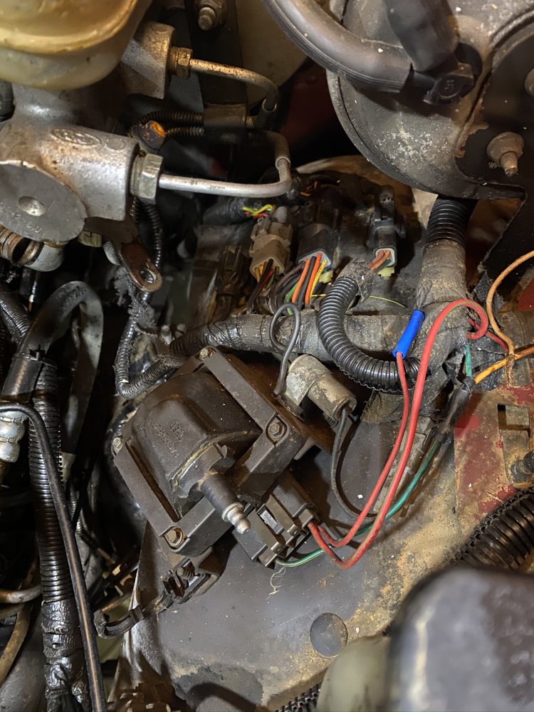

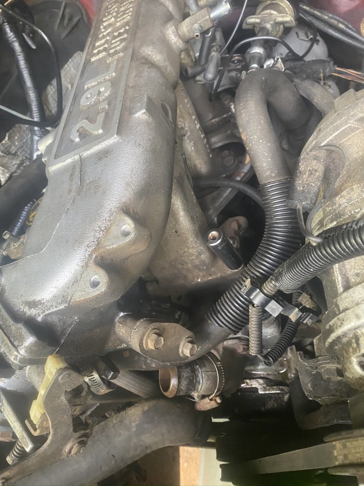

Vacuum hoses up next. Take pictures, label them, or do something or the vacuum system boogie man will get you.
As you can see, the top vacuum hose on the left side of the engine is cut. If anyone knows what that goes to, please chime in before I go digging.

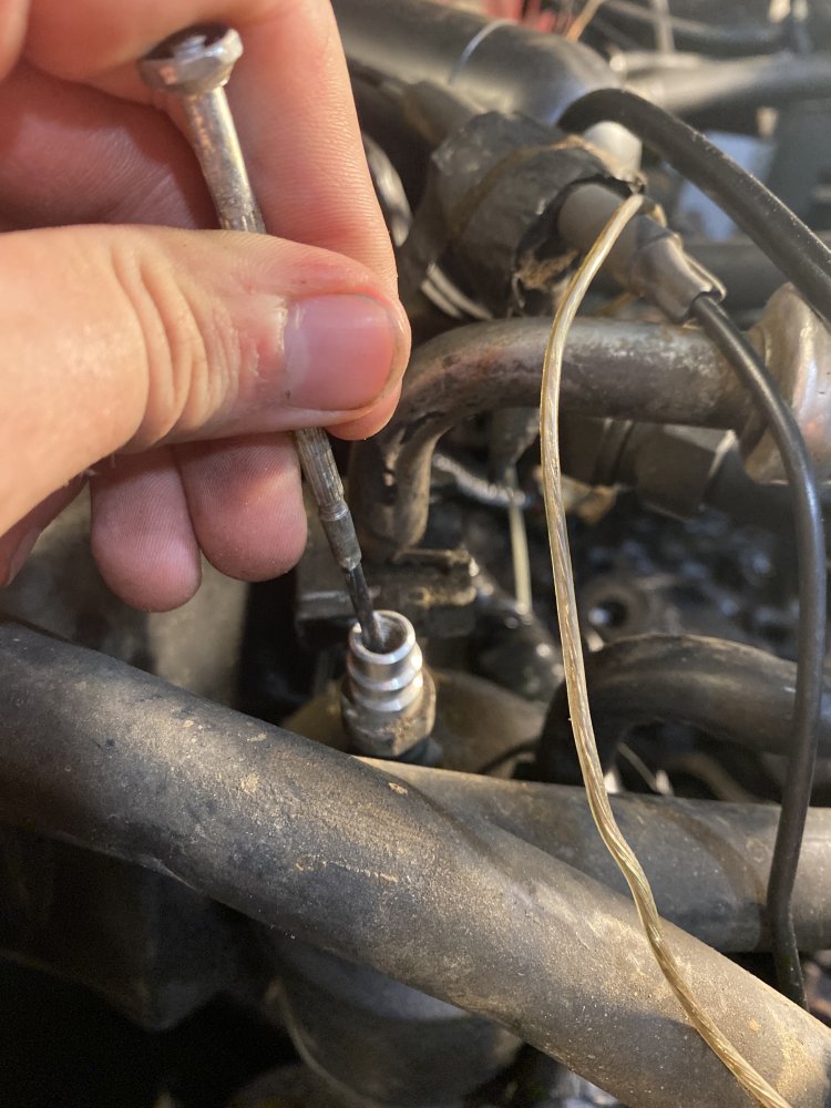

I left the vacuum gauge hook up cap on, cause why not. One less thing to lose.

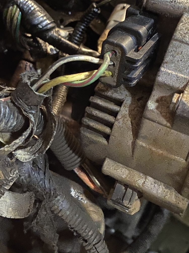

PCV lines next. Further proof of internal work by whats underneath.
47460
47461

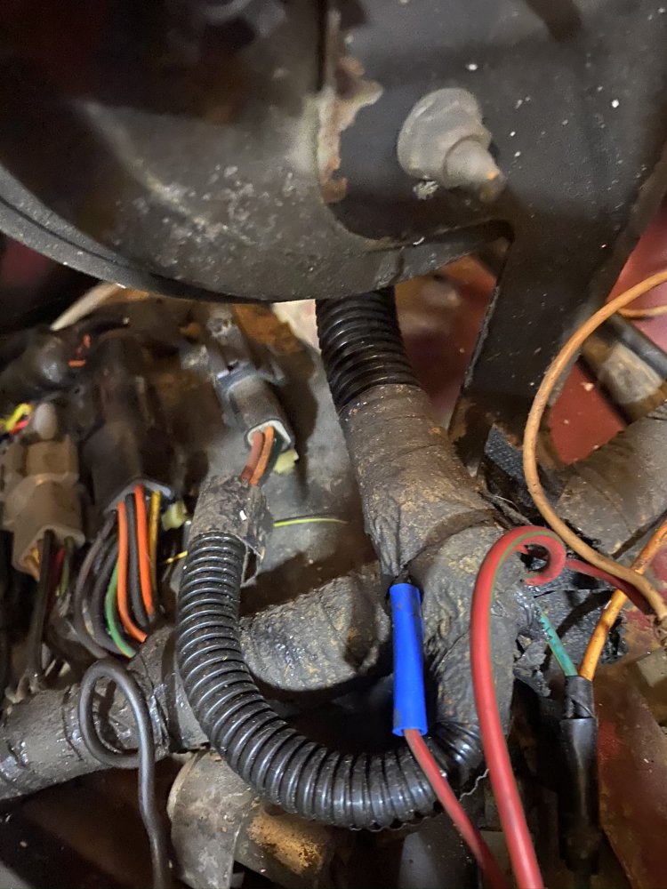

Last little bit of electrics and one worm gear hose clamp by the intake hose on the throttle body
47462
47463
Ground on the plenum.

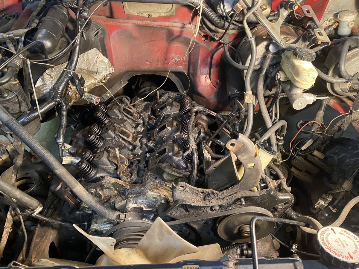

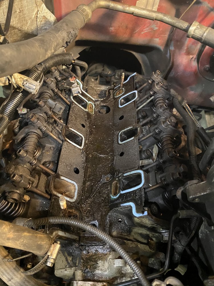

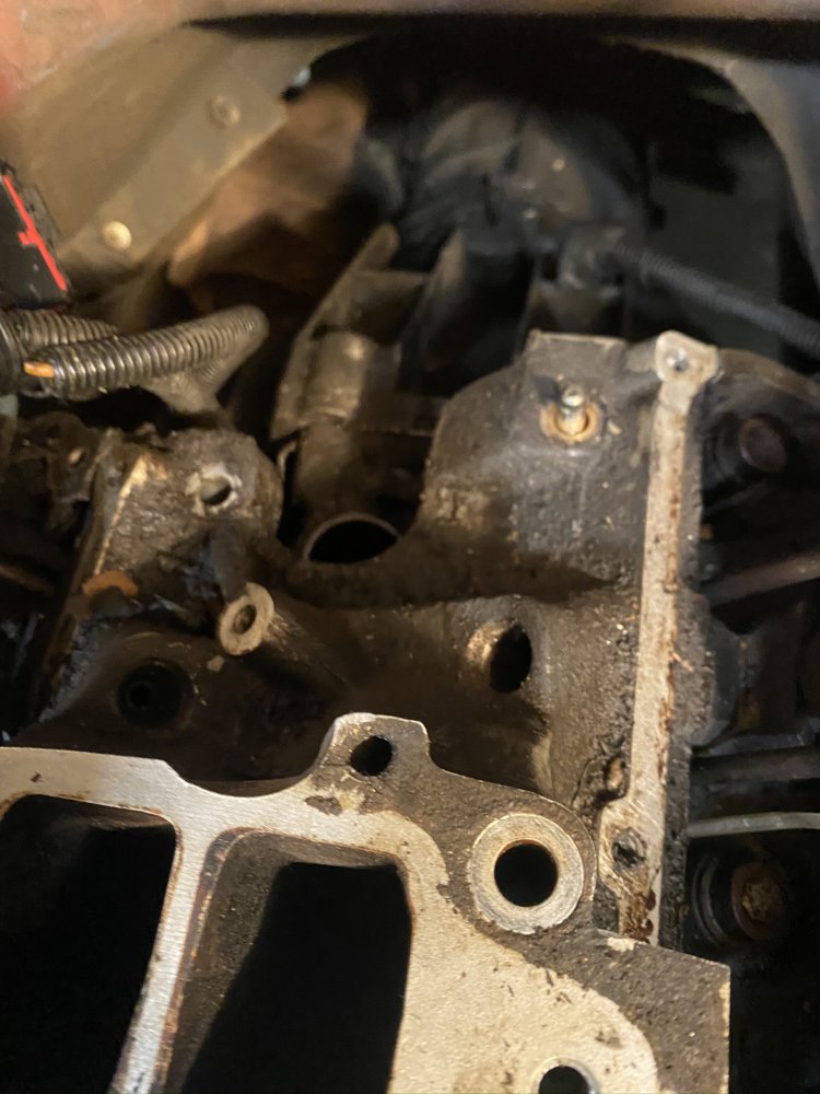

Finally the meat of the subject. 6 bolts, I kept track of the order. I dont know if you need to but I felt I should.
47466
The spoils
47467
But oh dear
47468
What will batman do next? Find out next time.

Also, pretty sure the cut vac line runs back to MAP sensor.

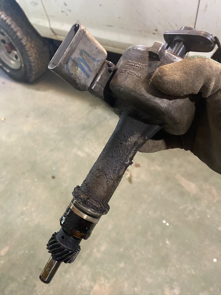

Distributor was a pain, removing the securing bolt wasn't easy as I don't have small ratchets. It didn't want to come out so I spent a solid 15 minutes twisting it. You should mark the spinner for timing purposes but since my cam and crank are coming out, I'll wait till reassembly and check the Chilton's. There's a nut securing the manifold just by the distributor as well as the front left instead of a bolt

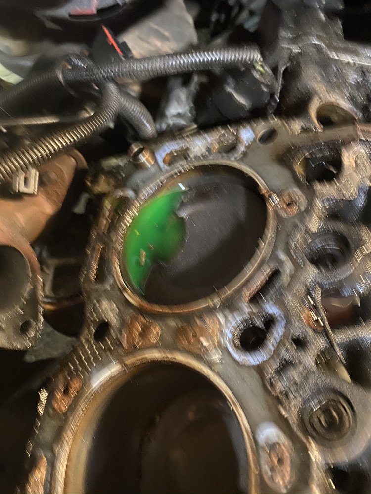

Couple whacks with a rubber mallet and voila! More spoils.
49105
...gross...
49106
49107

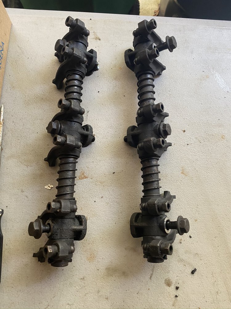

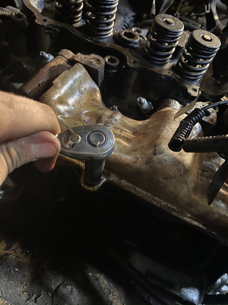

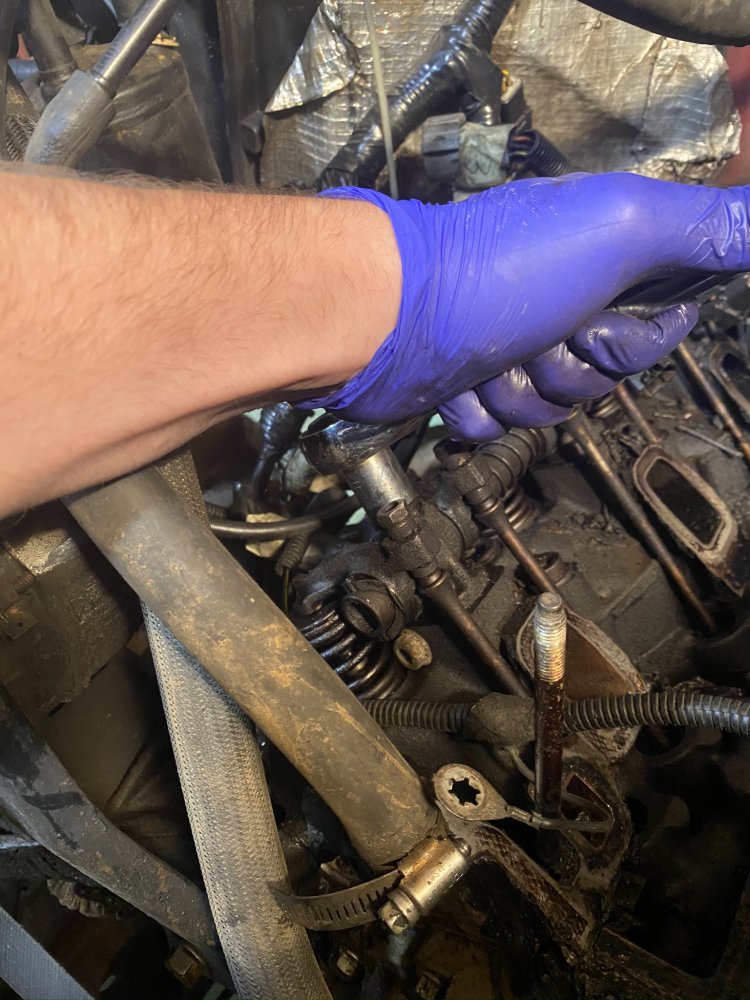

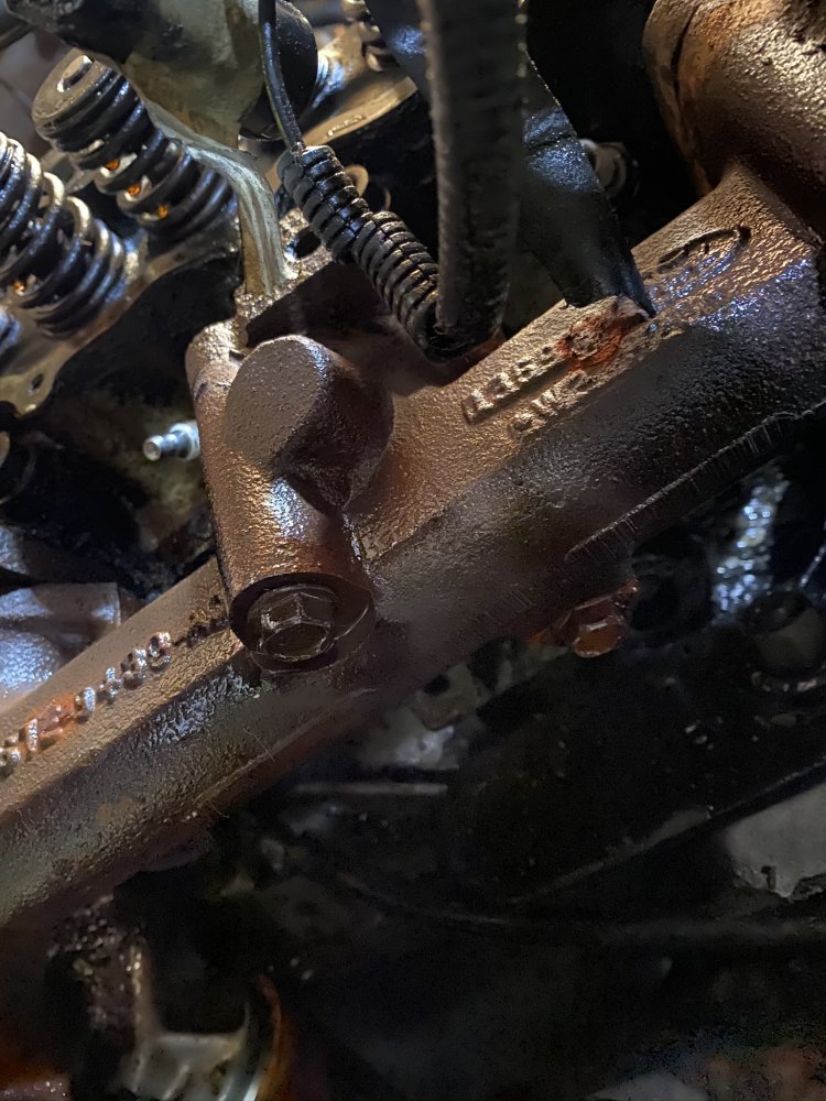

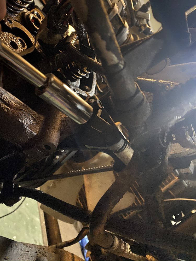

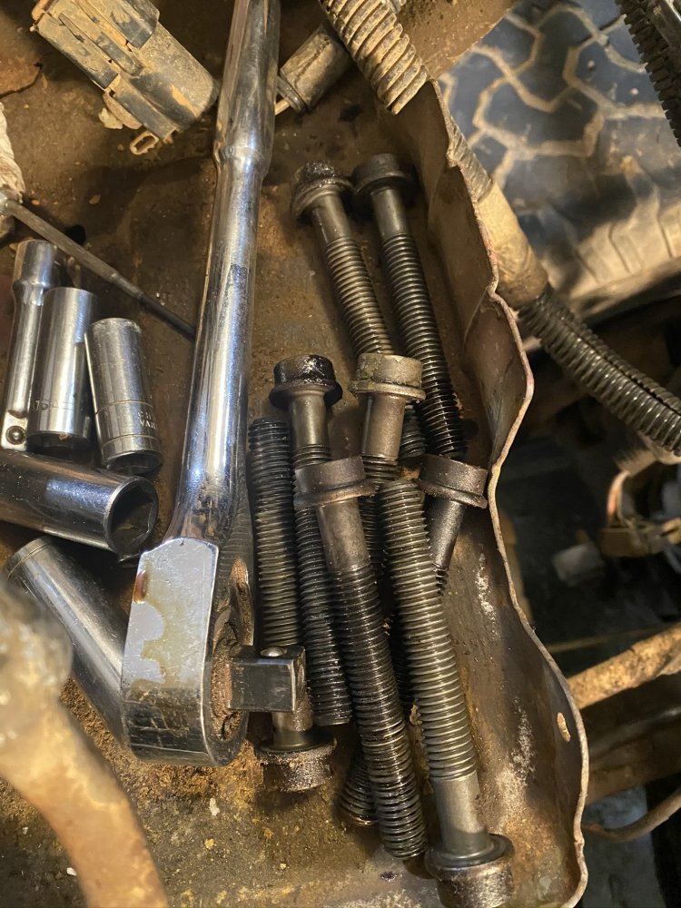

Definitely have a wrench with a decent radius for the 6 rocker bolts or you'll hate yourself. Make sure to turn all of them uniformly as to not distribute pressure unevenly during removal.
49108
And they're off!

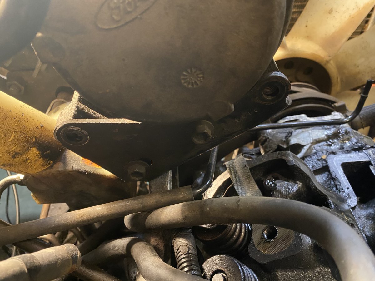

Passenger side exhaust manifold has a heat cover, 2 11mm bolts IIRC
49115

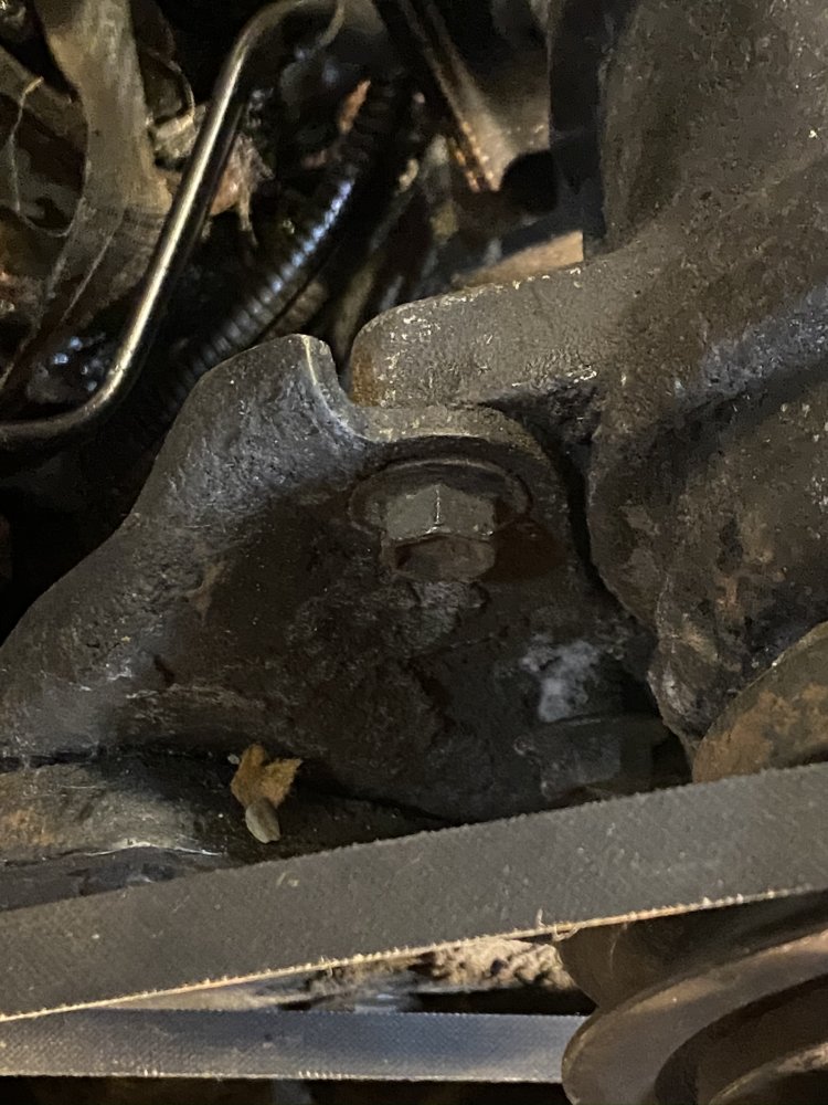

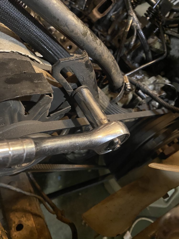

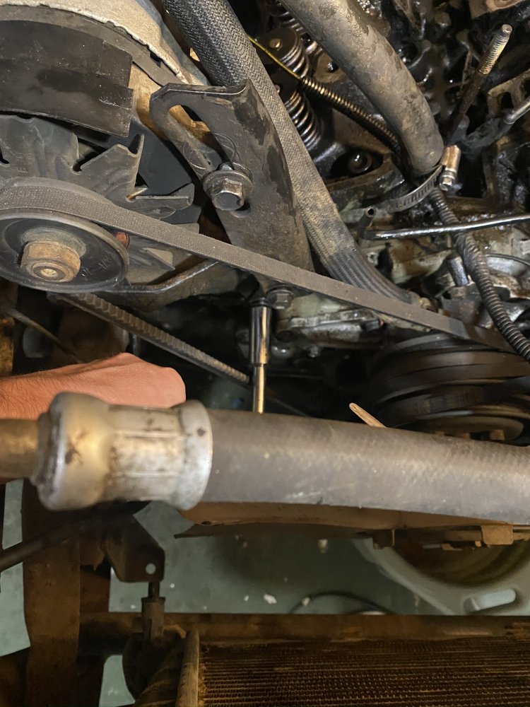

Many hidden bolts and connectors on the power steering/alternator brackets. Missing a few
index.php
49117
49118
49119
49120
49121
49122
49123
49124

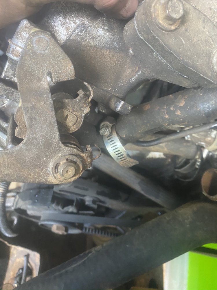

The nut holding the power steering pump hose was stripped so I eventually took a bolt cutter to it. What's one more thing to replace...
I eventually got the remaining mount brackets off but I forgot to snap pictures of the bolts and use of the pulley puller.

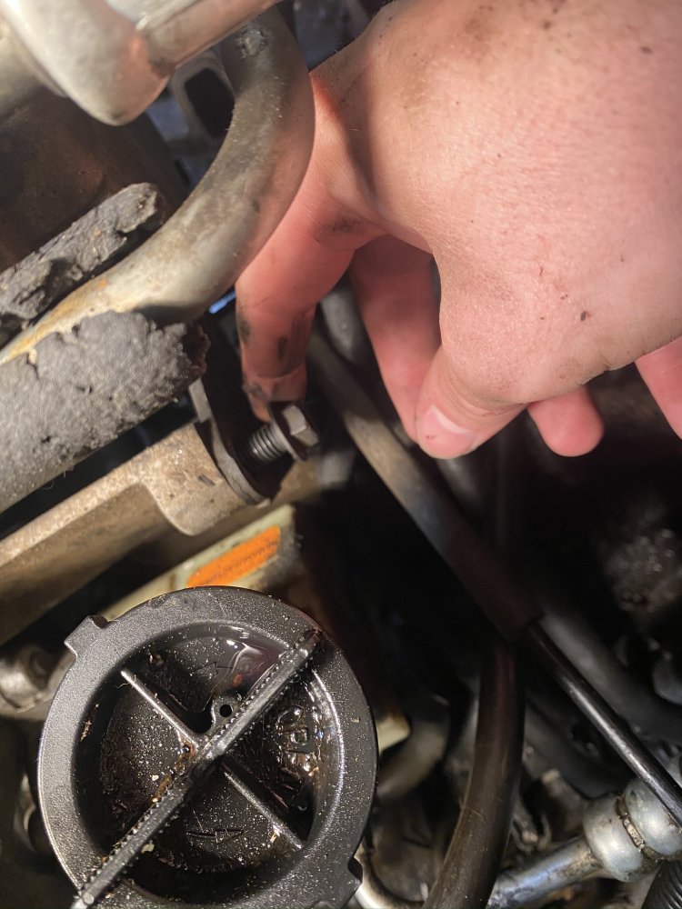

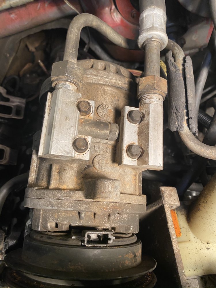

4 bolts connect the compressor
49125

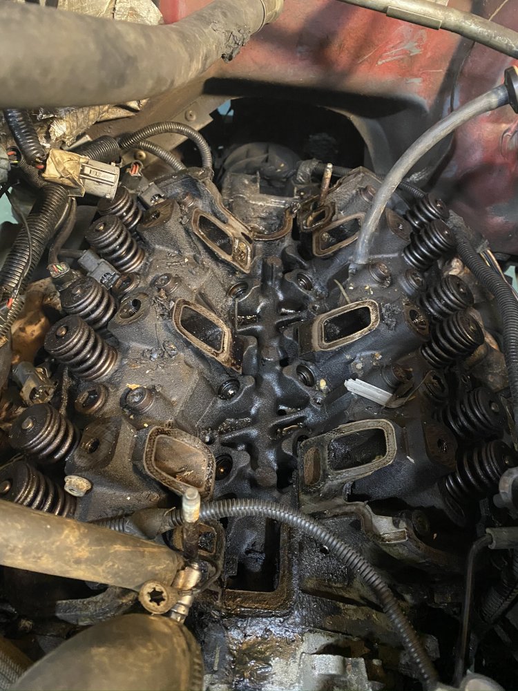

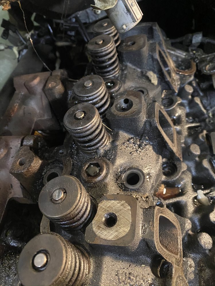

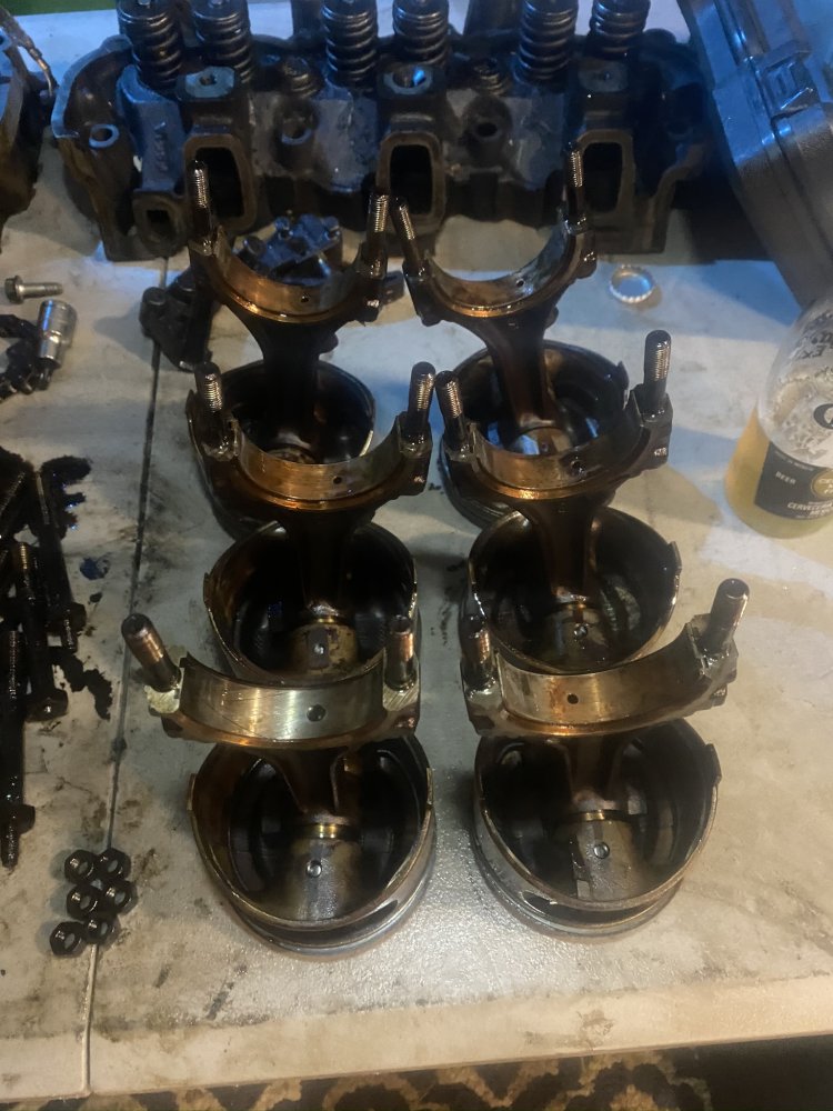

I got kinda excited about getting the heads off so I didn't snap any pictures of the removal but they're T55 torx bits.
49129
49130

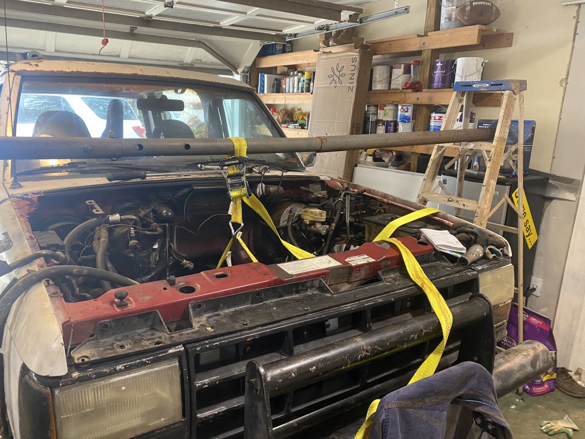

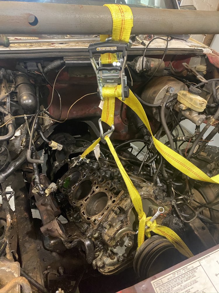

Was too cheap to rent a engine hoist so we went full backwater-India mode. Might as well have worn flip flops.
49134

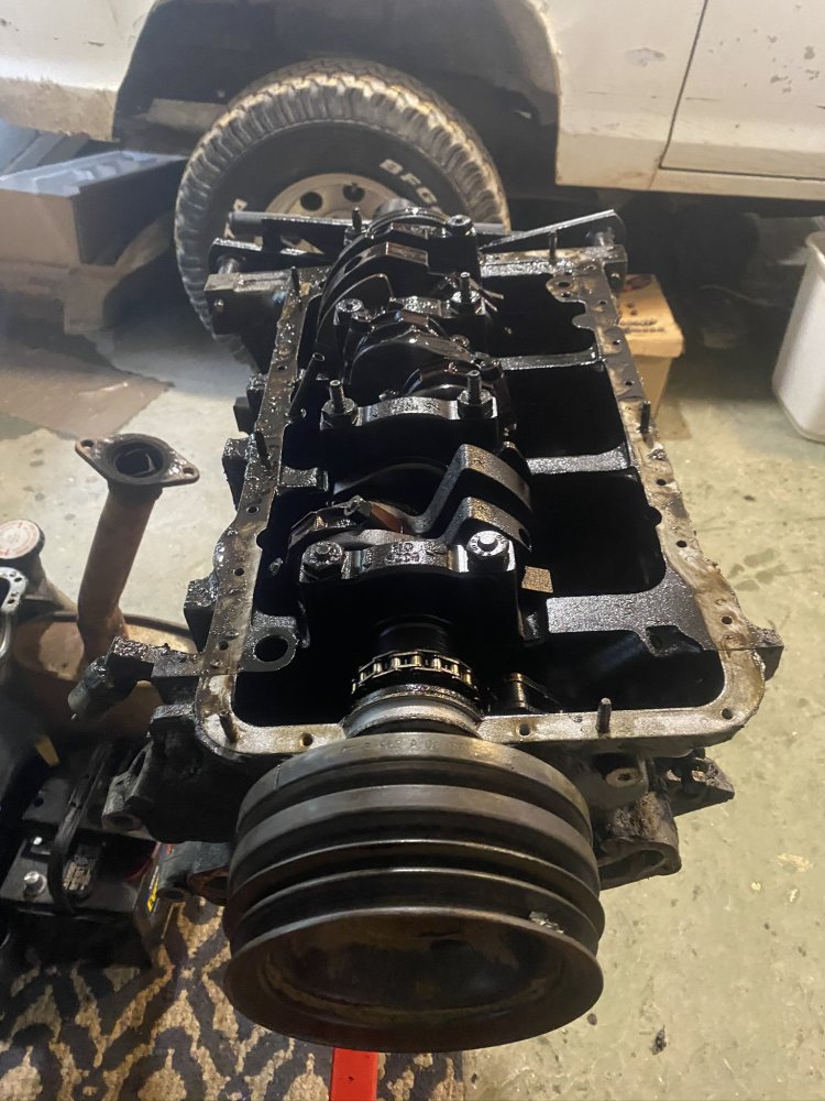

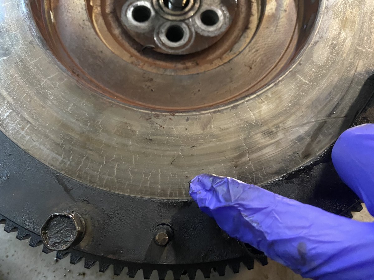

Once it was out, took the clutch off. Lovely cracks on the flywheel.
49135

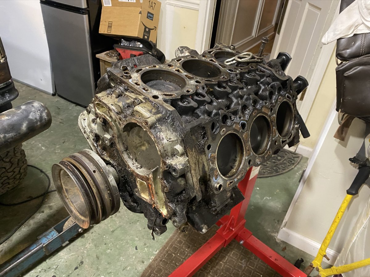

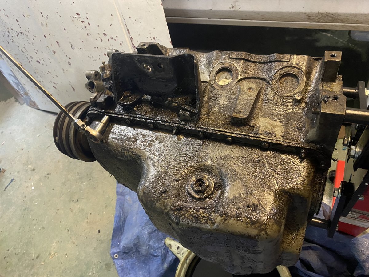

But hey! there's a short block!
49137

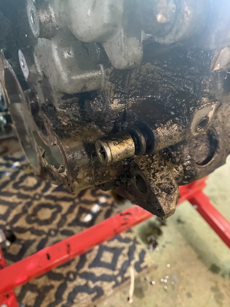

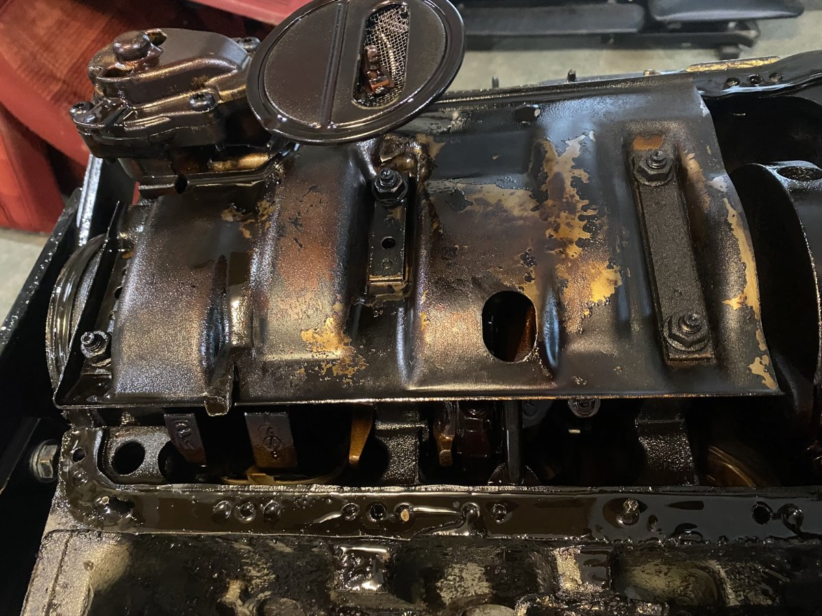

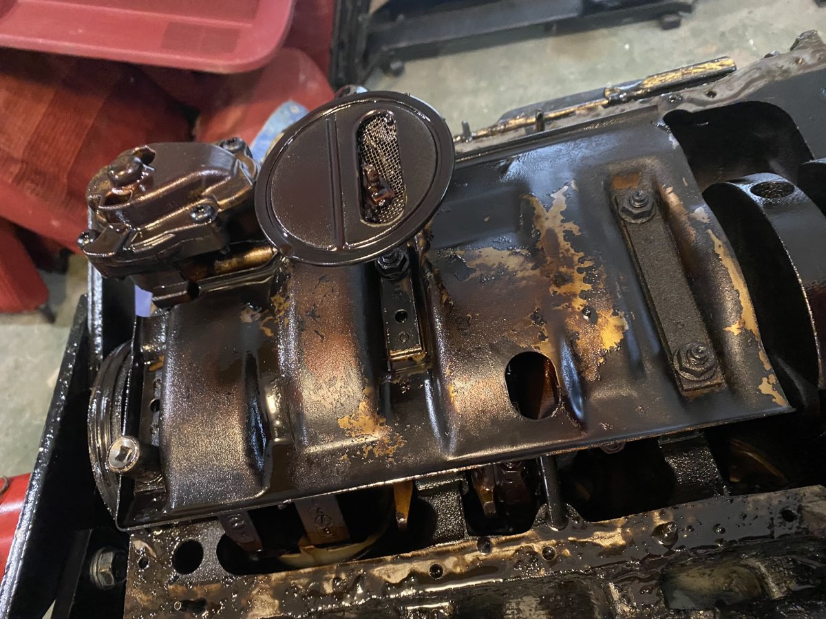

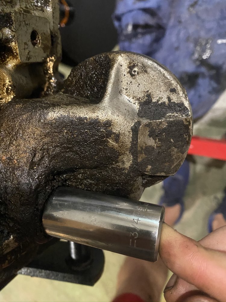

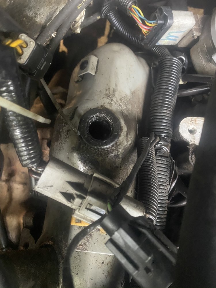

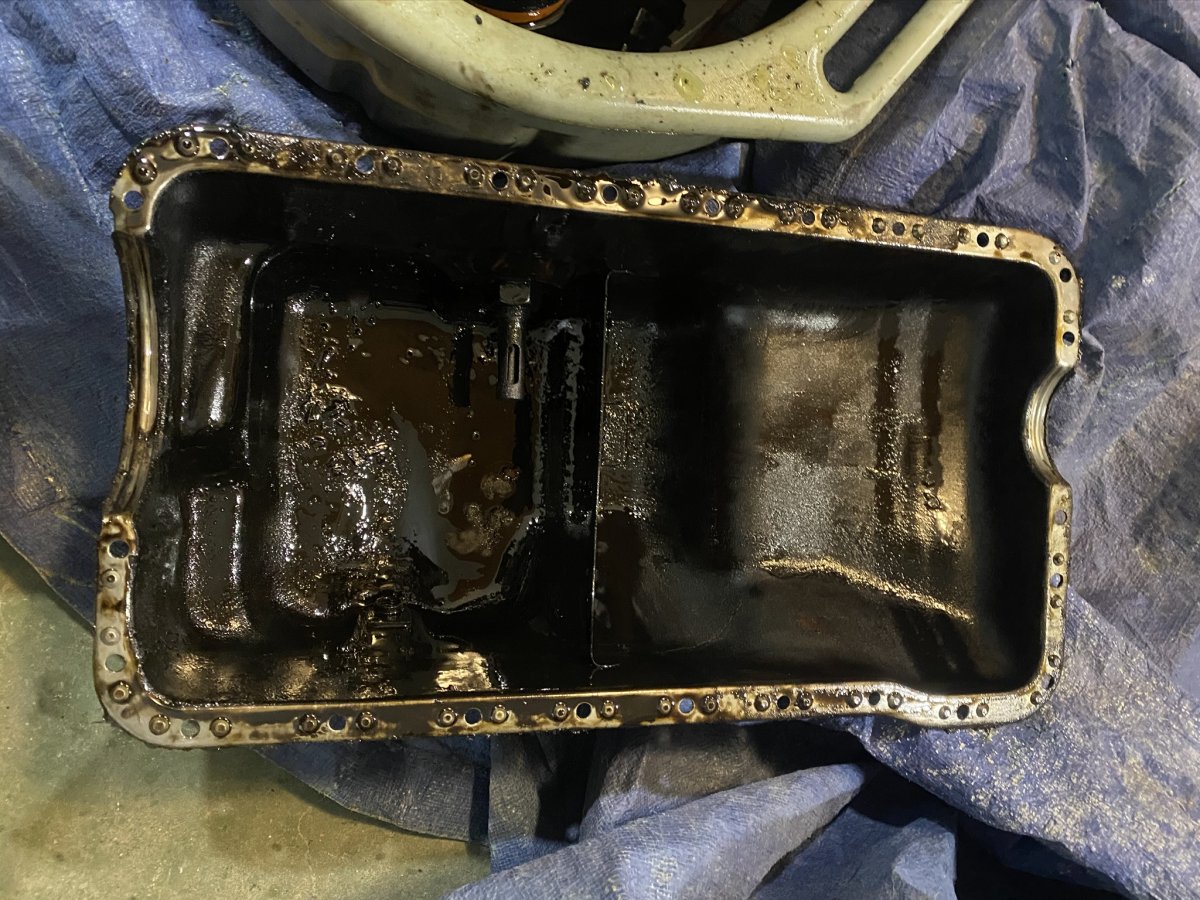

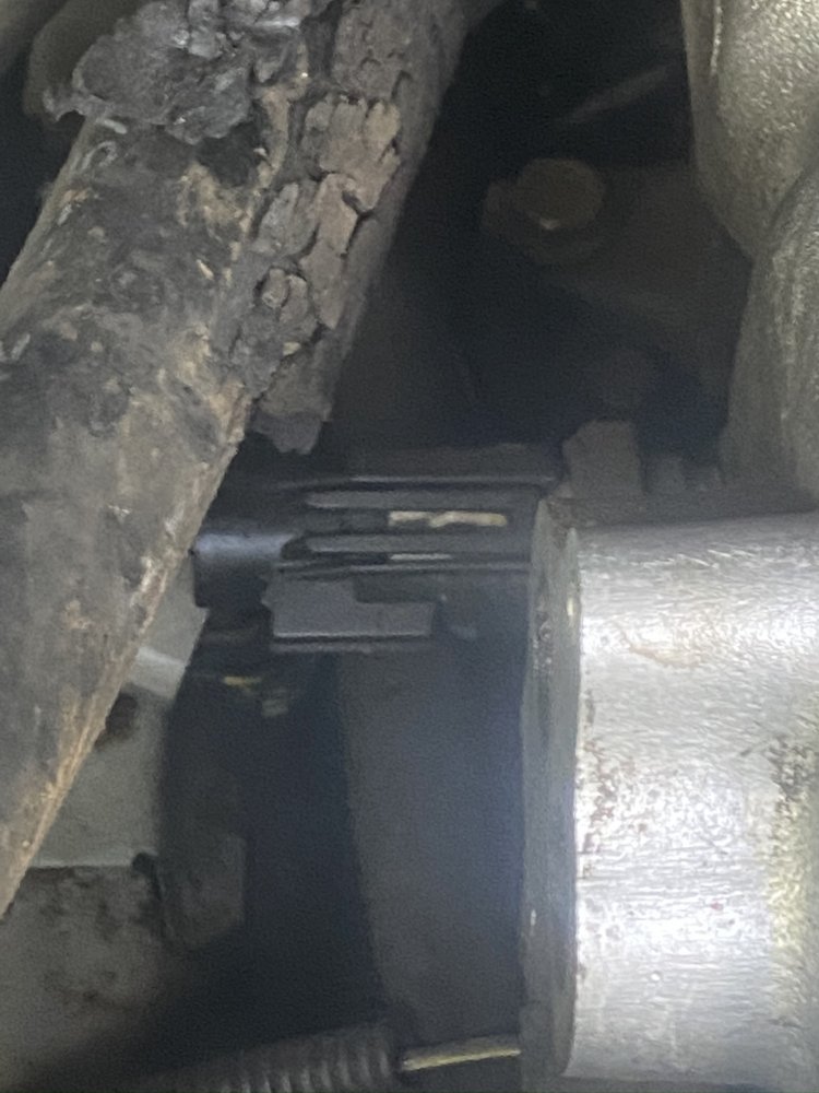

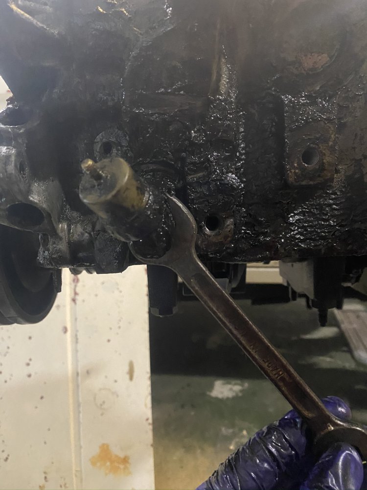

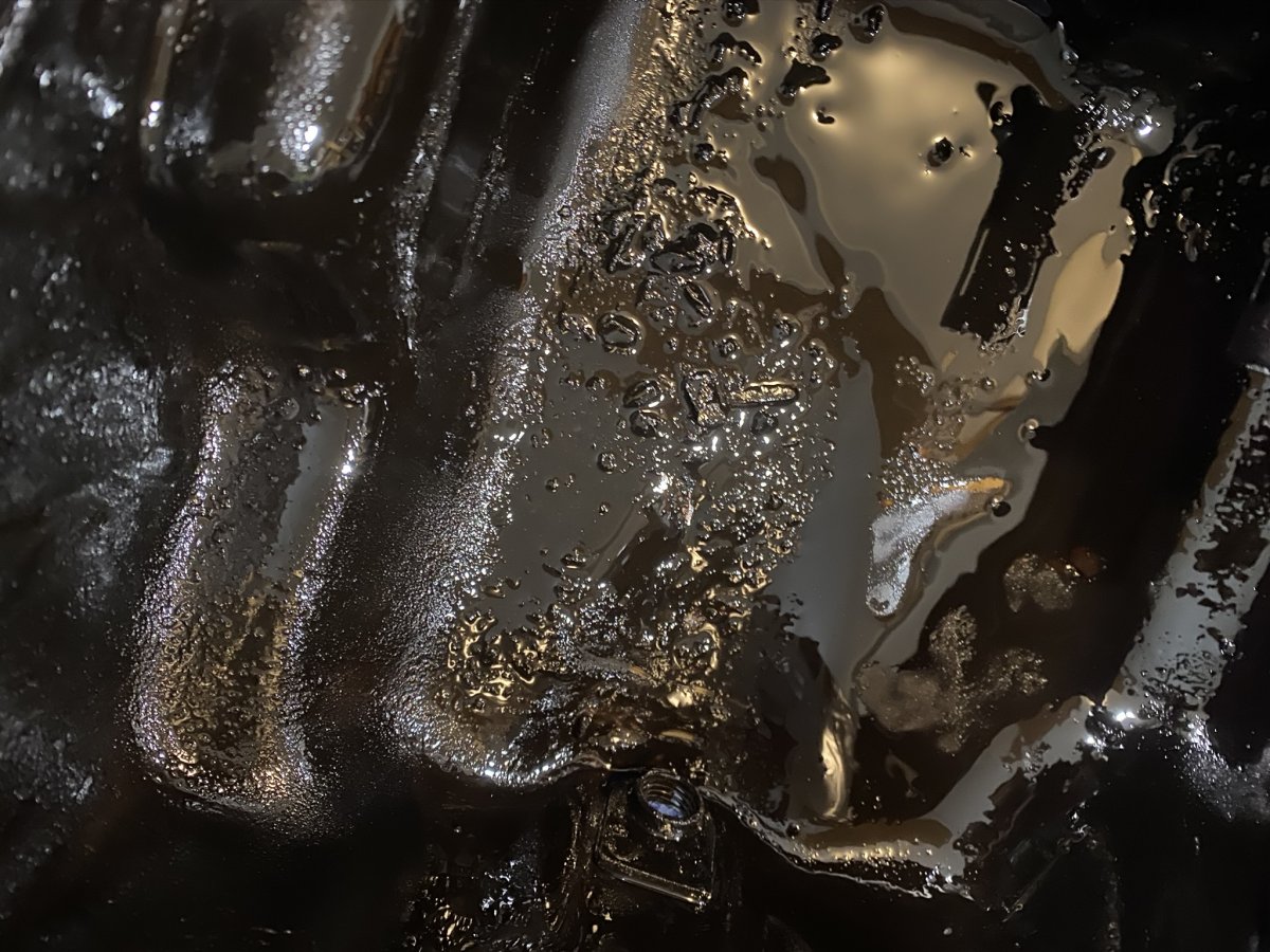

Anyone know what this on the side of the oil pan is for?
49138
To those who have done the oil pan gasket with the engine in the car and no lift... you are braver than I. Cant imagine how difficult that must be. Not TOO much crap in the pan, honestly better than I expected.
49139
49140

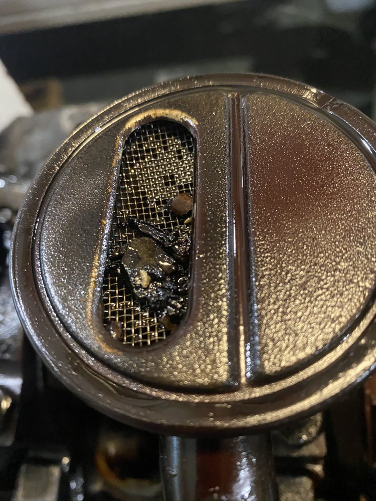

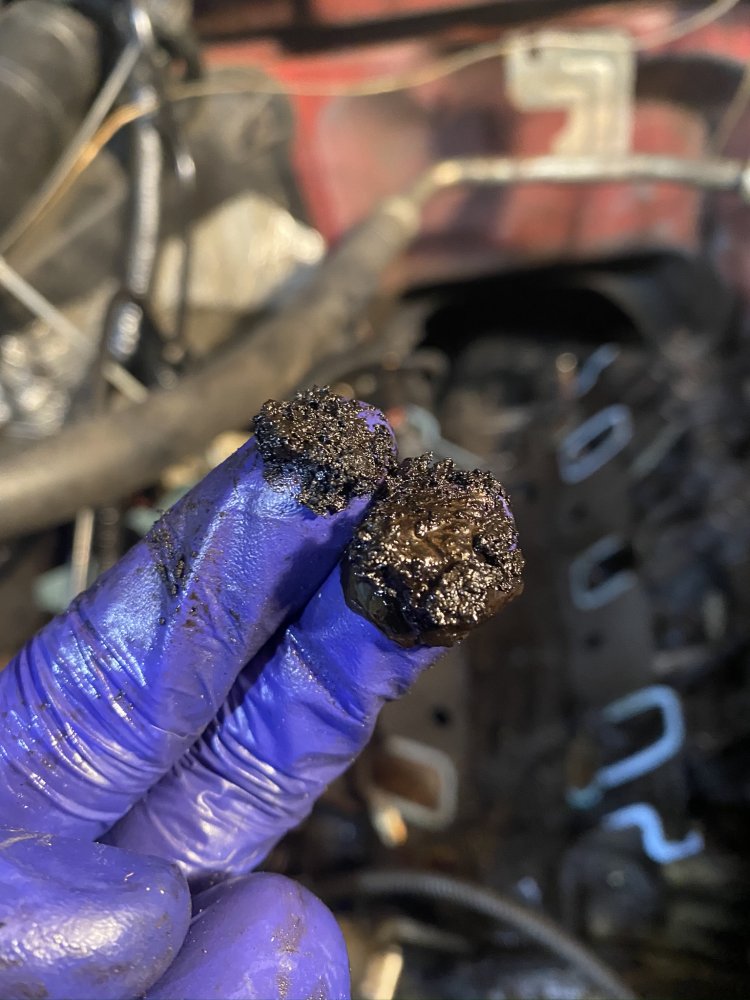

But then.... slapped the filter a few times and this shook out.
49141

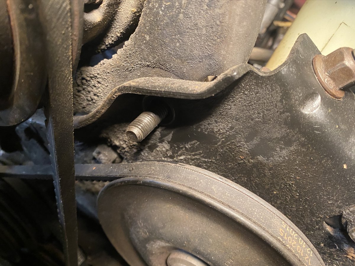

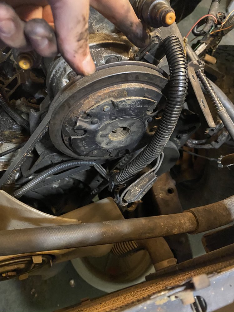

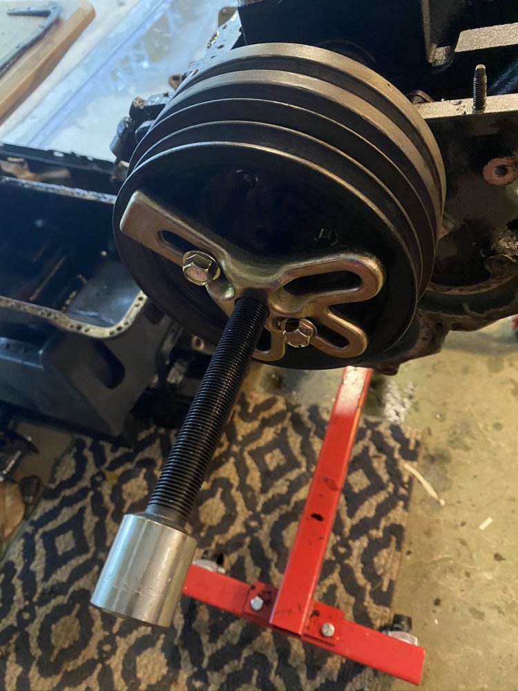

Pulley wasn't as hard as I thought. Wedged a wrench between a flywheel and bellhousing bolt to isolate the spin and it popped right off.
49147

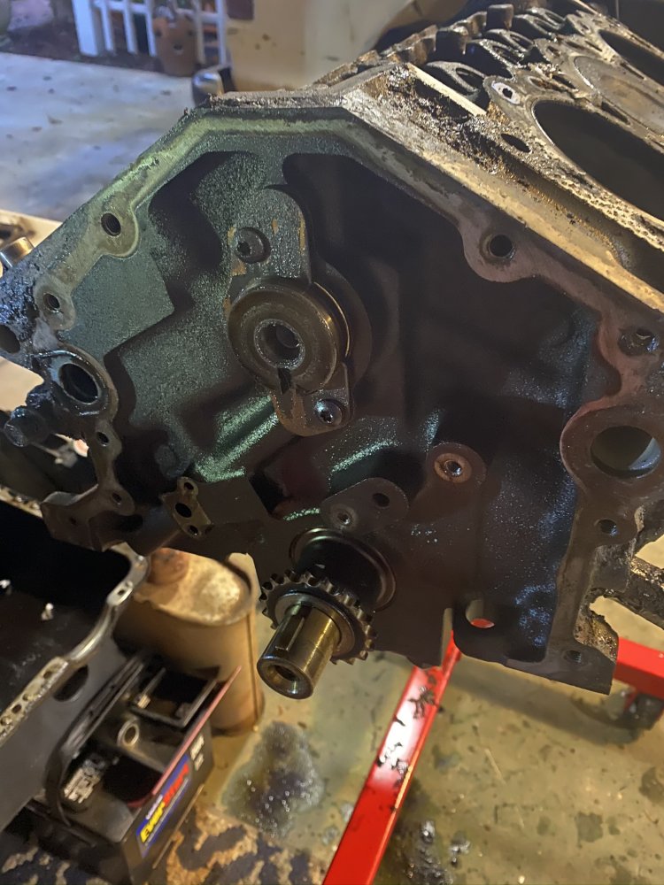

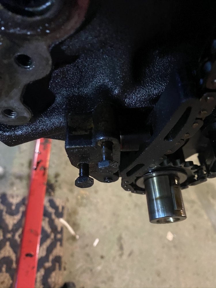

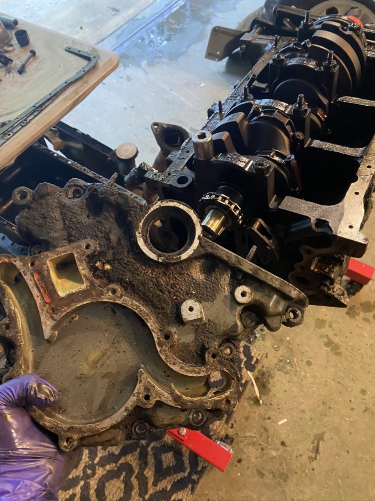

13mm to get the front cover off, and there's the timing chain
49150
49149

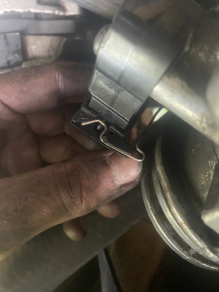

10mm to get the tensioner off. Oh boy do I feel confident in my vehicle knowing that's made of plastic.
49151

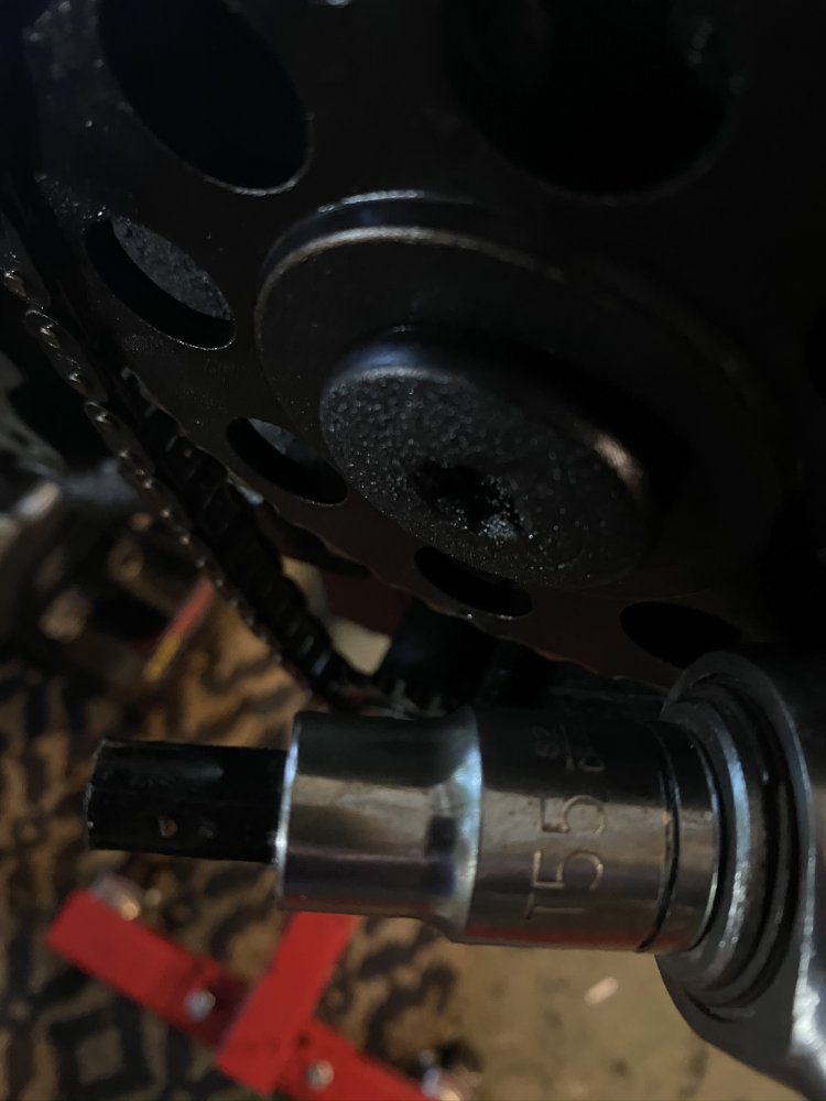

Same torx size as the heads gets the chain off from the cam.
49152

Got a little excited so no removal pics but...
49155
49154

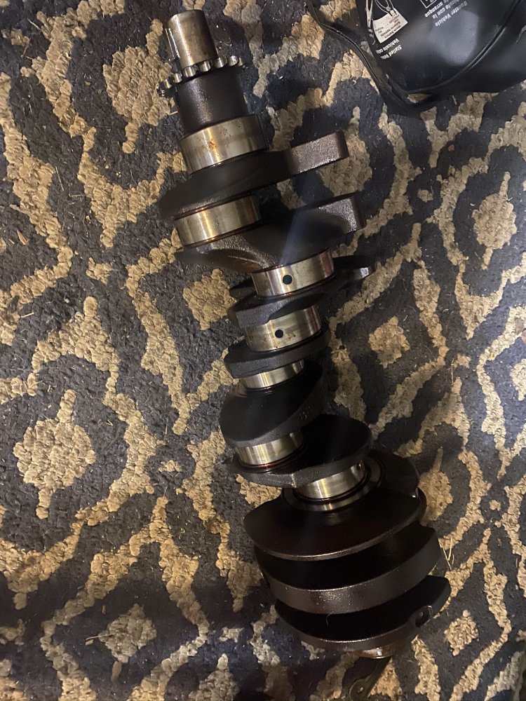

Finally. despite the cam still being in due to the PB blaster still doing it's work on the plate bolts, I'd say part 1 of 100 of the car is done.
49156
49157

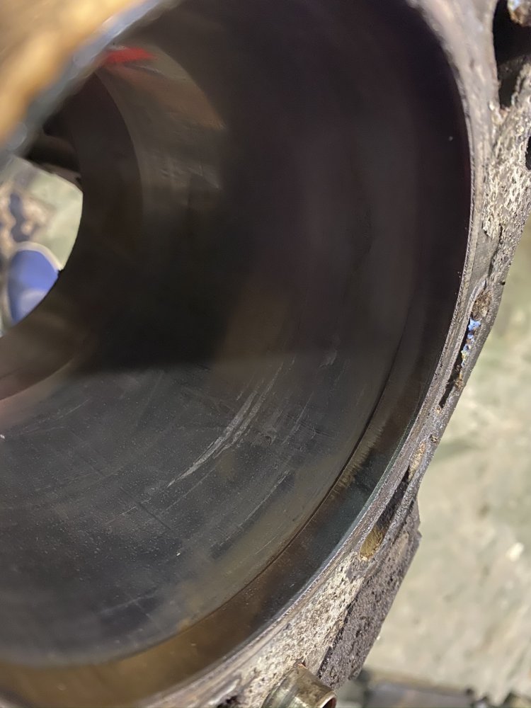

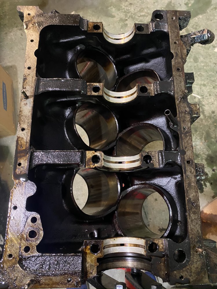

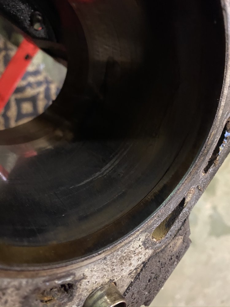

Upon inspection, there's some mild scoring going horizontal. Nothing to catch a fingernail but I can feel something. Any ideas? I read on a porsche forum this can be caused by a vehicle sitting too long, which it has for over a year prior to me getting it.
49160
Also, there's a noticeable ridge at the top of the cylinders. Is that normal?
49159
49158
Up next. DIY hot tank and a trip to the machinist for professional inspection.

The "thing" on the side of the pan is for the low oil level sensor
