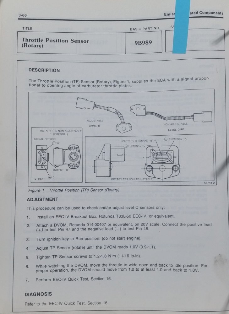

From what I've read in Ford manuals, that screw (throttle plate stop screw) is only for adjusting the curb idle at the factory (and has nothing to do with adjusting the TPS). It's not advised to adjust it as it is not as simple a procedure as turning an idle screw on a carburetor (see the page below for the procedure). The TPS is adjusted automatically by the ECM. I suspect that if you moved that screw you may have to clear the ECM so it could re-calibrate the TPS (but maybe not).
As the Engine/Emissions Diagnostic Manual shows, only a type C TPS is made to be adjustable, and the 2.9's don't have a type C TPS. Again, the ECM does all the adjustment. I've read here on these forums that some people advocate slotting the stock 2.9 TPS to "adjust" it, but I don't see how this is doing any good without disabling the ECM's programming to adjust it automatically.
The computer considers the throttle closed when the tps reads anywhere from .59v to 1.22v. So long as you are in that range, it's good. This is what the computer uses to put the engine in a idle fuel strategy, and also for a deceleration strategy when you lift off the throttle at speed going down the road. So what some of the others are saying, if you turn the screw so the TPS is not sending the correct voltage at idle, it will tend to mess it up.
