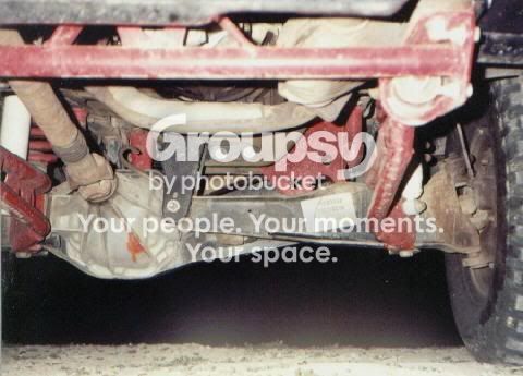

does anyone have pics or can explain what part of the drop plates put holes in the dana 35 pig? i know they do it, i would just like a pic of how it does it or whatever. i havent put my lift on yet so thats probably why it dont make sense
nope, get the sky jacker brackets, you can buy just that bracket if you want, they run $300+ i think.
I've seen guys cut the offending part of the bracket off, although this will weaken it if you don't take steps to reinforce it afterward.
I would get a different bracket (best) or lower your bumpstops so the travel is cut short before it hits.
Skyjacker:
$300 I think is for both brackets. Just the one I'd guess is $100-150 (I think you can get just the one anyway... of course the other one is pure beef compared to RC's bracket, couldn't hurt to get the pair)
