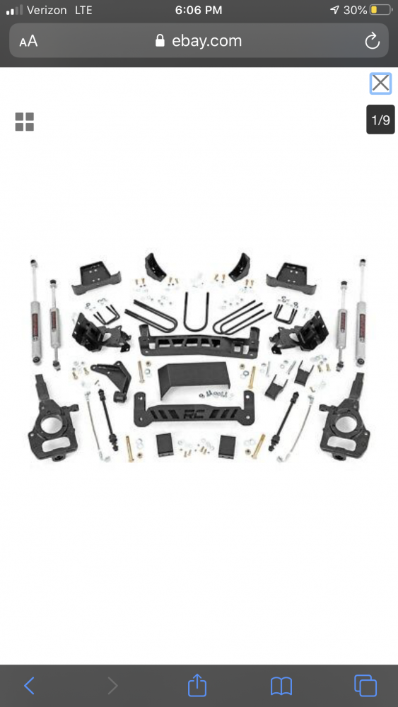

Does anyone know what “minor cutting” is required for this kit? I’m debating on wether to get this kit or the super lift kit.... any help is greatly appreciated.

Did you download the instructions and read the part about where to cut?
I did read thru the instructions and they are very informative... the only mention of a “cut” is clearance for the torsion tool.... just wanted to see if anyone had first hand experience with this specific issue... I’ve always used a 2 jaw puller or something similar to do my bars...

Cutting really is just for tool clearance, it’s not much, it’s not near anything scary or anything. If you have an angle grinder you’ll be fine. I would probably recommend getting their torsion bar tool though.

Man I appreciate your input, my biggest concern was the “cutting” that was involved, which isn’t a huge deal if clearance is all it is.

On most IFS front suspension lifts you have to cut the driver lower A-arm mount off to make room for the diff after it is lowered from factory position.

This is correct. You will have to make a small notch on your driver side lower control arm mount. The rear mount to be exact. I just recently installed the RC kit myself in my backyard on my 2000 Ranger. The cutting that they mention is necessary so your front diff drop bracket fits. I used a sawzall and made small straight cuts parallel to each other, then pulled them all off with pliers.
Hope this helps.
