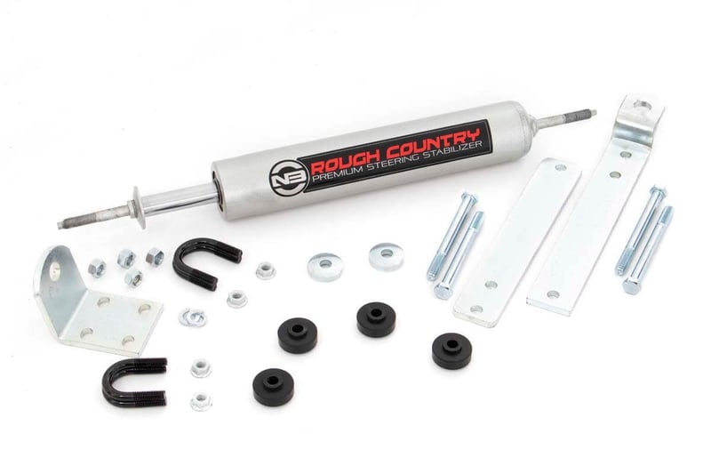

I’ve got a 1997 Ranger with a 4 inch lift and 33’s. I put a rough country steering stabilizer on it which helps tremendously but I’m having trouble with keeping a bushing on the one end. The bracket on the frame side is fine but the other bracket that bolts to the drag link is factory bent on a 45 degree angle. This puts the bushing in a ton of stress. I’m actually on my second one because the first one had the bushing fail and it let the nut come loose and ended up bending the stabilizer. I ordered a set of poly bushings which has helped but I still can’t figure out why that bracket comes from the factory bent like it is. I know I could just take it off and attempt to bend it straight but this stabilizer is application specific for my 97 TTB. Anyone else have this problem?

That said, if you still wish to keep the stabilizer, then your best bet is to just bend that bracket so that it sits straighter.

My 4 inch lift came with a drop pitman arm. The stabilizer was added mainly because my gearbox has some play in it and the stabilizer helped out tremendously. I think I’m just gonna need to take the bracket off and bend it a little to straighten the alignment on the stabilizer bushings. Thanks for all your input!
Sounds like a new/rebuilt steering gear is in order. It's a near-guarantee though, your dropped arm is also a part of the problem too if it's the one that came with your (I assume Rough Country) kit (did you read that link?)
