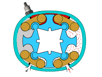

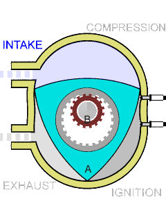

However, if you really want the challenge and have the money, go for it. Great contraptions and people arose from failure and adversity, and better designs have been produced as a result. Besides, what other "piston" in a motor can move/spin once and have the crank move 3 times?
Inspiration:
