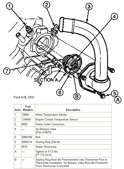

As for the coolant temperature sensor.....it seems I have two of these though and both of them have two wires coming into them. One is located near the front of the engine underneath the throttle body, and the other is located on the drivers' side of the block, much more accessible on top of the block, back near the firewall on driver's side.
Thoughts on this? I guess I could pull them both out and see what they look like. Maybe one is a different sensor? It looks like in Haynes, they show the front one under the throttle body should be the one I need to remove, but not sure.
