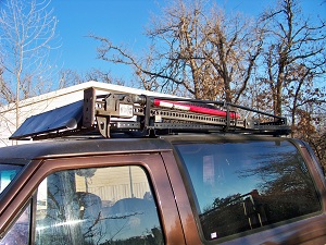

I made mine myself because I'm too cheap to buy what I really wanted, and mounted to the eddie bauer roof rack sliders. I don't know the full weight capacity, but I've hauled a spare tire regularly (until I made a rear bumper mounted swing rack) plus alot of camping gear.
I used perferated "L" channel steel, because I wanted to be able to position bungies anywhere I needed them.
