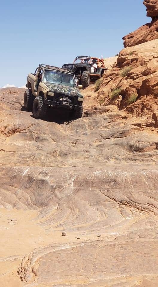

It is a legit roof rack....great for ladders too.
