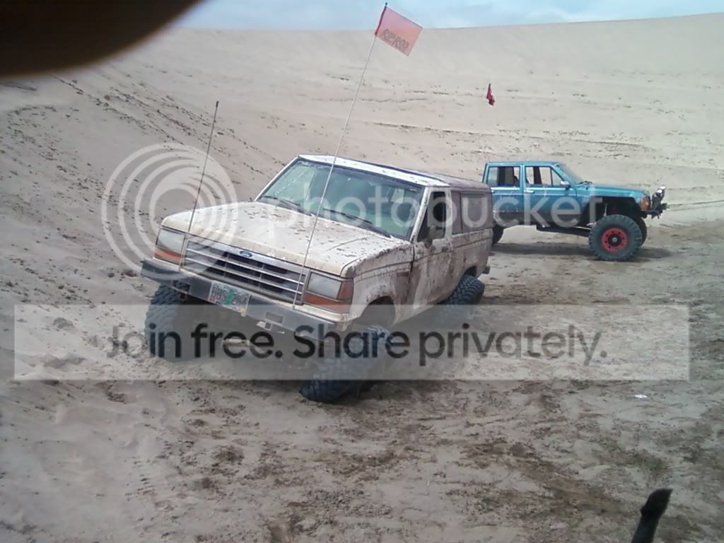

Rolled:
I pulled the roof panel, pounded the dents out, straightened out the ceiling panel, pulled both fenders and straightened them the best I could (not good, but not bad looking either...), pulled the interior door panels and straightened the doors, had a porta power to re square the cab so the door gaps looked reasonable, did the best I could with the bedsides (they still need work, but whatever...). It's still a work in progress but from a distance it looks fine other than the spots of grey primer covering cracks in the paint :) I apparently don't have current pictures of it on my photobucket...
Rolled:

That's at the landing spot of the roll... the roof is pretty screwed at that point... although since it was in sand it was pretty minor compared to how it could have been if it was on rocks or something more sturdy! I've got more pics of the repair process somewhere I'll put up this weekend...
If you get the headliner of your BII out of the way you'll have 100% more access to the roof panel than I had (Ranger's have a full double roof, I had to pull the panel to get anywhere...)
That's after I got home, a buddy laid across the seats and pushed the roof up to make it stick up instead of down...
There you can see the damage to the drivers side (the side it landed on)
cab needed to be squared up...
The rear spring mounts got a bit tweaked, this was my repair process :)
