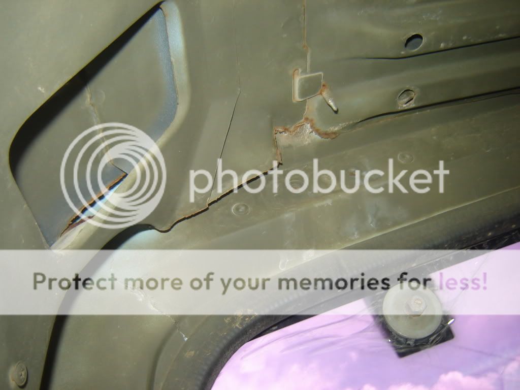

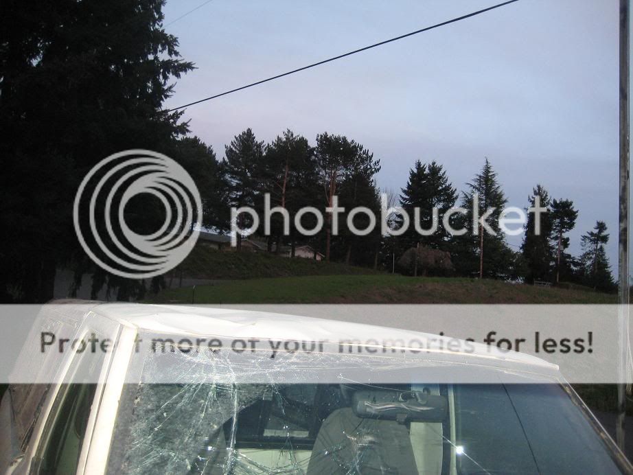

That's at the landing spot of the roll... the roof is pretty screwed at that point... although since it was in sand it was pretty minor compared to how it could have been if it was on rocks or something more sturdy! I've got more pics of the repair process somewhere I'll put up this weekend...

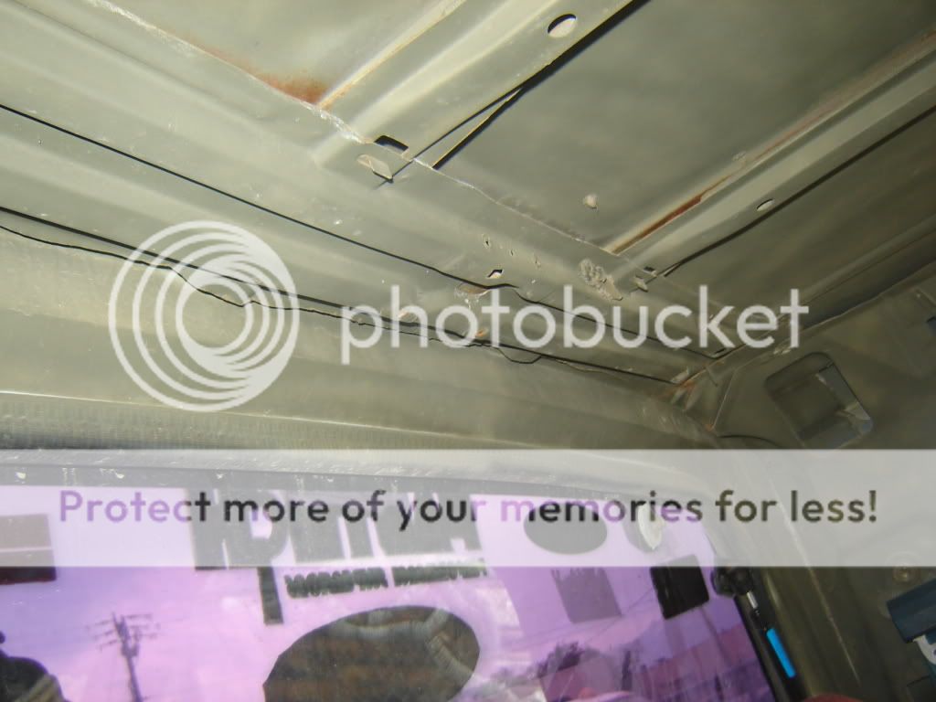

If you get the headliner of your BII out of the way you'll have 100% more access to the roof panel than I had (Ranger's have a full double roof, I had to pull the panel to get anywhere...)
That's after I got home, a buddy laid across the seats and pushed the roof up to make it stick up instead of down...

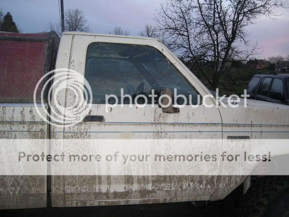

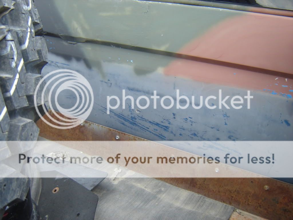

There you can see the damage to the drivers side (the side it landed on)
cab needed to be squared up...

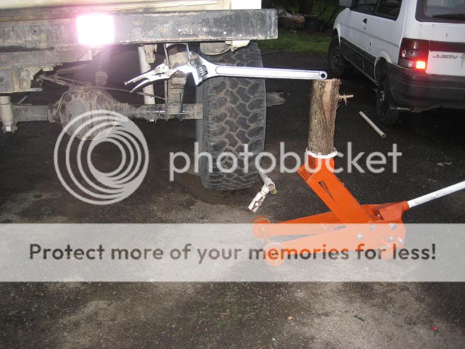

The rear spring mounts got a bit tweaked, this was my repair process :)

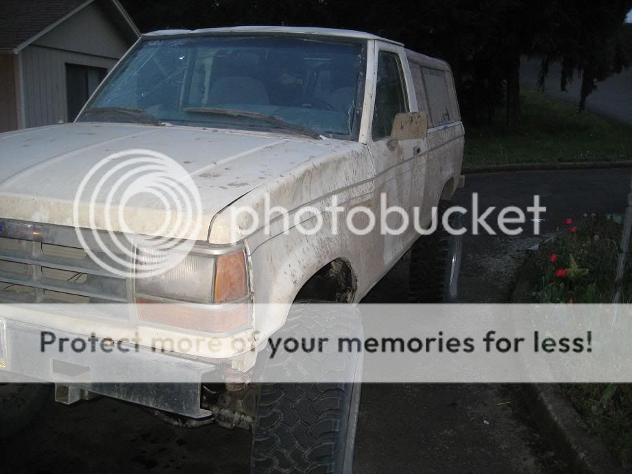

Is that even the same Bronco?
Sent from my VS910 4G using Tapatalk 2
Haha no, its a bronco 2 frame with a regular cab ranger and a bobbed bed put on it.
The impact from rolling it broke the frame.

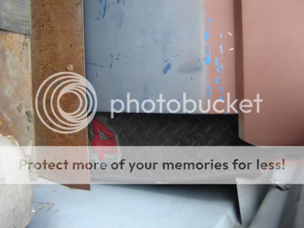

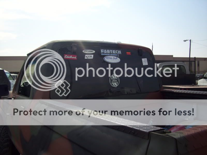

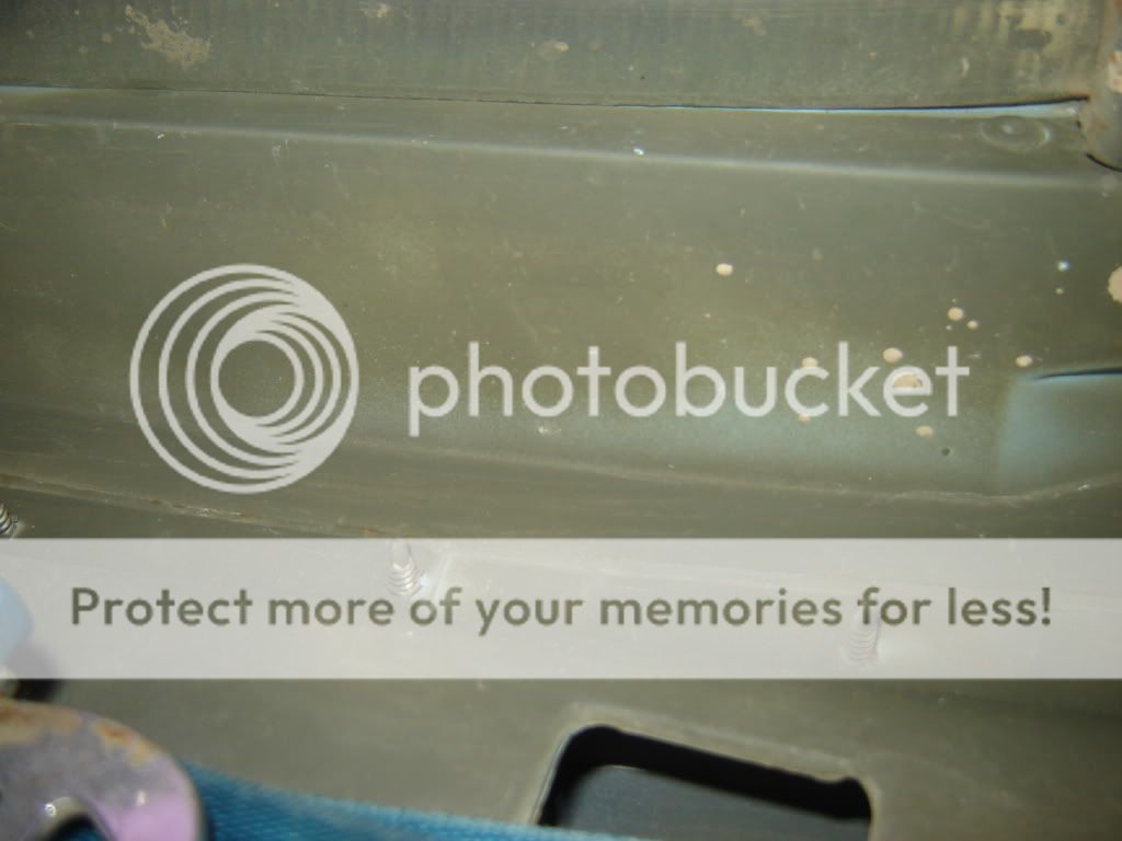

First I screwed the top and sides together with some self tapping screws. Then I cut the big piece of angle iron for the bottom and used nuts and bolts with washers on the inside. Then a whole bunch of fiberglass, then filler, then sand and paint. I never did anything about the bottom corners but some sheet metal could easily be used to seal it up down there. Then I used a spare hatch and cut the top part off to use as a tail gate. I was planning on doing a ranger tail gate and bed sides but I never got around to it. Instead I just slapped on some diamond plate bed rails and called it good.
Here are a couple more pics.
