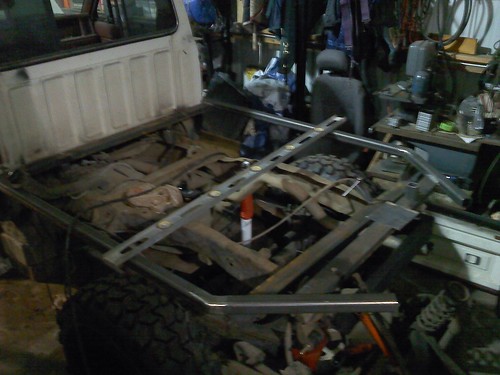

Made more progress on my flat bed, also i purchased a borg warner 1354 mechanical shift should be in tomorrow also my coil overs ship back to me tomorrow. everything is coming together.

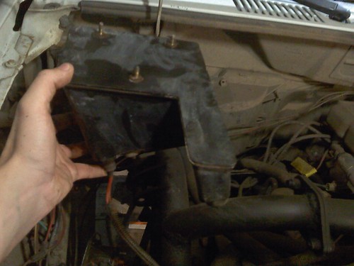

Can't really tell, but does it just have the one vacuum line running to it? It might be a vacuum reservoir, which stores vacuum suction so that when you are under wide open throttle or close to it, your vacuum operated accessories like your heater controls will still work.

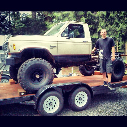

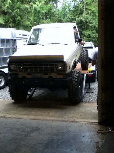

Got my truck out of the shop today and onto the trailer. Off to a buddies shop to get some breaklines ran.
Trying to just back it on... until the drive shaft separated... oops
All chained down ready to go.
What are the plans now?
Once break lines are done im going to get drive shafts made, make a rear bumper install tail lights and finish off the flat bed then work on breaking in my new gears once they get broken in im going to exo and wheel the shit out of it.

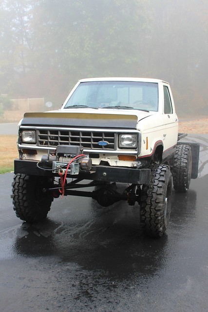

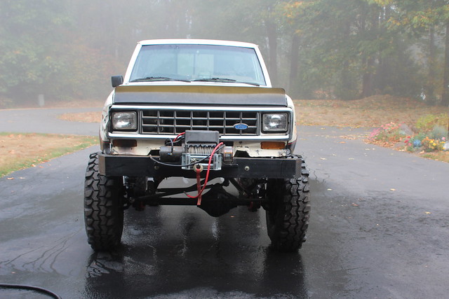

You need to at least gusset those radius arm drop brackets if you are going to leave them that low. They WILL break and leave you stranded, I would bet on it...
they are BDS drop brackets and they are gusseted on both sides so ill take that bet.
